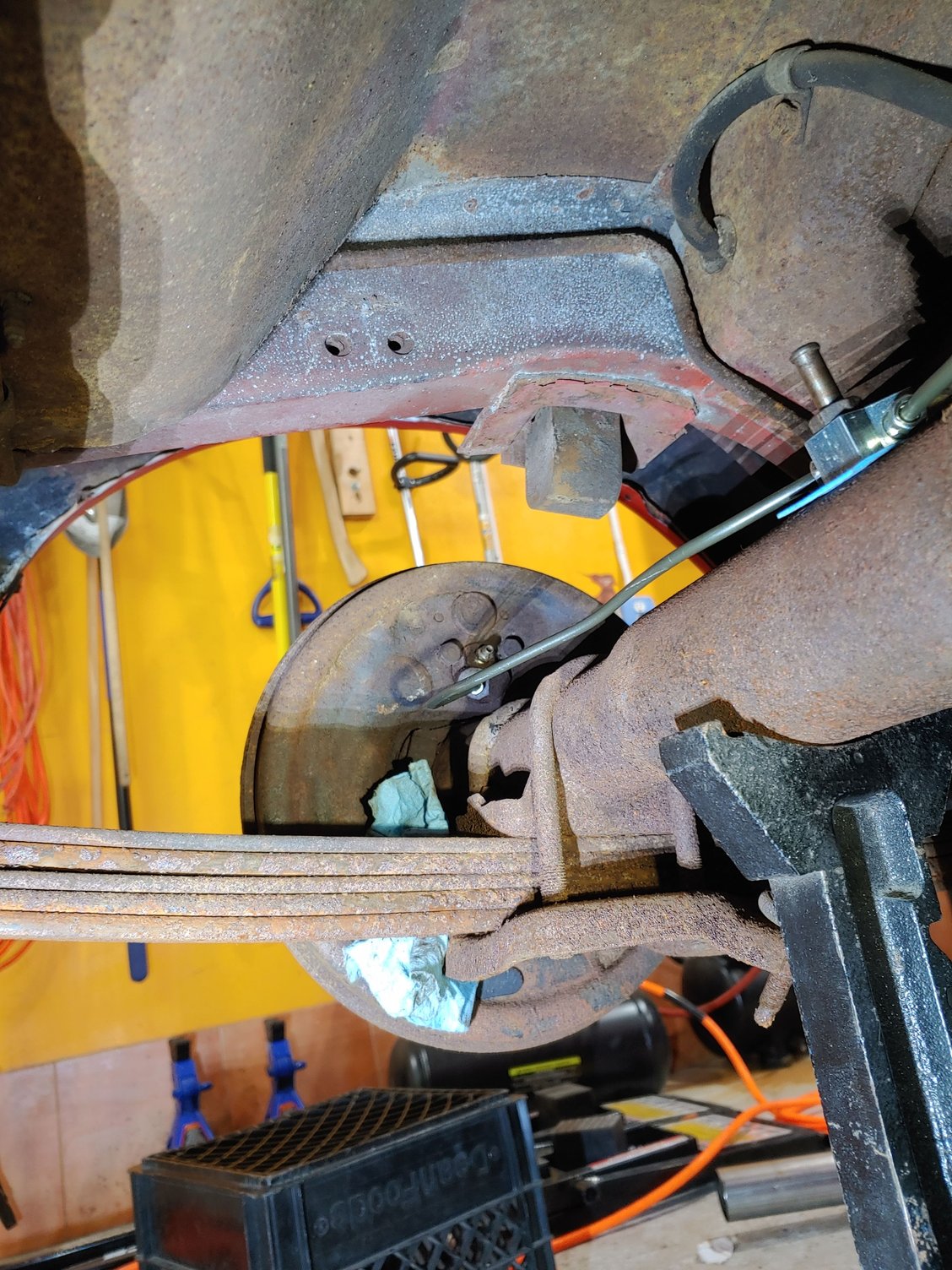

think the flare will seat well enough like this? I've already taken the time to bend the lines around the pumpkin etc (not for corvette)... need to wrap up this project so I can get the z in the garage and start taking it apart
it's not perfect but good enough for a 64 mustang!

It's hard to tell in the pic, but it looks like there might be a bit of dirt or something in the flare. But I'm pretty sure it'll seal, just looks a little rough around the edges

yeah I did some test flares with the grease they provided, then used some wheel bearing grease, same results all around...
I cleaned up the flares I did and they looked as good as the stock ones...
I went with what I did, and we'll find out if it worked next week... thanks for the double flare tip, it's definitely better than the crap tool I had..
thanks again for all the input, even if it was for a stang

I think that's just the green poly coating flaking off the tube. I've used a lot of that tube in the past, nothing I haven't seem before with that type of line.
