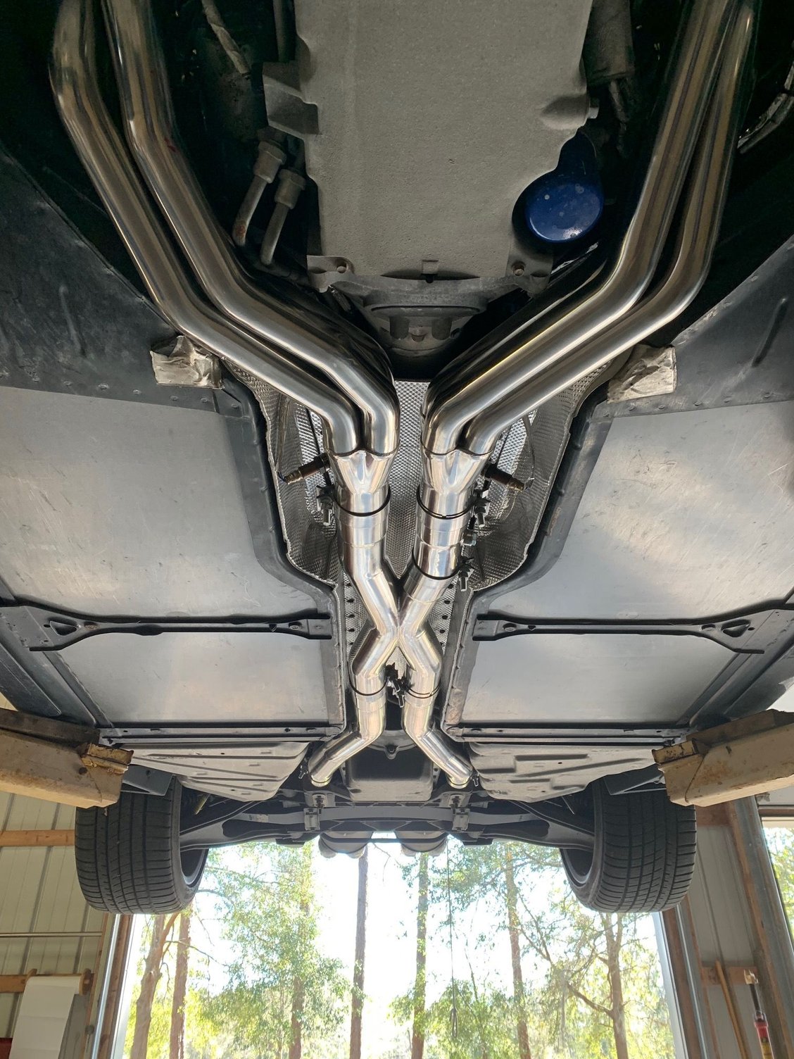

Just completed the install of Speed Engineering header and mid-pipe on 2013 Base coupe. Also added DEI tunnel insulation while the exhaust system was out (my console gets crazy hot). Sound is awesome and the NPP calms it down just enough to be perfect. Dramatic increase in level and tone with NPP open. This is a daily street driven car so don't want it too loud. Reports of the crappiness of the clamping system on this setup are all totally correct. So I have ordered band style clamps to replace the ones provided by SE. Also ordered 31 inch o2 extensions...the 24 inch extensions purchased with the system are too short in my opinion and will burn up pretty quick. 31 inch tuck away nicely. Have extra 24" extensions if somebody needs them.

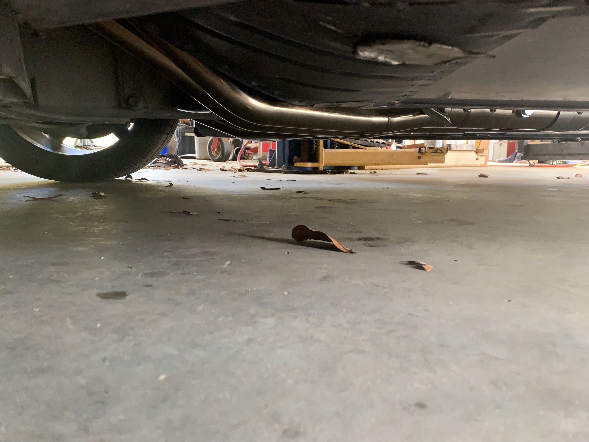

Would you mind posting a side picture to show how low they hang relative to the ground?
Thanks.

This is the only photo I have right now, I will say they don't hang down as low as,others I've seen.

I will get a photo up first part of next week. Gotta hit the road outta town.... from memory mine do not hang quite so low.

Maybe the angle or lighting but my headers do not seem to hang quite so low.
