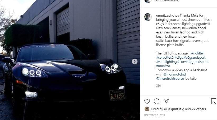

Originally Posted by basicblur
I'm going to send my lights to Umnitza to have the lenses replaced - since they're going to have them apart, not that much more to get the Orion Angel Eyes (6) installed - plan on going with all 6 rings in white.
While I've got the lights apart, any recommendations AFA bulb upgrades?
Haven't driven enough at night to see how the lights look, but I did check them out in the garage the other night.
The low beams have a nice, white light to them - the high beams seem to have a yellowish tint to them.
Don't want to go crazy, as some lights I see are too bright.
I'll try to take it out over the next few nights to see exactly how good / bad the OEM lights are.
Looks to me like the mods I'm talking about will run about half the cost of the Morimoto (I'm assuming you're talking about the C7 style headlights?).
The Morimoto headlights are a little busy for my tastes, especially the turn signals.
I also kinda like the blue behind the lenses to match the color of the car.
Black surrounds look OK on some colors / models, but on the blue convertible I think staying with the color matched surrounds looks better.
I was going to live with the mismatched lenses but since the body shop is going to be working on it, I figured I'd go ahead and get the left lens repaired - the body / headlight gasket is also ripped and not inserted in the groove very well - might as well take care of that also.
Since I'm going thru all that hassle, figured I'd go ahead & get the LED headlight rings.
Much more than I intended to do, but I'm balancing time / money / hassle.
Hopefully you've already called and spoken to one of our reps on this.
I would recommend 3 things to change while the lights are apart:
Osram CBB D1S bulbs for the low beams. Phenomenal output, easy to plug and play, great reliability, and they look great.
Luxen LED high beams (the single brightest and best value high output LED bulb you can put in the high beams, nothing else on the market comes close for $ per output)
Luxen LED turn signals - pure white for DRL operation, amber for signal.
Thanks for the info - taking notes - I like the looks of the pix you posted.

From: Sausalito CA
Yes, I agree attractive photo in post 5.
But plug and play?
Does the clear cover need to be removed/ separated to install a like setup?
Old Mar 22, 2020 | 09:27 PM
info@umnitza.com's Avatar
0info@umnitza.com
Supporting Vendor
Joined: Sep 2016
Posts: 3,937
Likes: 383
From: NorCal CA 877 486 6489
For the turn signals, no the covers don't need to be removed same for the high beams.
But the angel eyes require new clear covers.

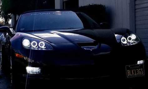

https://www.instagram.com/p/B51TEcAhNZY/
Any way you can post those pix with the above setup in here so I can copy / save / print? (Post #5)
I'm not on Instagram, so I'm having fits trying to save the Instagram linked pix you posted.
Thanks

Generally if you can screen shot the instagram photos with your phone or PC, you can save the images.
Did that for you and now attached the files.
Got a question (or two):
1. In the picture above, what turns on the 4 Angel Eyes - do they come on with the DRL (outer light)?
3. In pictures I've seen of the 6 Angel Eye setup where all 6 are on BUT the stock amber DRL is not, what turns the Angel Eyes on?
Just trying to figure out the operation of the 4 & 6 Angel Eye setups - taking notes & taking pix for planned upgrade of my stock lights.
Think I like the 4 Angel Eye setup as above best, but I keep looking at the 6 Angel Eye setup...
Old May 7, 2020 | 06:35 PM
0info@umnitza.com
Supporting Vendor
Joined: Sep 2016
Posts: 3,937
Likes: 383
1) parking lights, but we could wire it to the DRL and enable them to turn on with the ignition if the customer chooses
2) You are referring to this video - 5:36 mark onward
The Stock DRL was still allowed to operate, just a lower voltage bulb was used.
