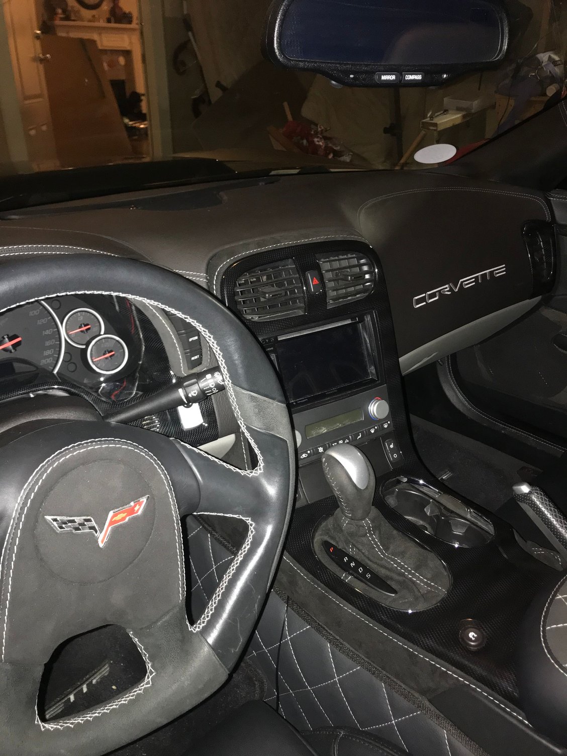

Old Mar 15, 2020 | 03:35 PM
myredhead1's Avatar
myredhead1
Joined: Dec 2014
Posts: 2,257
Likes: 433
From: Bossier City Louisiana
Dough boy wheel done up
A6 shifter?

Originally Posted by 05 Wreck
A6 shifter?
Yes sir
Yes sir
What is the back story on this? Curious. (Oops I stole the op's thread....wait that's me.)

Simply did not like the look of the A4 shifter. Bought this one used online and had vette candy do the boot and handle in suede. I don’t power shift the car so the lower settings, under the “D” do not matter to me, lol. Very easy swap. If I remember correctly, I paid $170 shipped
