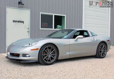

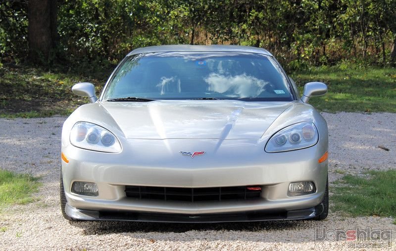

I have a narrow body C6, base model, LS2 car which we bought bone stock earlier this year (have owned three C6s), shown below. We have added the Z51 brakes and track pads to it, some 19x10" wheels and 275/35/19 Hankook RS-4 tires to it, plus a seat. Otherwise stock. Due to the typical "ice mode" issues these cars can see, plus some added rear brake locking particular to this car/package I have seen on track (plus another driver), we're swapping the ABS from GM to Ford (bracket and Ford ABS brick shown below). But the first step is removing the GM ABS...

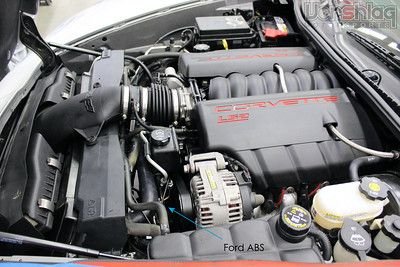

We have done this Ford ABS swap on a C5 (the main owner at HPR's car, below) and it worked VERY well (best braking Corvette I've ever driven, autocross or track), but was not an easy swap - since we had to add Ford speed sensors + reluctor rings to that car, on top of the plumbing and wiring changes.
Every time I drive this C5 again I am reminded how good these cars can stop, so we're pushing forward with this same ABS swap on our C6.

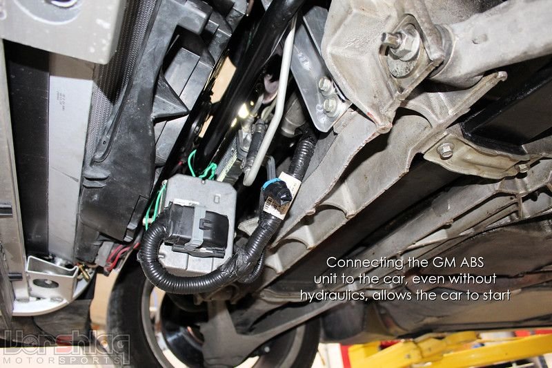

But as some of you have noted, the C6 won't even start (using the factory ECM + body control modules) with the factory ABS brick unplugged...
One of the first steps in our Ford ABS upgrade was to remove the GM ABS unit. We did that and... the engine wouldn't start. Just gives a blank screen. We looked around, found this thread, and plugged the brick back in and it started. But that's not a long term fix.

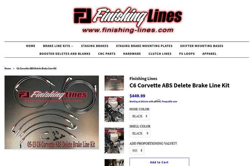

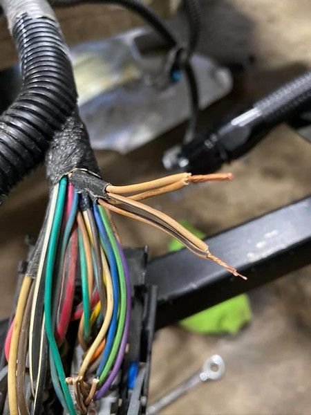

We found this ABS hydraulic delete kit from "Finishing Lines" and figured they would know the exact wiring fix (that some here alluded to). After emailing them they replied with some instructions and this pic...

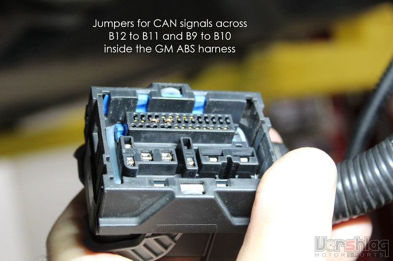

Looking at the wiring harness for the C6, we noted the 4 CAN wires... two CAN high and two CAN low. You can cut the harness and just twist them together like they do.
Instead, since we want to re-use the power from the GM ABS harness and didn't want to hack up anything needlessly (we want to make this ABS swap reversible if something goes wacky), we made jumpers. The C6 ABS connector layout above shows where they go.

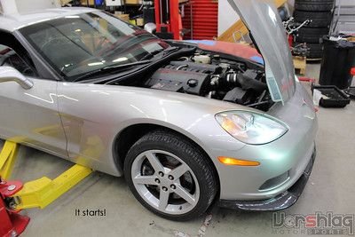

The jumpers are simple copper solid wire shown above. We did that, and with the GM ABS removed the engine fired right up.
So our C6 has no functioning ABS at the moment, and the GM ABS brick removed, which is one step forward for our ABS swap. Just drove the car and it locks the rear tires painfully easy, but that just verified that the stock front-to-rear brake balance was as bad as I had thought. Driving this car on track (4 tests, various brakes / pads / tires) has been a bit of a chore, and it always wants to lock the tires (except when it had 245/275 OEM sizes with low grip 300 treadware and parts store brake pads).
