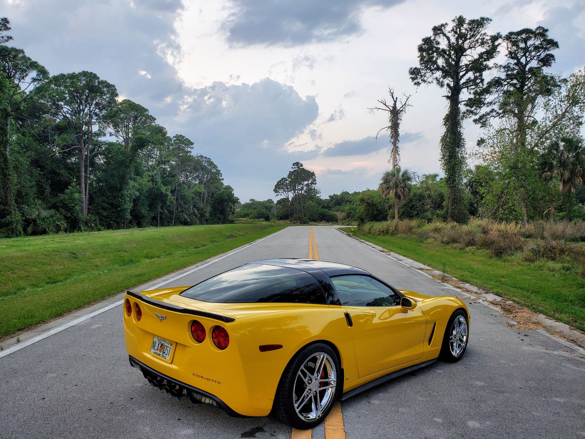

I'm trying to figure out the appropriate rake for the car after lowering. I found the service manual where it shows the C6 wanting 0.9" rake from front to back using the fenders. The control arm measuring way seems like a major pain so Im avoiding that. I'm currently at:
Front
Fender. 25.375"
Jack Point. 4.5"
Rear
Fender 27.25"
Jack Point 5.25"
Difference
Fender 1.9"
Jack Point .75"
Now I dont think the fender method is that truly accurate but I am showing about double the recommended rake via fender measurement. The car sits nice but after taking pics I think the rear could be dropped a little more but not a complete inch.
I lowered the car with the OEM bolts. Front is uncut and on the rear I cut off 1 bushing. Should I just cut off the last metal bushing on the rear so it's just the metal bolt and then the final layer of rubber or is this rake ok? I drive the car aggressively and want it to handle well lowered still. Corner balancing is not in the budget.

Angled shots are nice but full on side shots would give us a better idea of how it looks.

The first pic shows the gap pretty well if you zoom in on the front and rear wheel wells. I'm more so looking at measurement numbers to shoot for based off of the jack point locations since I feel that is pretty accurate.

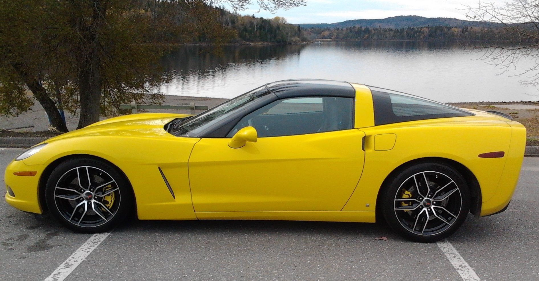

here is my car on stock bolts, without cutting any ribs. It took about a month before it selttled to it's final position. I installed Bilstein B8 shocks as well
Hmmmm maybe I'll give it more time then. I just installed the b8 shocks and cut the rear bushings the night before. Your rear sits just a tiny bit higher than the front but my rear is cut one bushing so that could be perfect.
