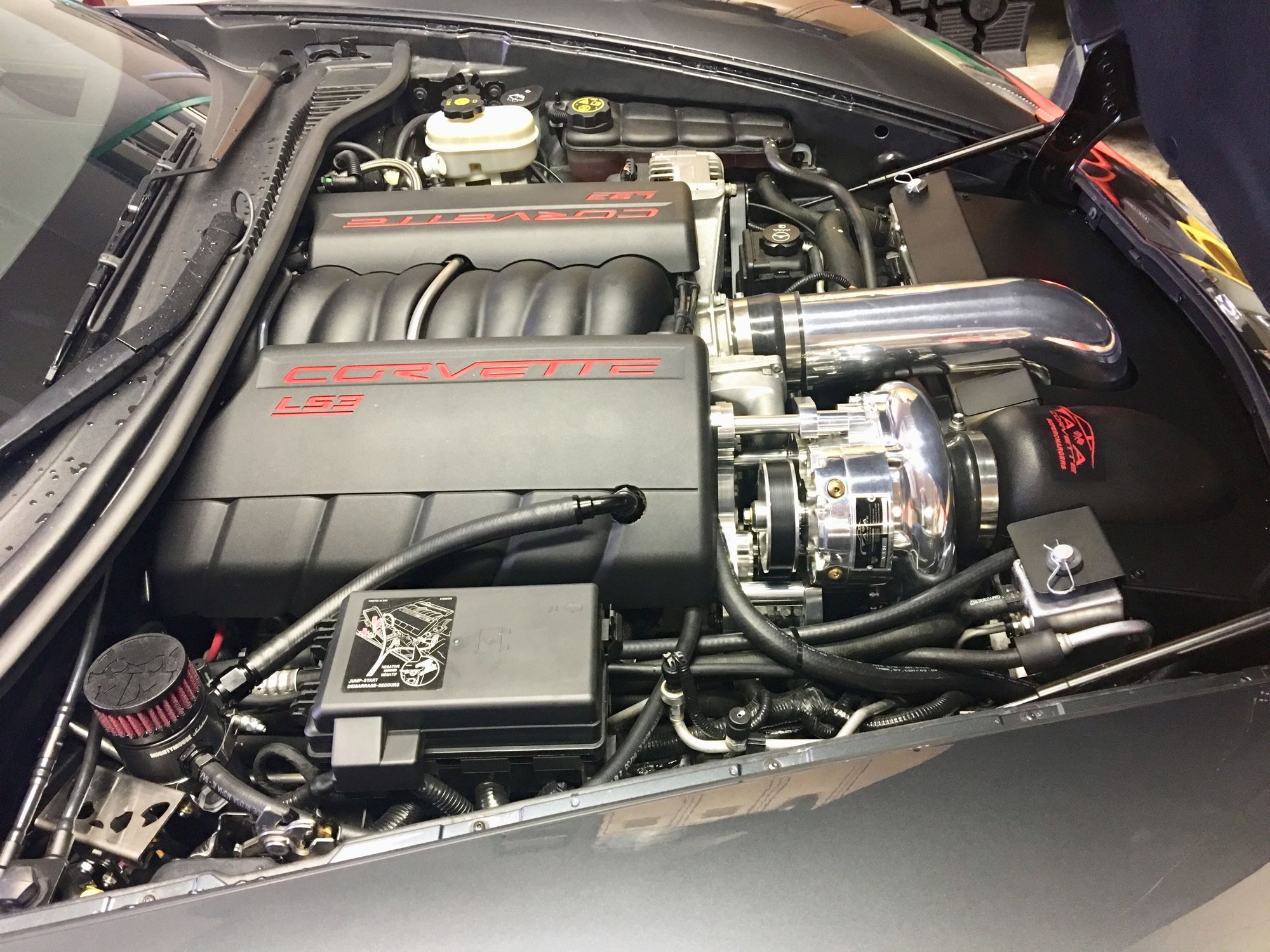

As mentioned, the MM Wild kit is set up for boosted LS3 with a dry sump. You may be able to run a M.M. kit with different set up configuration for your intended application. Here’s mine
