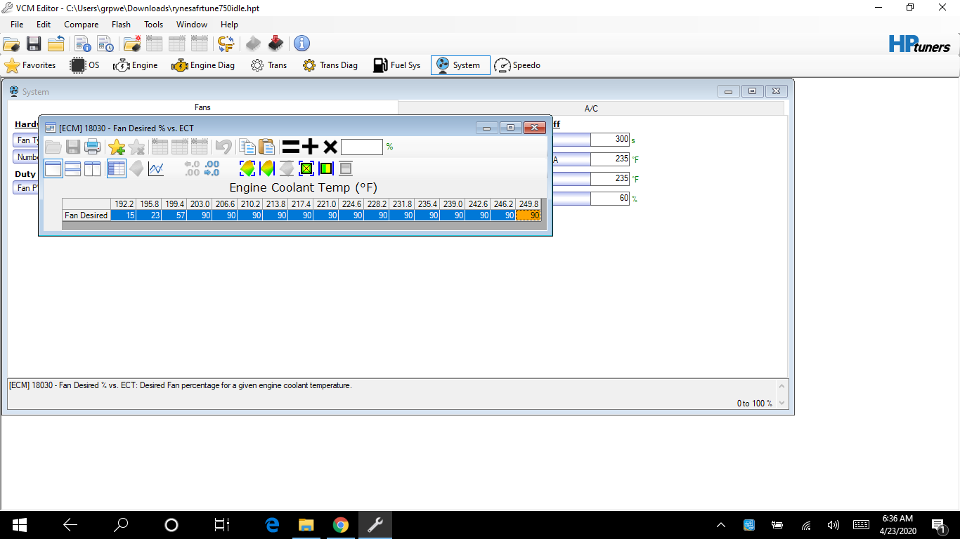

The fan doesn't know what speed you are diving! My 05 stock settings were set to 0@194* and like 5% @ 203* Cant remember the exactly.... I can look it up if you need it.
My tuner with HPT was unable to change the fan speeds, I am able to with my HPT. I set the lowest turn on point (194) to 15% and put in a 165 stat. It now runs anywhere from 173 to 200 on hot days in traffic
BTW the fan comes on whenever the A/C is on

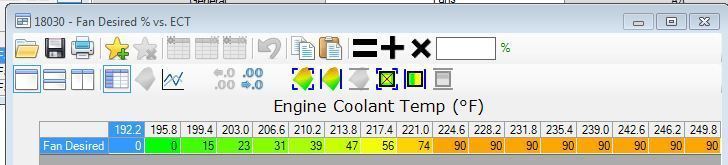

[QUOTE=grpweld;1601378082]If you don't change to a lower# thermostat & you increase fan % at lower coolants temps the fan can be over worked & fail!
T[/QUOT E]
I know, i wont change it too much. Add %5 percent or 10 and in lower degrees. Is it harmfull anyway?
For example, 192.2-%20,195.8 %30.....
This is the stock i think..
