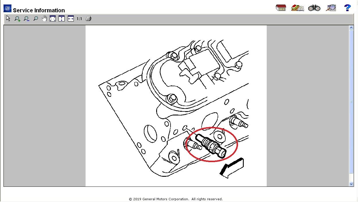

Temp sensor is in the driver's side head:
Why do you think the gauge is wrong and the car is not actually running hot?
