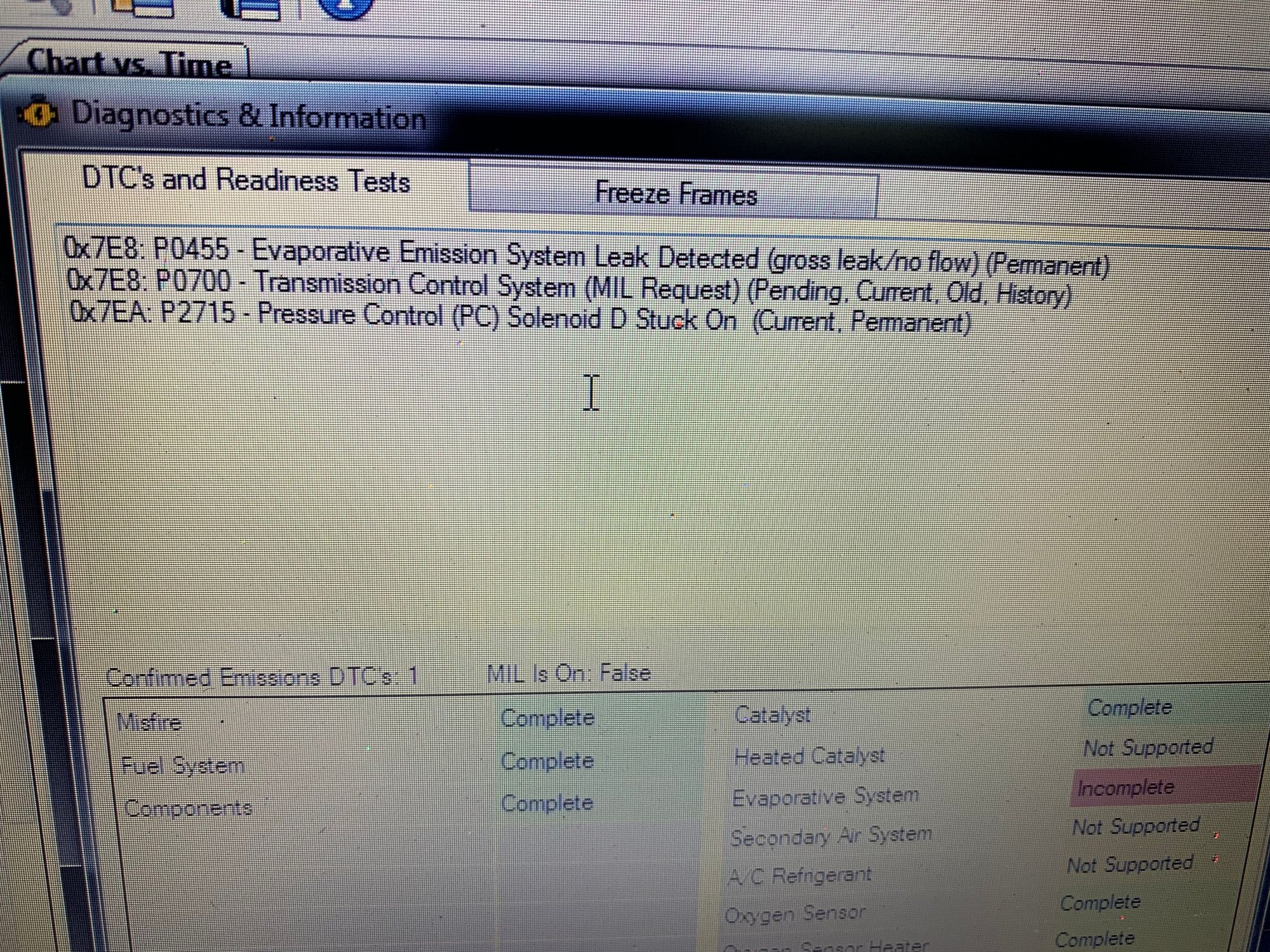

Hello Raffman I’m unfortunately having the exact same problem as described.
My car too is a ‘11 grand sport but sense my LS3 windowed the block went with an LS7
Here’s a quick run down of what I been true;
Out of nowhere the trany started to malfunction
paddle shifter down denied but up will work thought not for 5th or 6th some times at times for 5th but not 6 and simultaneous conflicting actions were taking place like if I got on it hard say at 80% throttle it may out of nowhere go to neutral then engage again it was insecure at best to get on it and it did too start of in second or third and even in fourth some times at the stop light so my tuner in no way could take control of it or tune it as he use to it just won’t do as commanded to like before so we thought the tcm maybe bad I changed it and reprogrammed it with a known good tune we had in it before, it did exactly the same as with the original tcm nothing changed one time on the way home I got on it and then lost going into 4th will just go to neutral I decided to take down the trany and go true it this was a fully build trany by the way no short cuts including billet intermediate shaft with power glide clutch packs upon disassembly I found the planetary broken otherwise the transmission was like new and totally clean inside.
So this engine makes 606 whp I decided to get a billet rear cluster to take out the weak link while in there “BUT” also got me new upper and lower valve bodies and another new tcm to be flashed with a fresh original tune and modify that to eliminate any possible corrupt file, with the trany back together guess what same problems persists still driving the tuner crazy denying down shifting as before and like you I went to a body to check any trouble codes with a expensive powerful Snap-On diagnosis tool there were no dash check engine lights or any complaints just a couple of lost tcm/cluster communication and even/tcm/ecm communication.
So my next step will be to look into why I’m getting check oil level I already changed the oil pan level sensor still not able to read oil level ones I get this fixed my hope is the lack of communication will go away and all be back to normal will find out Monday.

I talk to my tuner he said you likely have a hand held programmer or a can tune in there
He said the way he programed the maf I wouldn’t have that problem he also found the pressure control solenoid d stock open in the valve body.
