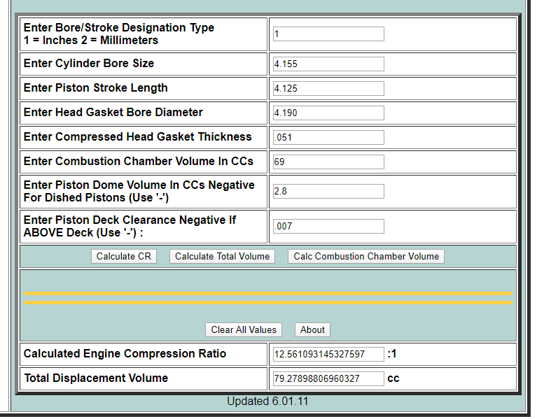

I use http://www.csgnetwork.com/compcalc.html .
You can make assumptions until you have known values. For piston deck clearance you can use the stock below deck of .007. If you surface the block this will likely change depending on the zero deck of your pistons, but can give you an approx.
Also, when looking into this for you I've realized I've been entering my domed pistons into this calculator as -2.8 but the negative is for dished pistons. So my CR is about .5 higher than I thought, lol. Oops.
