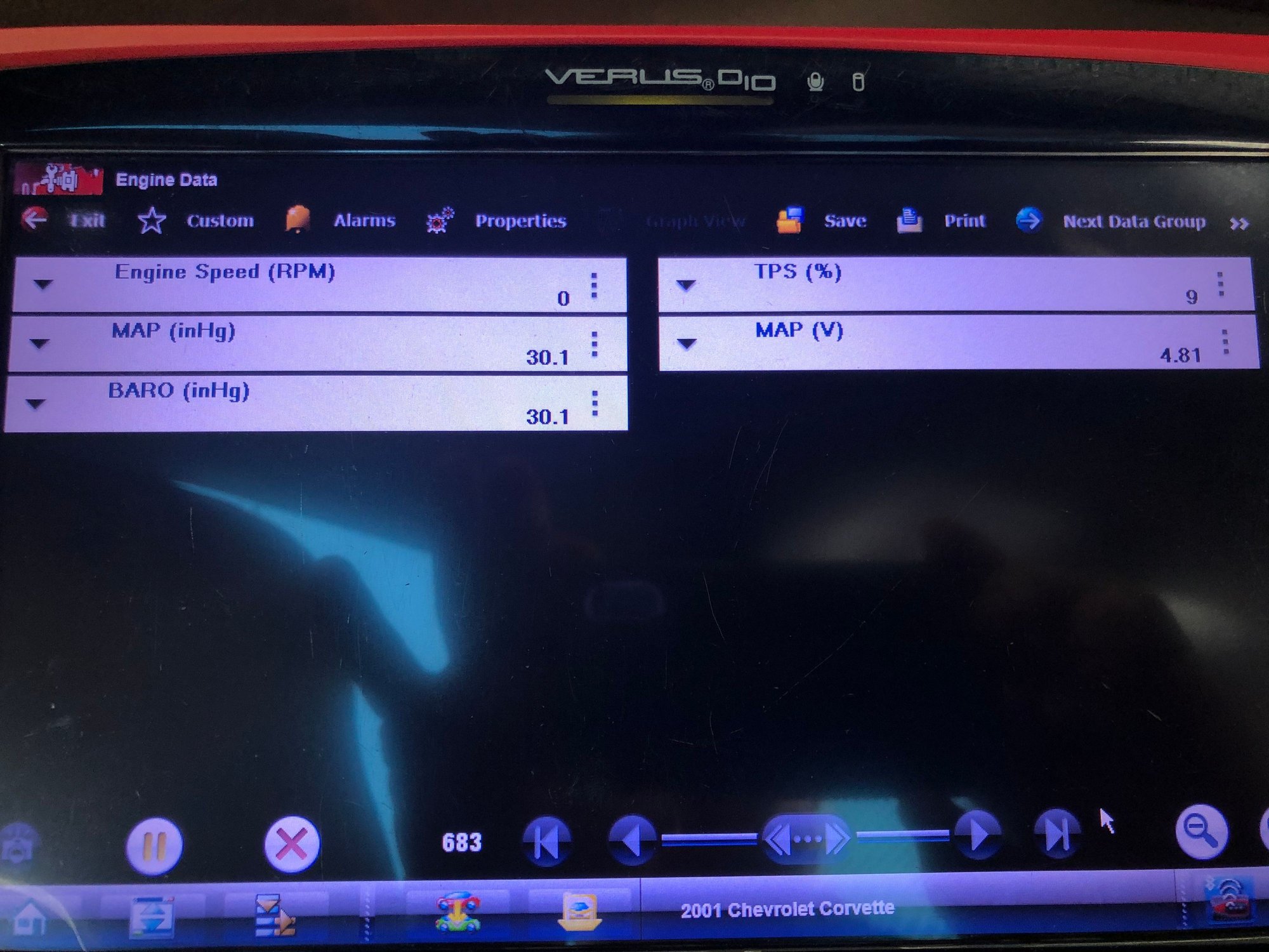

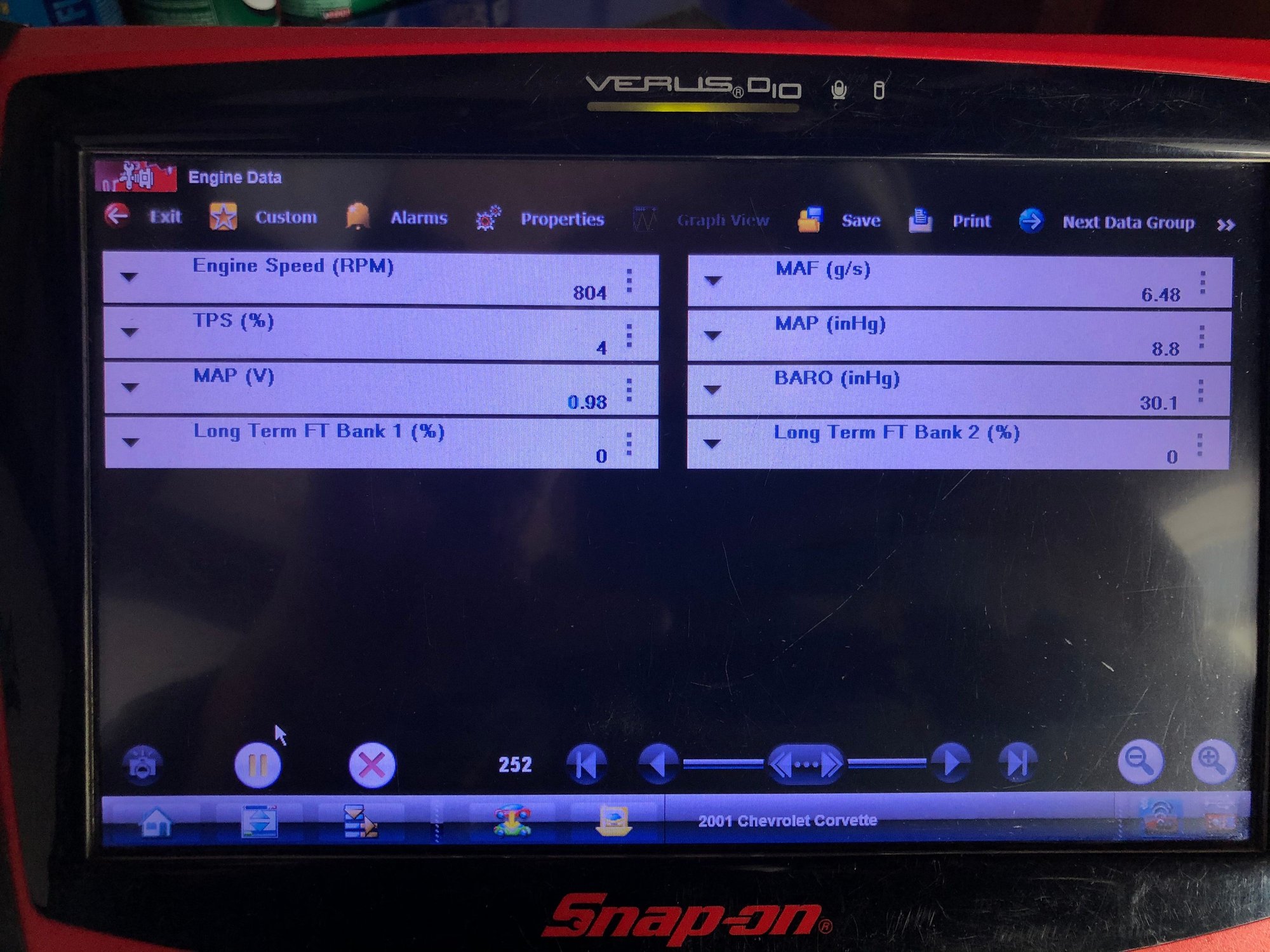

WOW !!!...almost 26% at KOEO ???...6-10% is good...I took 2 snapshots of my ‘01 with KOEO (TPS at 9%) and idle...4%...try cleaning your throttle body and especially around the bore where the plate sits...I would also make sure the throttle plate is not binding !!...also what is your altitude where you live ??...I’m basically sea level so my Baro is around 30.1 inHg.
