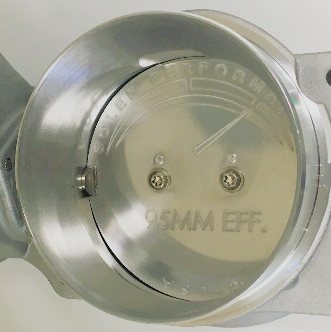

Originally Posted by xtenzzive
Oh my those look so nice! thanks so much
Thanks. Please check back with us in a couple of weeks. We'll have them in stock already ported from the original 90mm to 95mm at WOT plus all the other features that make them respond faster at partial throttle. These are one of the most expensive stock TB's and we'll offer them brand new at about the same price, including performance modifications. Add our C6 controller and you'll be riding a different car.
Awesome news mike. Did you say new will be available? That's excellent to hear. As soon as they are ready I'm in for one and a controller.
Thanks! Yes, they'll be new, and they'll have hall effect sensors (contactless). The original sensors on these are of the potentiometer type, which has spring-loaded contacts that wear, at some point electrical contact becomes weak (high contact resistance) or intermittent, then the ECM loses track of the throttle position and enters limp mode. This is the main failure mode of these parts.
