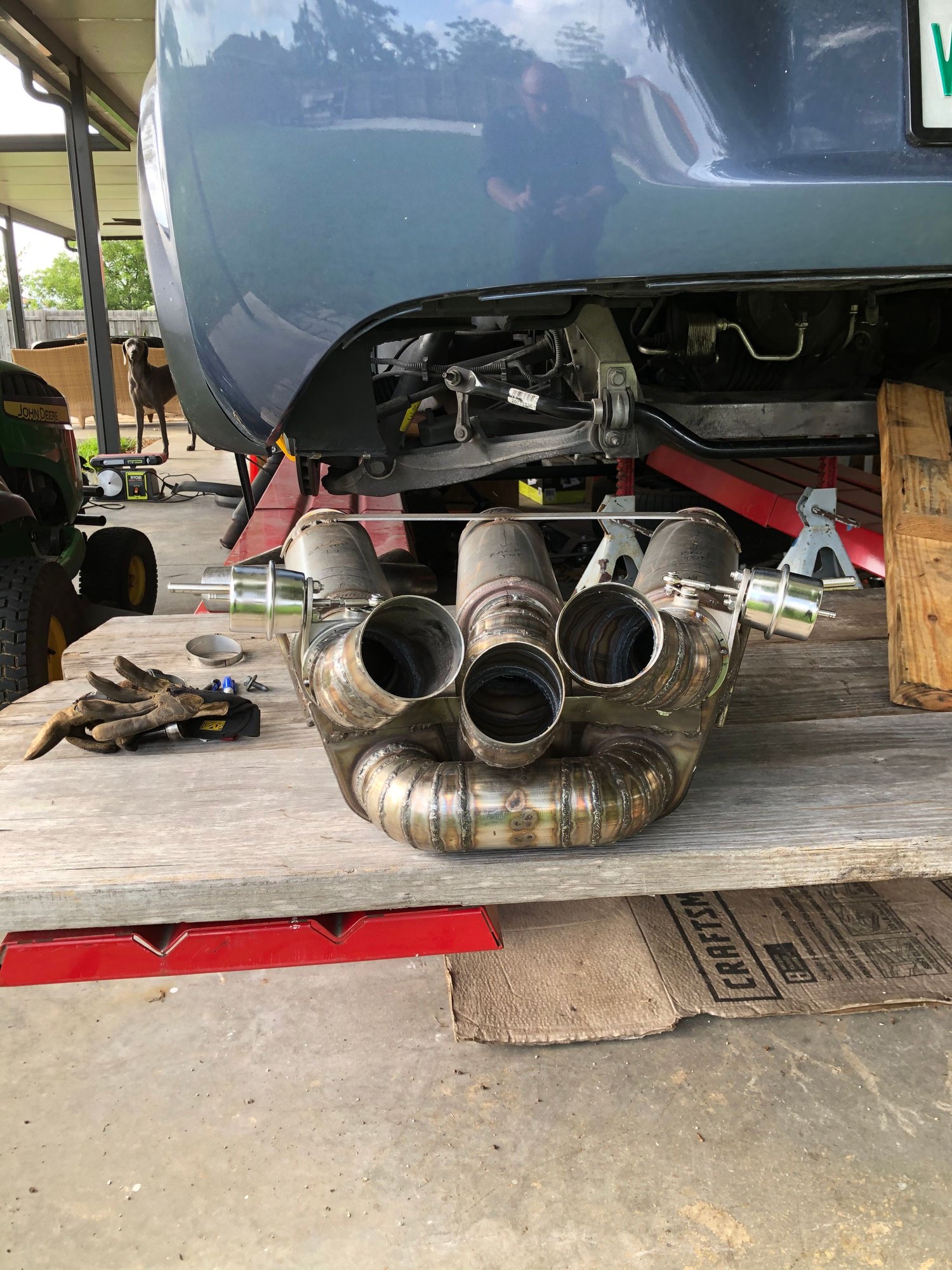

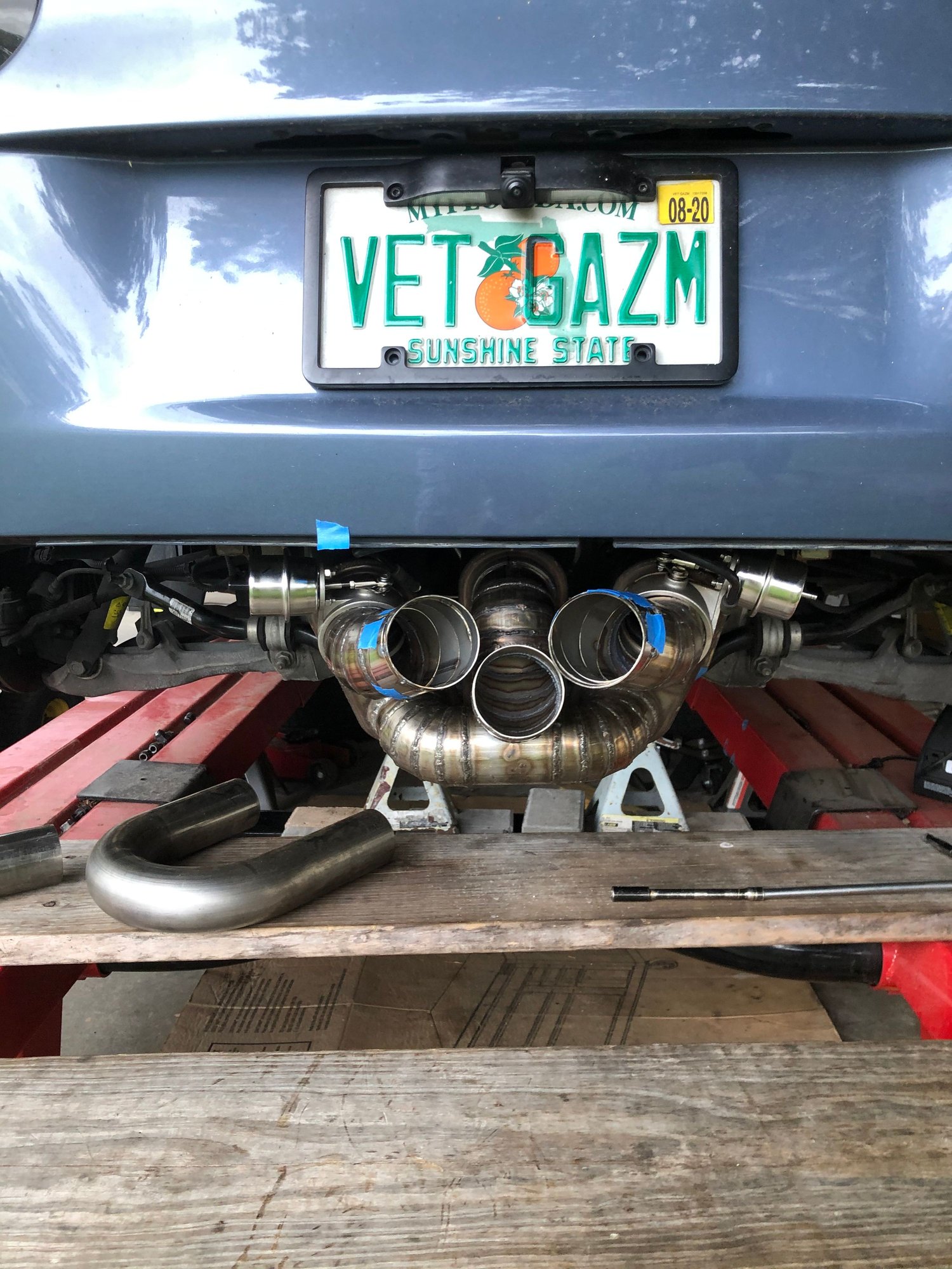

Our you can just make your own... Nobody makes a Bi-mode for the center out rear diffuser... so I'm making my own... I could have done this less complected however this was my first go at it and wanted it to have an aggressive sound at WOT yet super quite when cruising the highway.... I drive my vette way to much, the loud pipes I had on it for the past 8 years just had to go....
One pie cut at a time... it’s all lot more work than it looks...
Not going to lie, its a lot of work... but I think it will be worth it in the end. I really hope to have it fired up this weekend.
