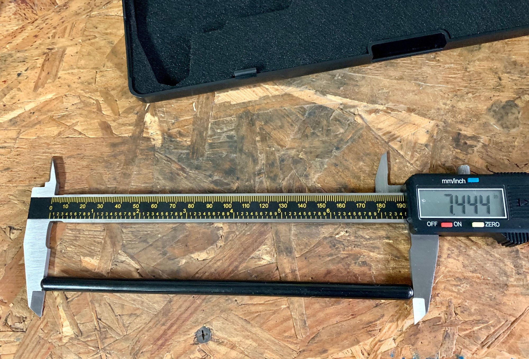

Ok found digital calipers...
-all zero lash measurements taken on base circle
EOIC
-TSP PR 7.400 on cylinders #1,5,2,6 both intake and exhaust I get 3/4 turn to 22 lb ft torque.
-PR length ck tool taped and set at 12.5 turns equals 7.425 on cylinders #1,5,2,6 both intake and exhaust I get 7/8 turn to 22 lb ft torque.
TDC
-cylinder #1 same results as above.
I will note that on cylinder #1 I did feel some slight lifter plunger preload and was careful.
I’m pretty sure at this point I should use 7.425 PR.
Thoughts are welcomed..
thanks!
Here is a few pics of PR using calipers and of course they are not exact.
You know, that makes sense ..... As I stated before, these aftermarket cams have a slightly smaller base circle than the OEM cam, so if anything, would require a slightly longer pushrod ... the next size longer than the 7.40" stock rod would be a 7.425"
Either way ... a 7.40" or a 7.425" rod would be fine.
Good luck with your project

Finally got 7.425 PRs from TSP and installed them last night. From 0 lash base circle I got 1 1/8 turns on all rocker bolts when torqued to 22 lb. ft.
Measured the 7.425 PRs with calipers and of course they came out a little longer. I know I’m splitting hairs. Just wanting this to be done correctly.

[QUOTE=rc51racer;1601672123]Finally got 7.425 PRs from TSP and installed them last night. From 0 lash base circle I got 1 1/8 turns on all rocker bolts when torqued to 22 lb. ft.
That’s probably as close to perfect as you can get. Don’t worry so much about what they actually measure out to, as long as you get the right amount of preload on the lifter.
