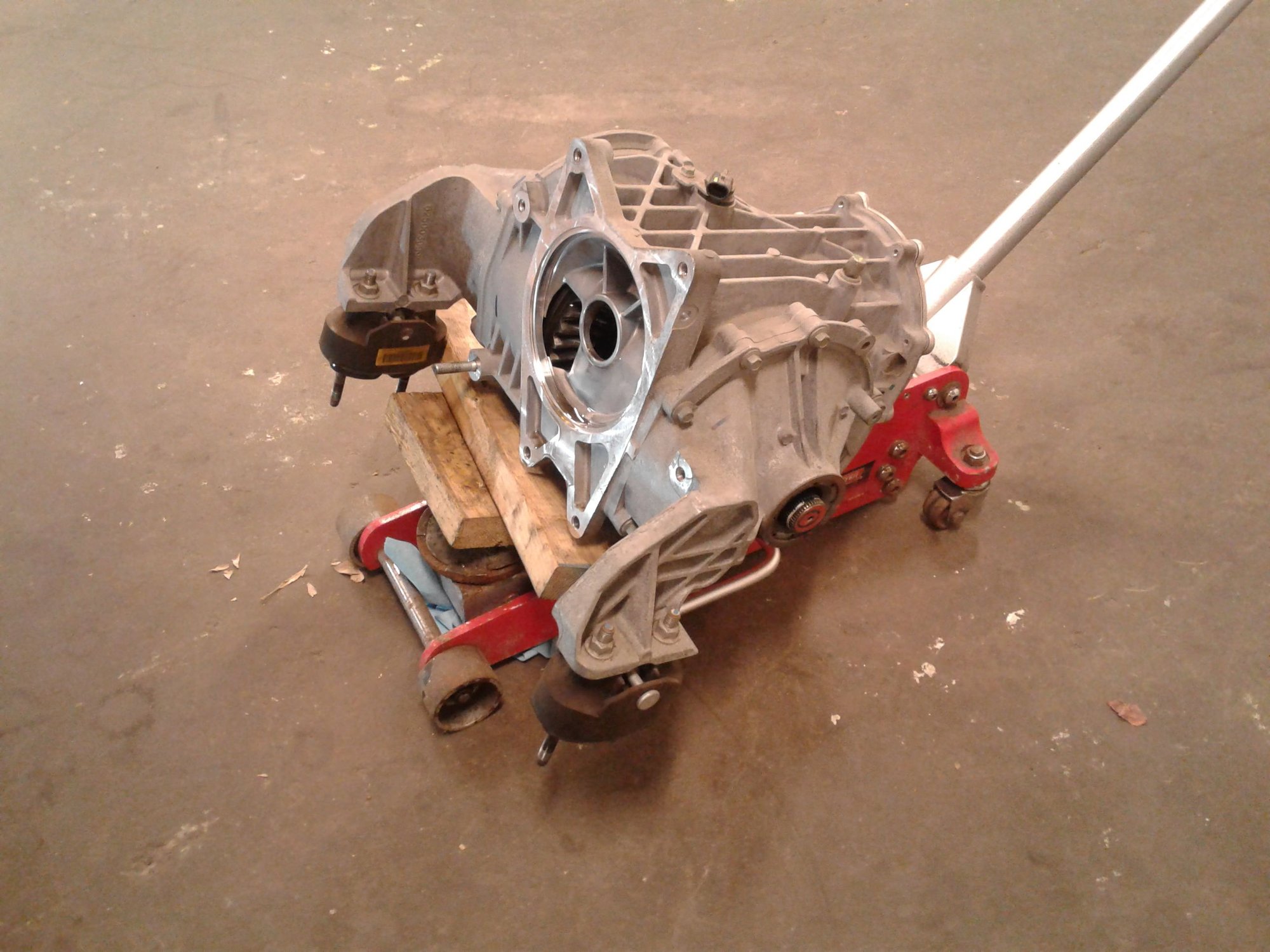

I can't say for sure about the Z cars, since they are cooled, but the base cars definitely do. Here's a pic of mine out of my car. You can see the vent on the top above the driver side axle.

Yes, I always thought the diff case was vented at the top as post # 2 tell us.
But, accessing that vent while the diff is still in plcae may be impossible.
If the OP can access the vent, and any tricks or what was found, please let us know how.

07 z top of diff...
