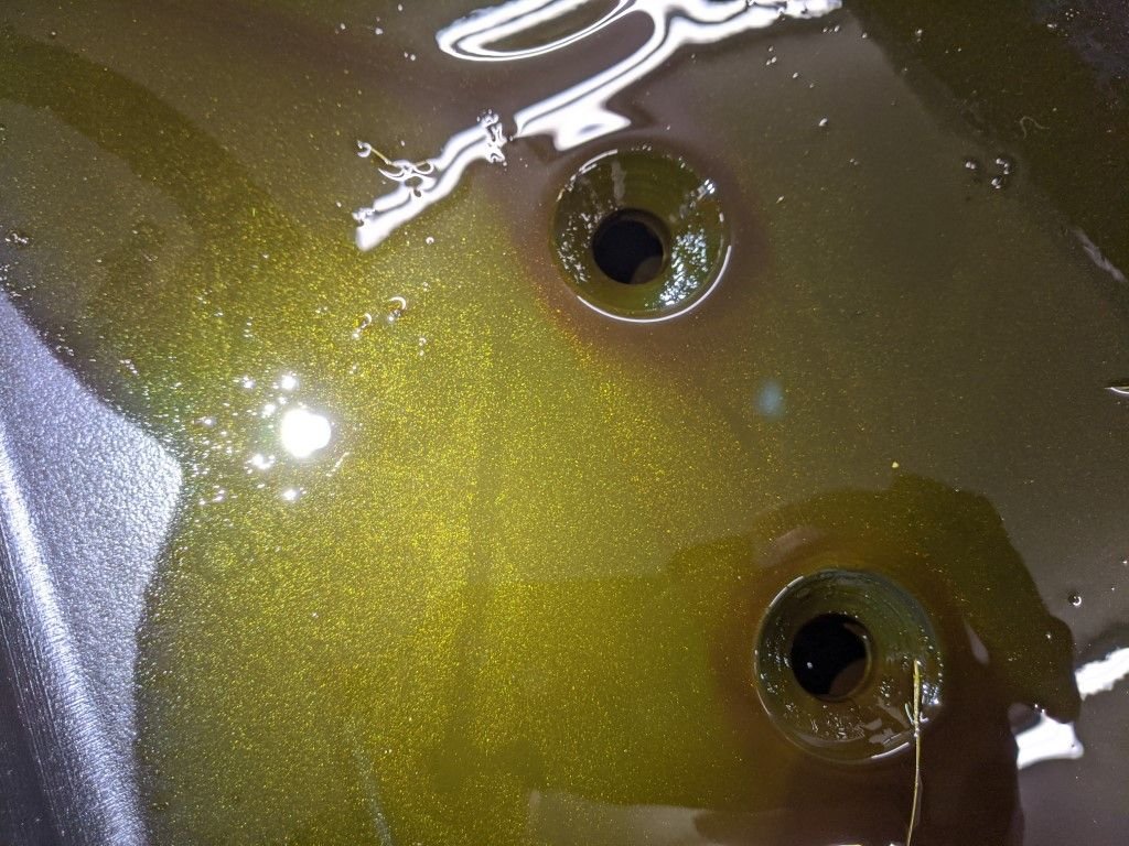

I'm looking for some advice on the rebuild of my LS3. It has 51k miles, the last few thousand miles with a TSP stage 2 cam. Changing the oil this spring, it seemed as though someone pulled a prank on me by dumping glitter into my oil (disregard large specs in oil - just a dirty oil pan).
I thought it may have been due some horrible wear to the CHE bronze trunion bearings, but they look good to me.

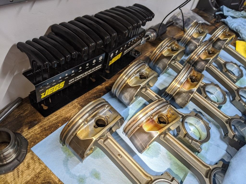

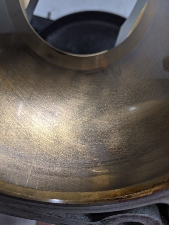

Either way, I now have to decide how far to go with this rebuild. The bores look pretty good, and again to the best of my ability, seem to be well within tolerance. Piston skirts don't look to great though.

So that piston wear doesn't seem too bad in terms of reinstalling them?

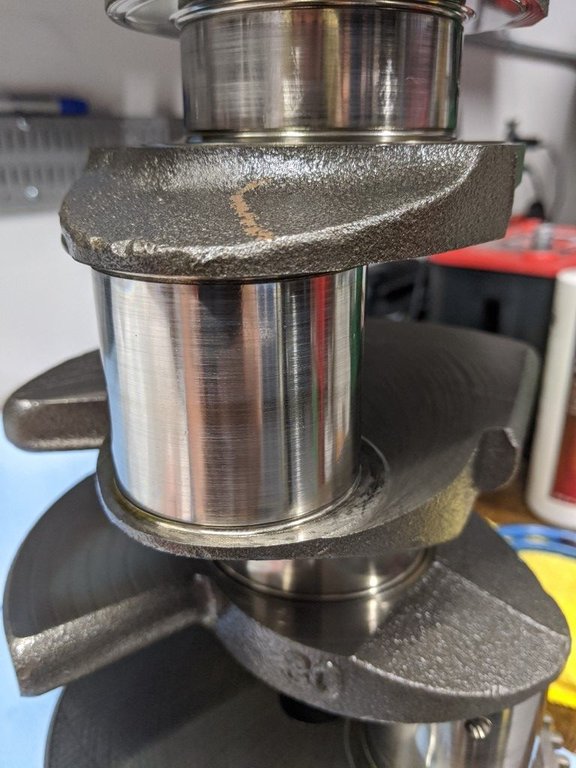

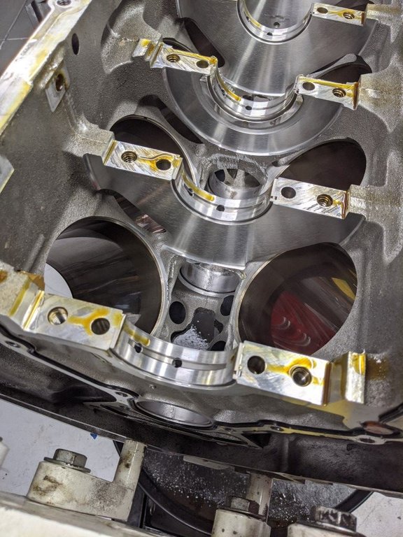

Do you mean the wear pattern on the main bearings due to a crank balancer issue? The main bearings didn't look too bad other than some light scoring, but there is one wear pattern on all of the bearings as shown here:
Old Jun 18, 2020 | 05:36 PM
HOXXOH's Avatar
HOXXOH
Joined: Sep 2007
Posts: 16,557
Likes: 2,106
From: Peoria/Phoenix AZ
C6 of Year Finalist (performance mods) 2019
Yes and the cam bearings too, since oscillations can affect the cam through the chain which has a tensioner.
