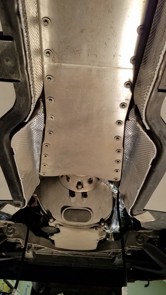

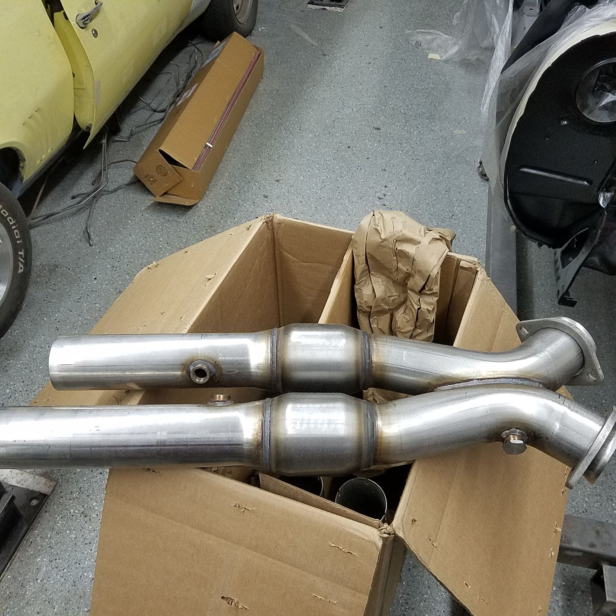

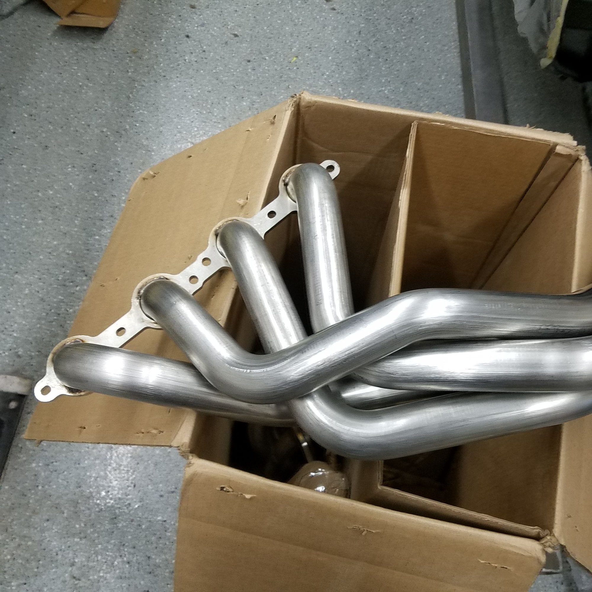

I installed 1 7/8" American Racing Headers & 3" Catted X-Pipe on my 2012 Grand Sport in Early 2019.
Tommy Wong (Vancouver,WA) My Tuner advised me to not use the rear O2's and too plug the Bung Holes.
I have a ROTARY Two Post Lift and feel its the BEST Tool that I ever bought myself . If youre doing this
install on Jack Stands...I would definitely have a helper, standing by as you'll constantly be needing misc
tools and other items.

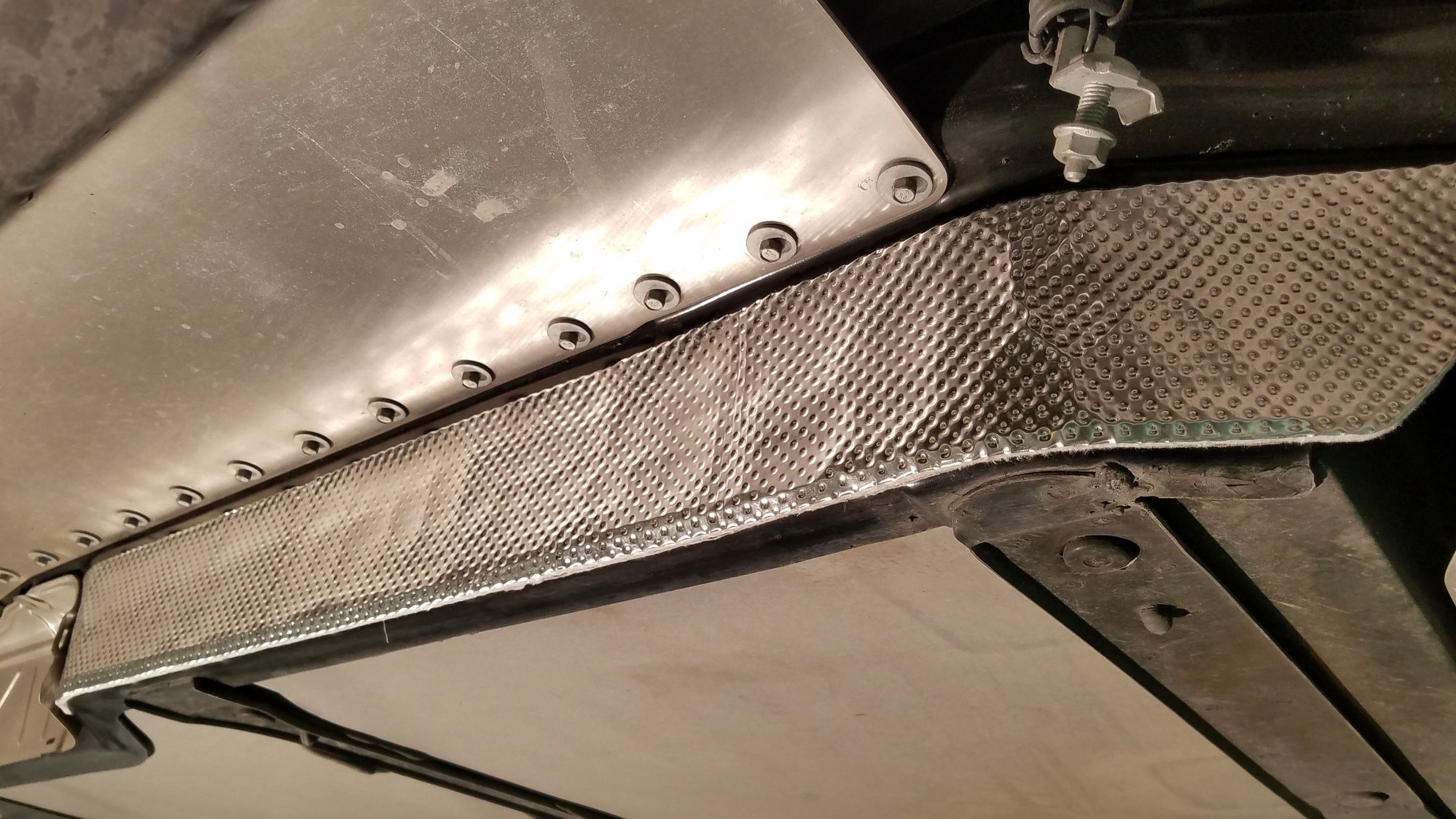

When I removed the OE Exhaust System I installed the DEI Tunnel Heat Insulation Kit.
I dont know about other brands but ARH warns that the RIGHT Inside Frame Edge may need trimming
and mine did. I used a Harbor Freight small angled air motor and a 3" Cut Off Wheel to make several
cuts until I had adequate clearance. The cut edge is extremely sharp so I then used a 60 grit flapper
wheel to dress down the sharp edge...I suppose you could hand file it......Doing this laying on the floor
will be a chore.............

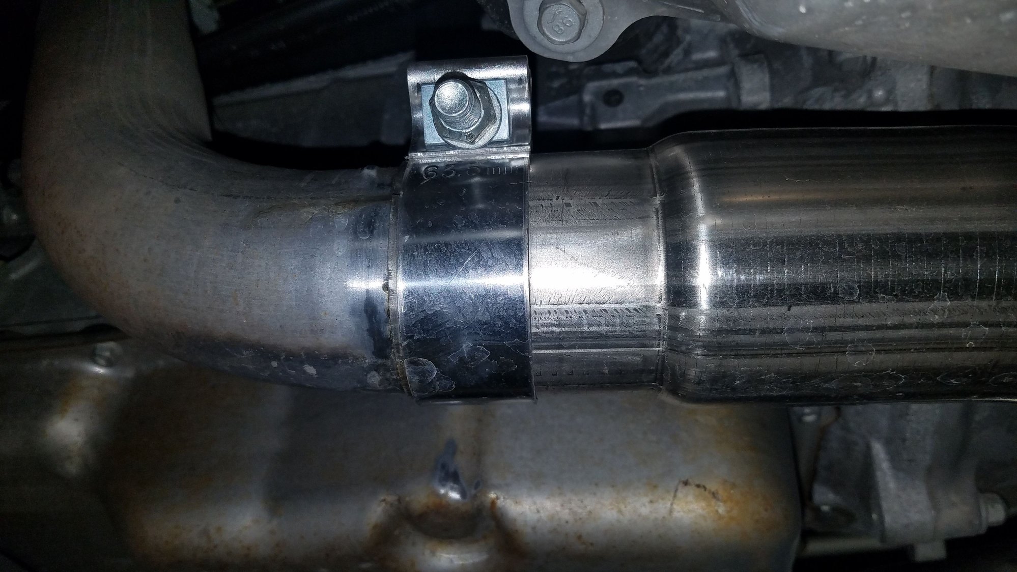

ARH headers have a bell mouth style collector end. You MUST leave one header loose in order to
get the X-Pipe started in Bolt Collectors ...then finish tightening the other header...I learned this the hard
way..........
I also went to a fastener supply in my area and bought the kind of nuts that cant loosen on their own....
Where the flanges hold the collector and X pipe together.....Look at my pictures and ask me questions
I also ordered Foil Insulating Tape Wrap from Summit or Jeg's and pkg's of Insulation for Trans Line
and Wiring Bundles ...the insulation has Velcro and Opens /Closes around whatever youre applying it too
Stock NPP mufflers..............400 RWHP on a MUSTANG DYNO ( Stingier than a DynaJet)
