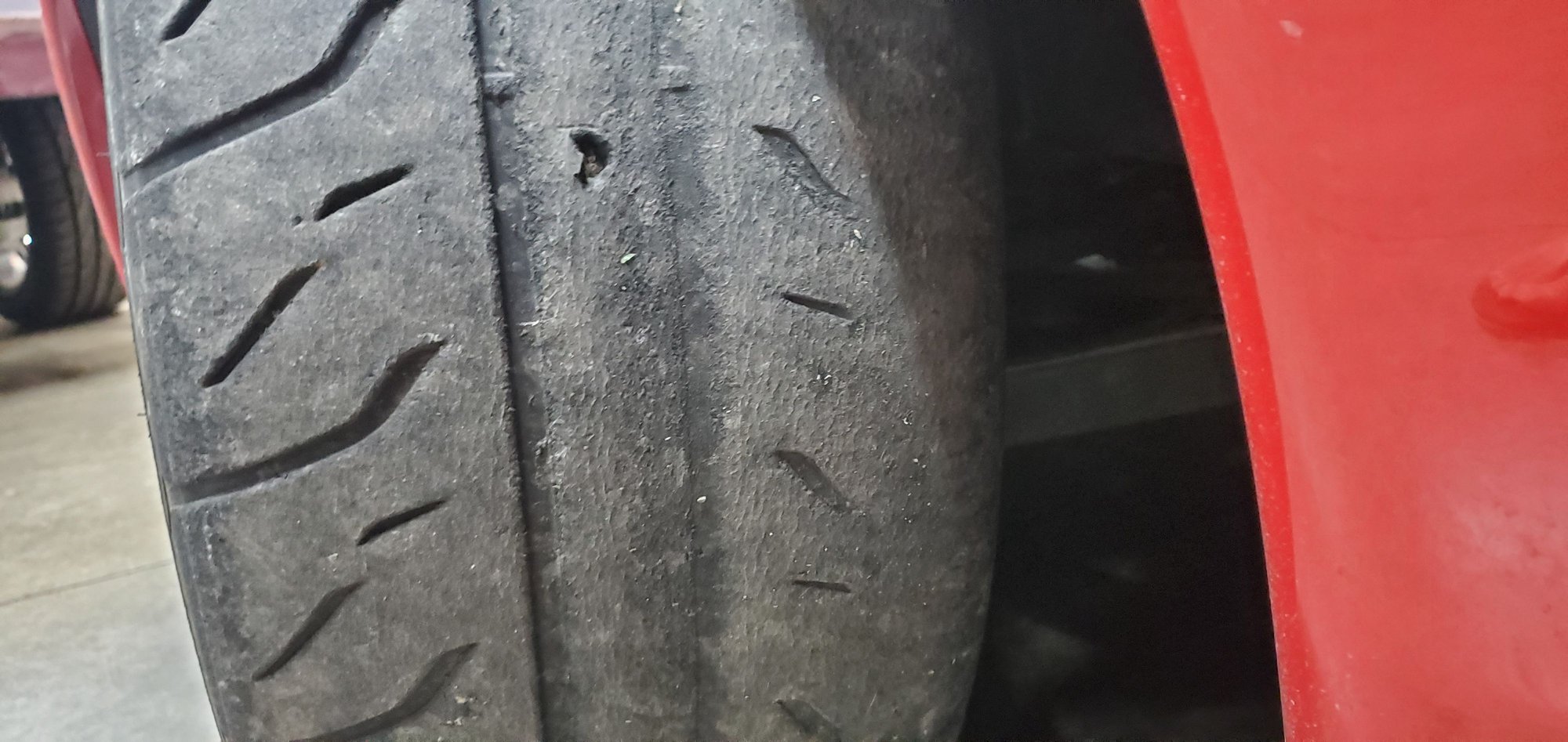

What is the widest tire I can fit on the front of a base C6 with factory wheels for autocross and still drive the car to events without rubbing? I don't really care about the rear tire sizes as there is plenty of information about that.
I'm a little upset about tire selection in general without squaring the wheels. You would think producers of sticky 200tw tire compounds would be all over Corvette sizes. I cannot get Hankook RS4s without buying rims (not happening until next season)... I don't plan on modifying the car for at least another season after this. I am plenty competitive for raw and pax times in an AS 'vette.
I smoke checked my Bridgestone potenza R71REs in a month. They were great tires for the first couple events but an event where I was able to put heat in the tires they ate themselves. This creates great concern for me when I go to do a fullsize track day. I know there are things I can do different to care for the tires but still feel they ate themselves too quickly. The other option I have is BF Goodrich Rival 1.5S. I liked the original rivals I had 6/7 years ago on a mustang but everybody and their mother is running the bridgestones now. Does anybody have experience running Rivals on their Corvette? My biggest concern is how the tire handles heat. I am a driver who can continue to improve or stay consistent with lap times on hot tires and I don't like the concept of backing off to save tires when I'm only going to get 20 mins at a time to drive or limited (if any) fun runs.
... anyway, what is the widest tire I can fit on the front of my C6 without rubbing?
Thanks!!!!
(Picture of my front potenzas, post flip to squeeze an extra weekend out of them)
