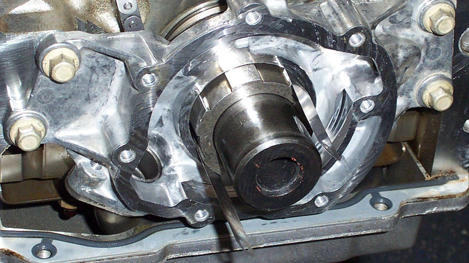

I had great oil pressure for about 15 minutes of run time when my oil pressure dropped to zero. I checked the normal o ring issue but that was good so I decided to pull the oil pump and this is what I found. Any ideas on what went wrong before I replace it? I don't want the same thing to happen.

Easy one, and when you installed the oil pump, did not use feeler gauges to center it on the crank shaft.
Also, when the timing chain cover is installed, it needs to be aligned to the shaft via an alignment tool as well.

I thought the newer oil pumps because of tighter tolerances didn't need to be centered.....?

l installed another pump and it did the same thing so that was not the issue. Something else is going on.

Could the crank be bent? Any chirping belt noises or wobbly balancer? That's a head scratcher. When you find out, please inform.

Put a dial indicator on the surface of the crank where the oil pump rides (one with magnetic base will be fine), and rotate the crank 360 too see what the run out of the crank is.
Up to .002"'ish is normal, but if you are in the .006" or greater range of run out, crank snout is too far bent and will need to be resolved.
Note, if you did have the crank polished at rebuild with block prep, they should have checked the crank for run out, and the problem may be that you have too much lash in the main bearings that is allowing the crank to jump around too far, if the crank is in spec for run out..

I was thinking a bent crank snout I will get back with results when I get to it.

Well I checked the run out of the crank snout and it is bent.

well the motor came out of a low mileage wrecked CTSV. It didn't appear to have any damage at all however I did take it apart and put all new bearings, rings, gaskets, ect. I checked the crank but not at the front. Everything seemed to be in great shape. I am guessing it was a front end collision and hit the pulley. Lesson learned on my part
