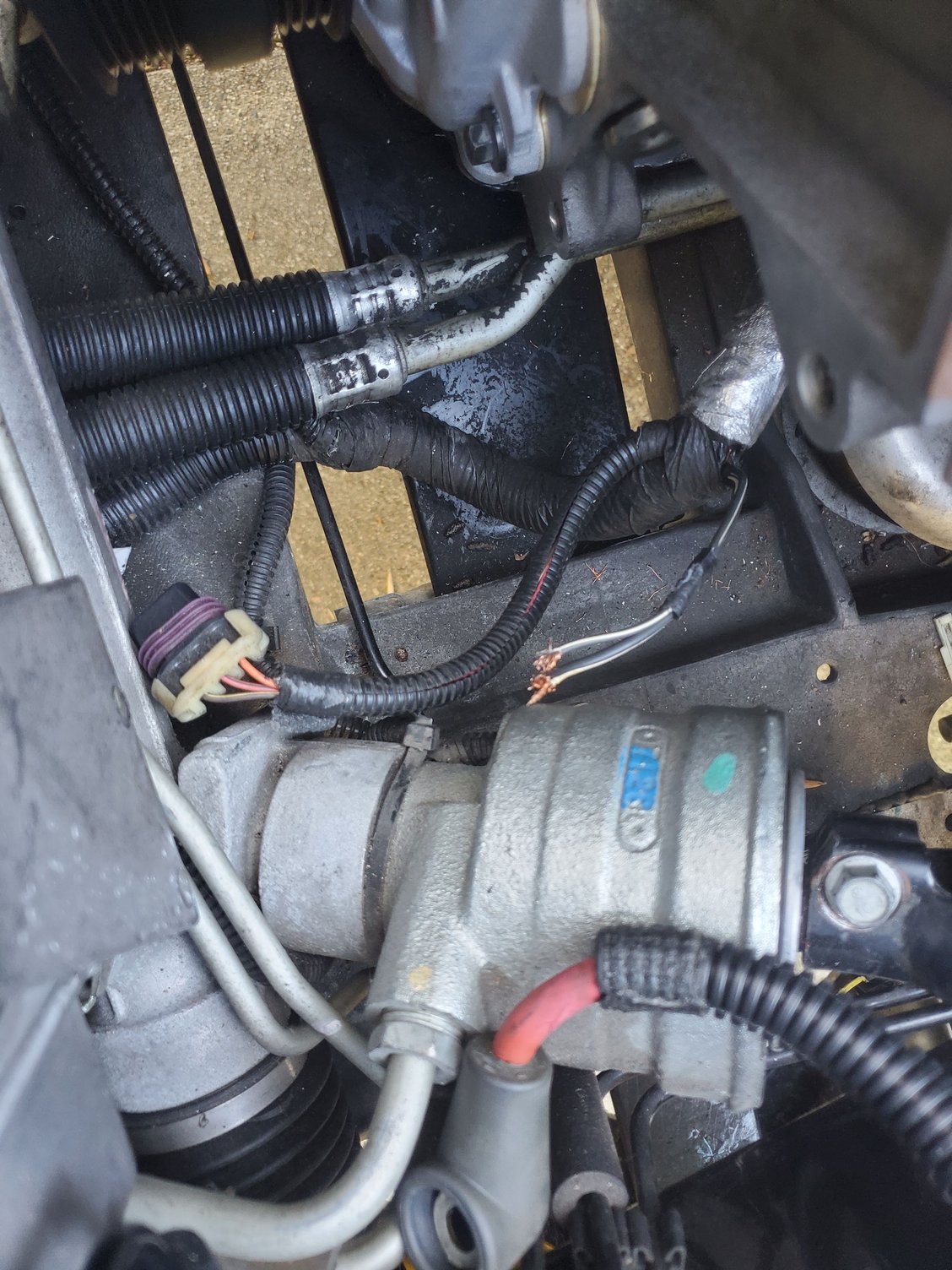

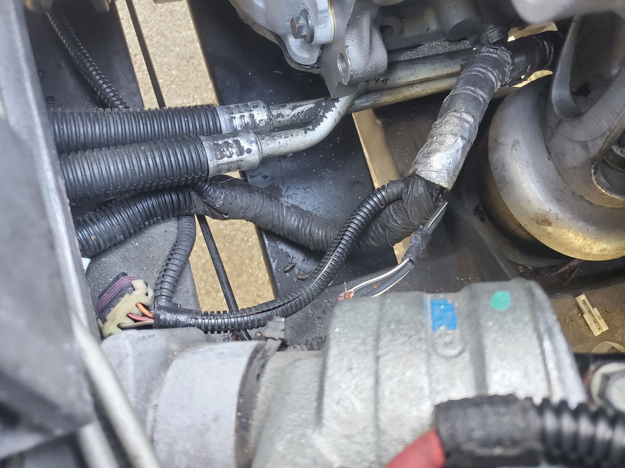

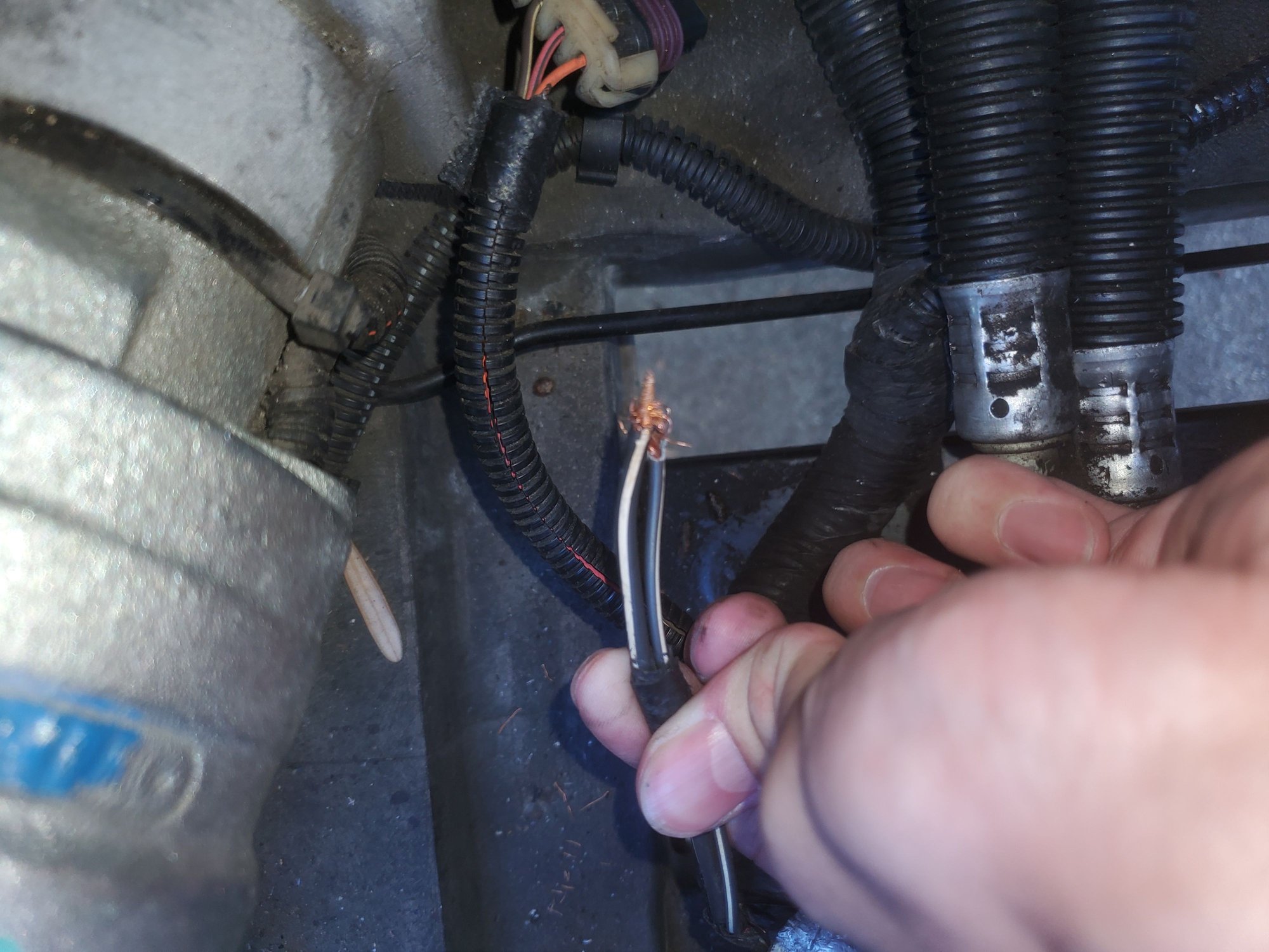

Hey all,
Had a harness wire snap when we pulled the engine a while back and now my dad and I forgot where it connects to, pics below
Car is a 2008 C6 ZO6, we are stumped. Alternatively, if anyone could point me in the right direction to an engine wiring harness diagram, that would be excellent.
Looks like a black wire with a white stripe, at least I believe it's white, or a very light tint of yellow. Willing to take more pics of alternate angles and provide more information if necessary

From the pictures it looks like these are black wires with a white stripe. Usually black wires are ground wires. And ground wires are bolted/clipped (grounded) to the body or engine somewhere. Just a guess....

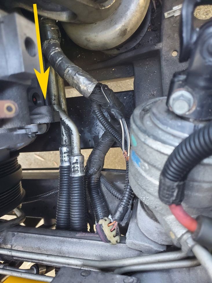

That's the left block ground. It had a ring terminal on it. It was secured with a bolt to the block at the position indicated by the arrow:

This is the answer!
Really appreciate the response, got that ground hooked up just right. Now just waiting to get a couple more things connected for a start!
