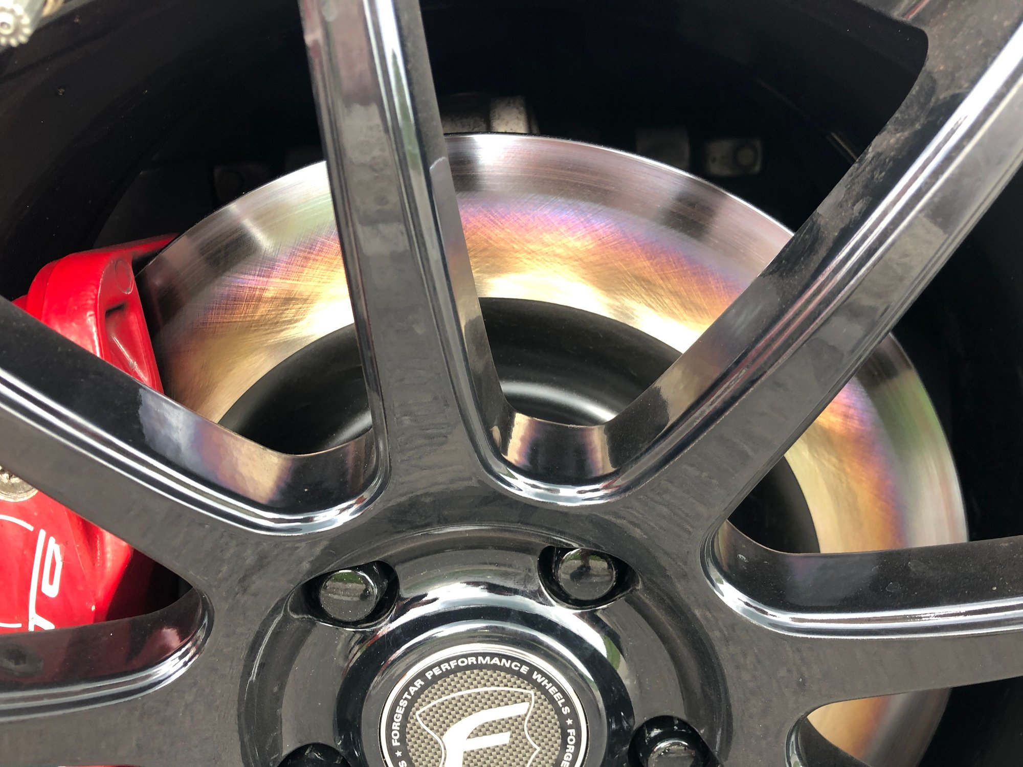

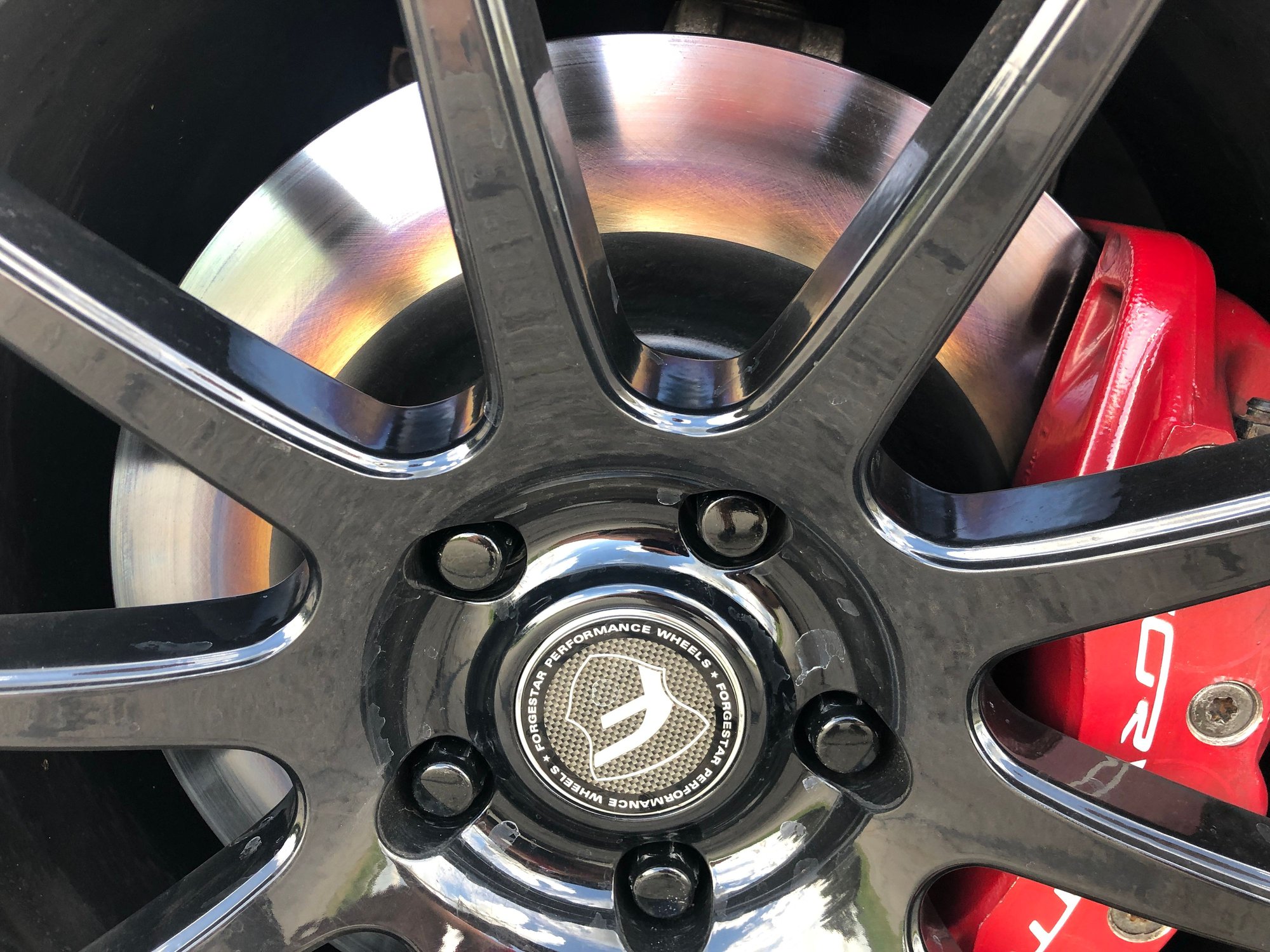

I have a 2008 z06 and just installed Stoptech sport pads and centric premium rotors. I went out to bed the pads and after a few beddings I inspected them and noticed a heat ring on the rotors. As if the pads are not contacting the whole face of the rotor. I’m also getting a pulsing in the pedal. I’m not sure if there is an issue since I went from the OEM padlets to a one piece pad. Any advice?
Drivers side.
Passenger side.

I haven’t used that exact setup.....do you keep the padlet bolts. Were they interfering at all?
the outer edge moves faster than the inner, so some variation is expected. However I would confirm the pad cam easily slide on the colts

I’m going to take it apart again and inspect the pins again. They are the same ones. All I changed was the pads. The pads seemed to install pretty easily so I think they’re moving ok. I’m concerned that maybe the pins are bent which causes the pads to hit the rotor at an angle.

Bump, I took the brakes apart again and cleaned everything again. Also bled the system. Put it back together and still having a dragging issue and pulsing. Starting to wonder if my stoptech pads are just shot from pad slapping the rotors that were on the car (only 20-30 miles or so with that combo tho).
