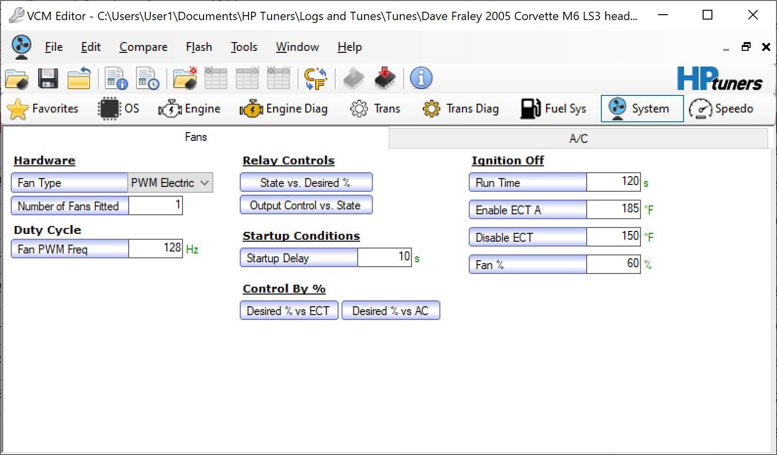

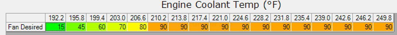

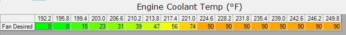

I have very similar setup on my 2005, except I used LS3 heads/intake.
My car started getting hot, in 240 range also.
Using HP Tuner I checked my fan settings, which were set at stock. I now have more aggressive fan settings. See below:
OEM settings:
Revised Settings:
Other fan settings:
Now my car runs between 198 and 205. It never gets above 210!
I'm running OEM radiator and fan.
