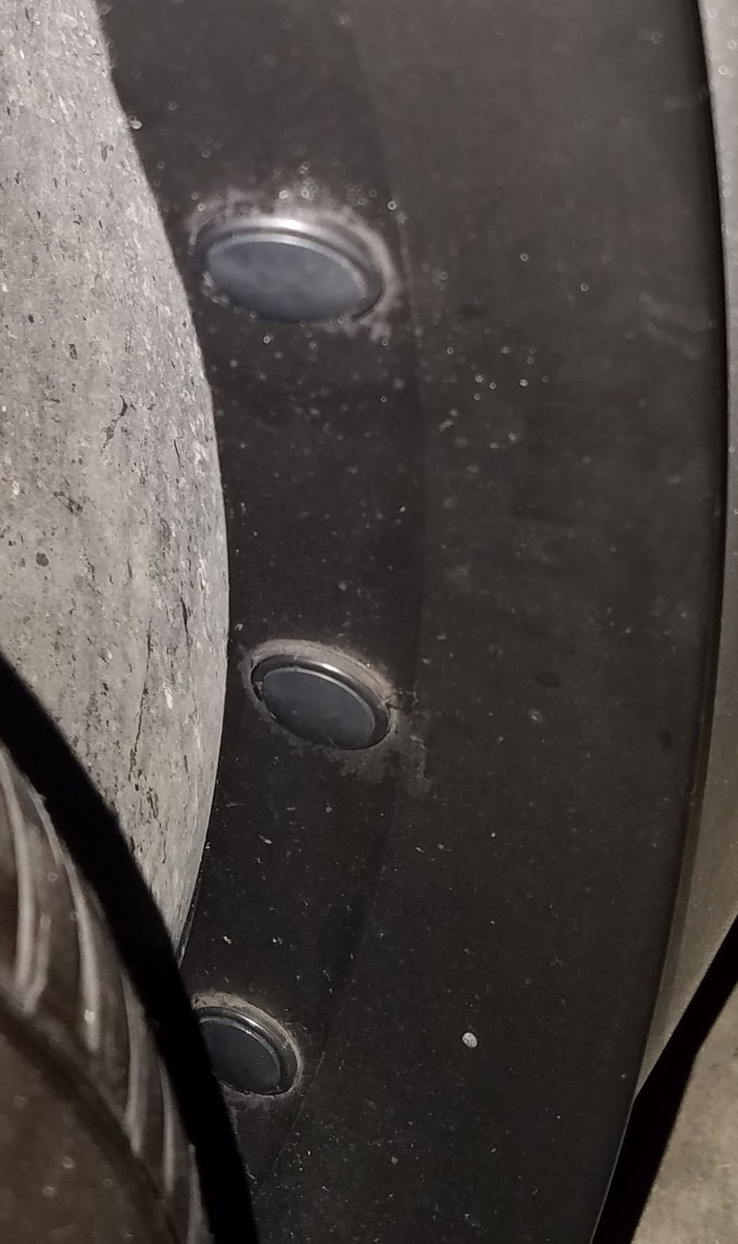

I have these push rivets on the splash guards of my '07 base. They have a very thin head that sits down inside a shallow cup on the base. I don't want to mar them up as they are easily seen on the splash guards. Is there a trick to removing them or are they like all the rest and need to be pried up?. Need to get into the fender vent to install grills.

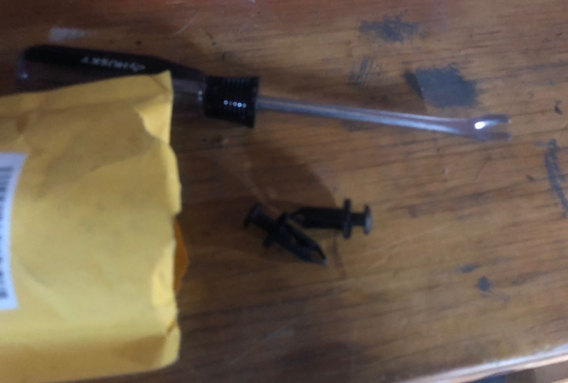

I've used this tool for plastic push rivets...
Have managed to keep them from getting too marred up using it. Reused the pins on the front fender well after swapping headlights. I ordered some spares though when adding after market splash guards, good to have on hand...

SK makes a great push rivet removal tool:
Amazon Amazon
Even with the tool, a couple rivets may get distorted during removal. I keep a few new replacements handy.

Ok thanks, I looked for a slot for screwdriver but dont see one. Also haven't seen the ones with the cap down inside the cup.
