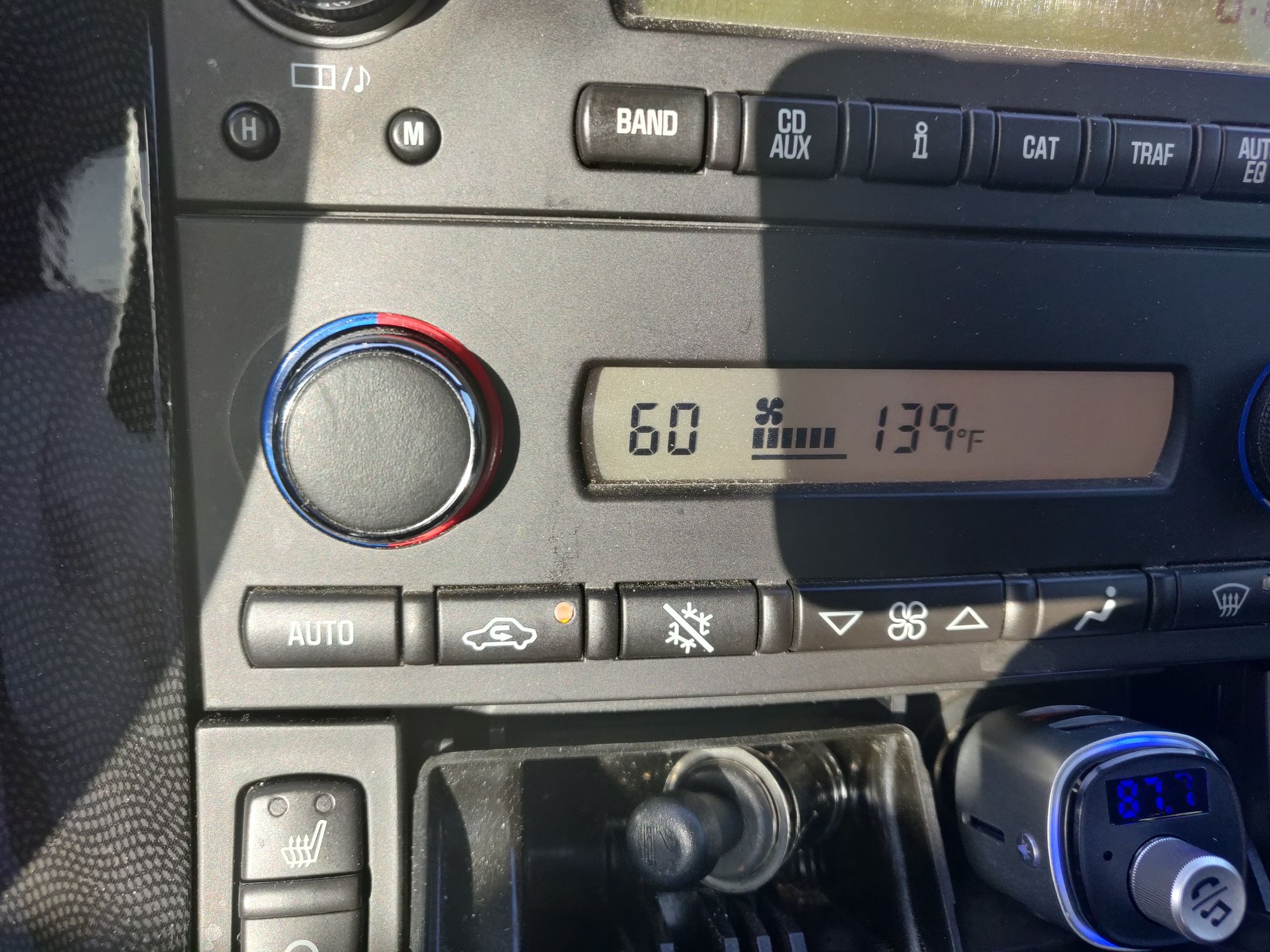

Default It’s hot outside in Florida...
But I don’t think it’s this hot.

😂 so the real question is...how hard is that sensor swap?

Not very difficult to change out. You can do it from the engine compartment on the passenger side. Remove 1 push retainer, haul out the temp sensor after removing the connector.
If you disconnect the ambient temp sensor connector and jumper the 2 wires together that is what you’ll see !!...may be a short to ground on the signal wire (2 wire thermistor circuit) or a bad sensor !!...if you disconnect the connector and still see 139 you have a short to ground !!
