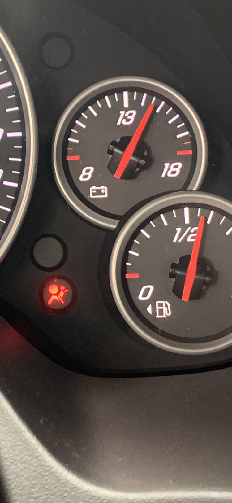

Is there anyone who knows what causes this and the cure? It came on a few time for a few days and would disappear after a restart of the car. Now it’s on constantly... thx

Check the connector under driver seat, this issue is a common cause of the air bag light. From what I’ve read it can be accessed without removing the seat. I removed my seat, four bolts it’s out, easy peasy. Clean connection up and zip tie connector together that should do it.
