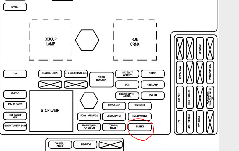

I have a 2010 GS with the NPP exhaust. Bought it used last month. The owners manual is not showing what fuse is for the NPP.
can someone please advise ?

Its the 10amp fuse circled in the pic. EXL MDL. The fuse panel is Located under the passenger side floor board

There's a white fuse puller in there. Pull bottom right 10A fuse, and push it into one of the spare fuse slots, leave fuse puller attached. I decided to DIY the mild to wild switch for $20, just gotta wire it in but being lazy now...

Success 😉 hardest part was getting the fuse puller out of the slot.
