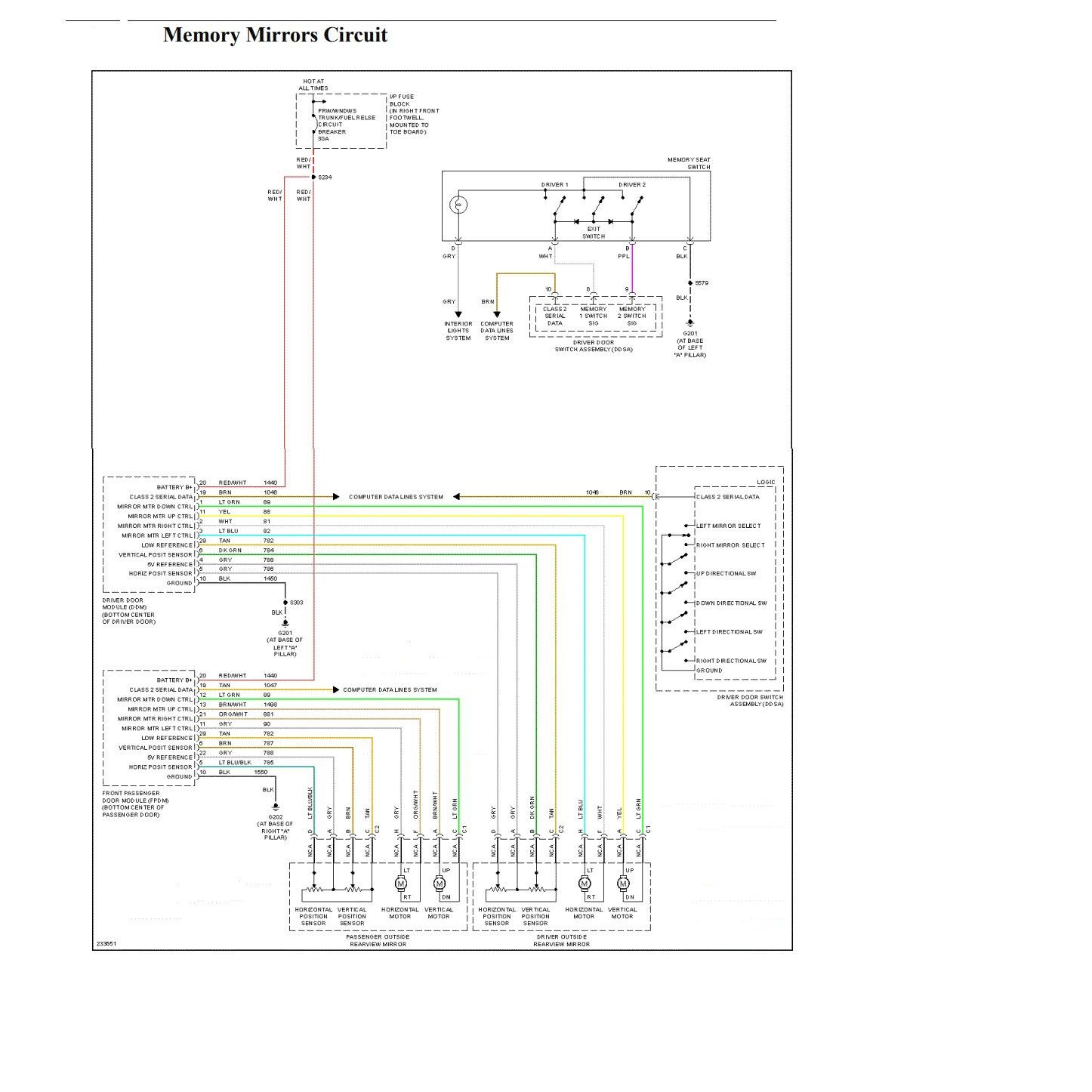

Hi , I recently installed oracle mirrors from vette lights , I have everything installed correctly , but only one led strip light is showing on the driver's side, but the passenger side has no light at all. Is it possible if any of you guys have the wiring diagram , to see if I'm doing something wrong ? Please reply back thank you !😁

Welcome to the forum. You don't state the year if your C6. I have diagrams that I can post from a 2005-2007 , but every year should be the same for the mirror wiring diagrams if that is what you want.
I've looked at the Oracle video on installation, and it seems like straight forward install using T-taps, which in my opinion is not always the best way to join wiring.
https://www.vette-lights.com/collect...t-side-mirrors

Here is the mirror diagrams for a 2006.
To Oracle Mirrors LED problems ? C6 corvette
