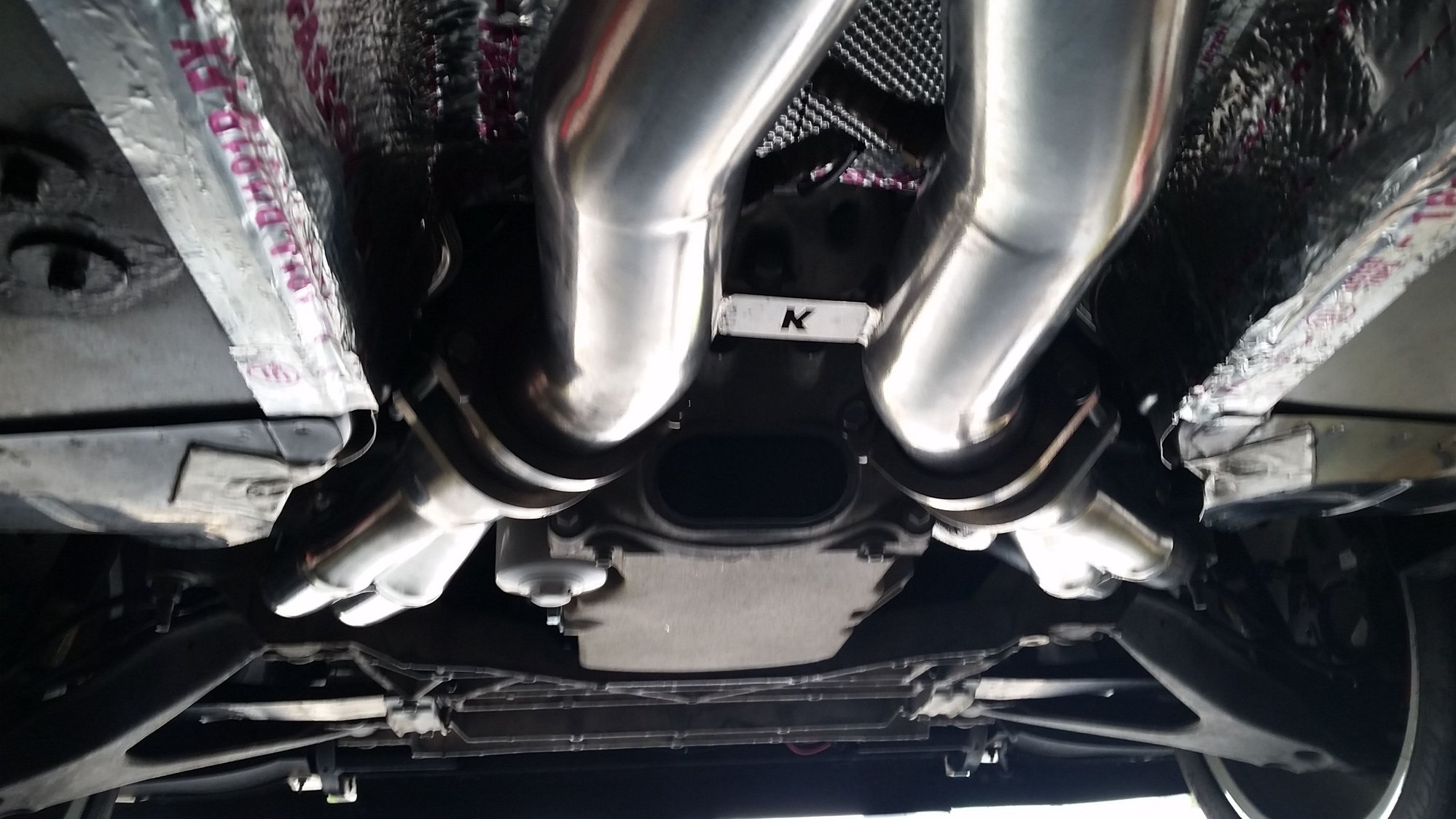

And the Pfadt / aFe Power headers uses flanges with V-band clamps
Attachment 48332920

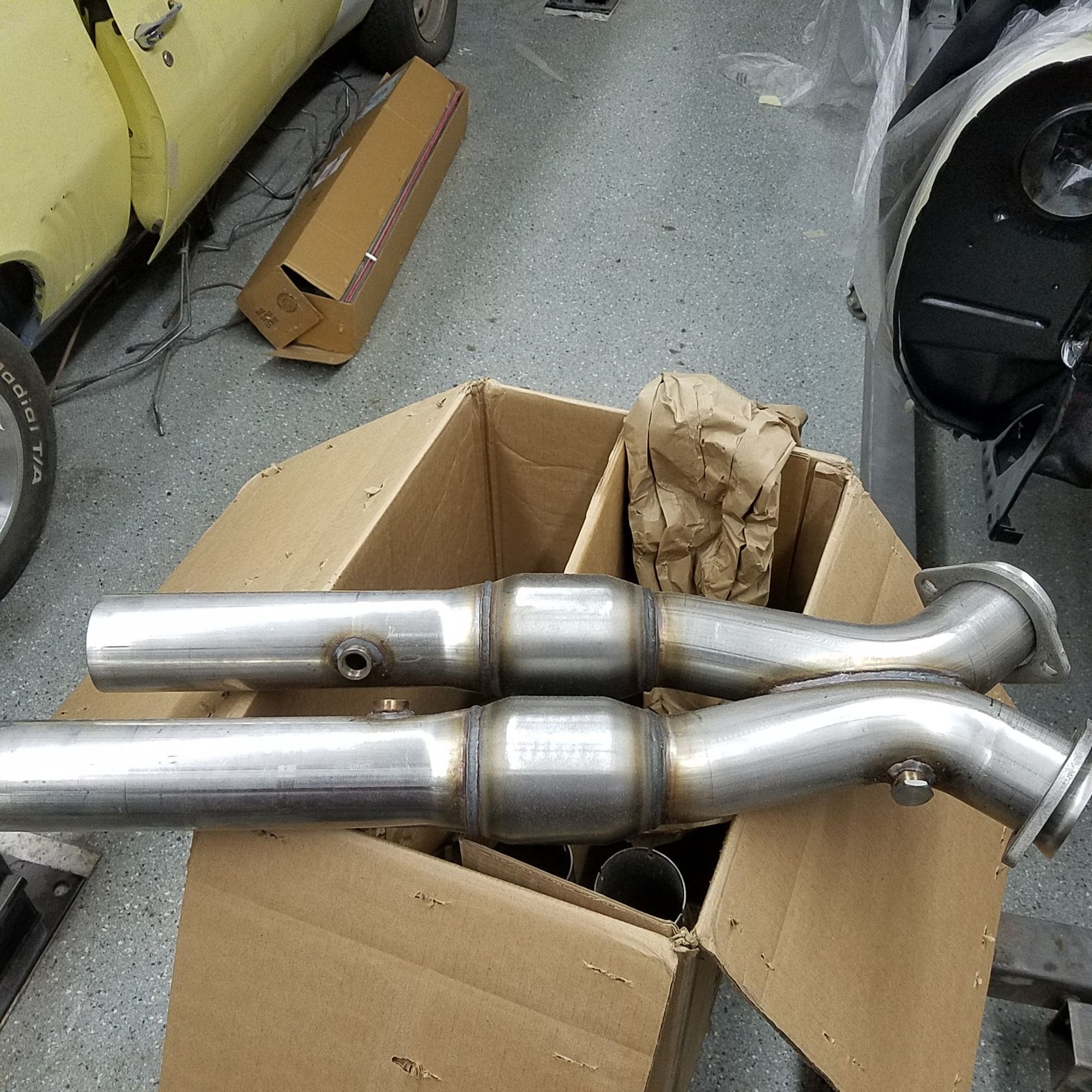

3" Catted X Pipe
1 7/8 ARH
2012 Grand Sport
I removed and plugged the REAR O2 sensor bungs and the car was tuned
3" X pipe adapts to fit 2.5" NPP over the axle pipe
