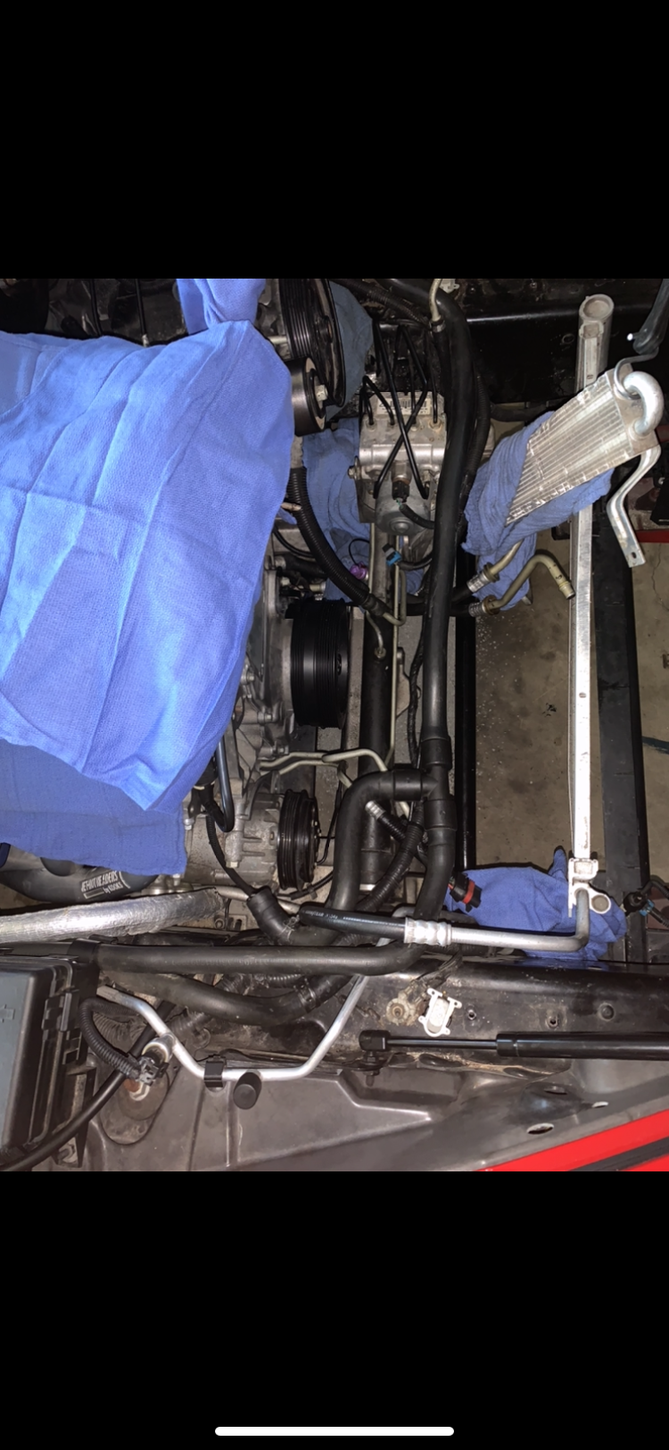

I’ve had my radiator out twice once to replace and once for cam swap. It’s best to remove fan(s) shroud. It will give you just enough room to separate from ac condenser without having to discharge system. Here’s a few pics of my 05 and the ac line does run above radiator also.
