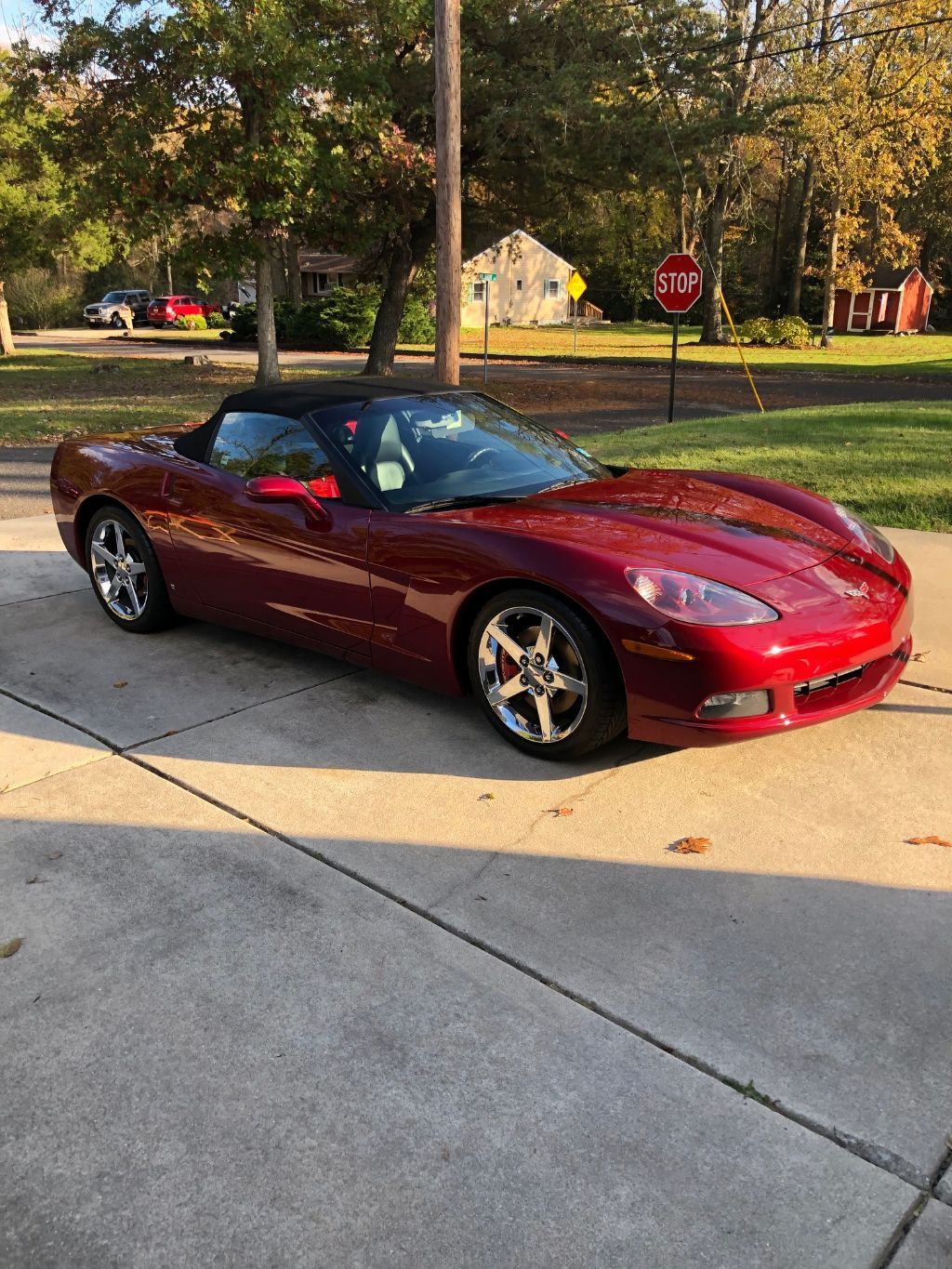

Just bought my first Corvette last Saturday. I've been reading the forum to learn as much as possible but still have a long way to go. I enjoy all the knowledge on the site. Wanted to get some advice before my service appointment this Saturday. Here is some information about my Corvette.....its a 2006 Convertible with 42,000 miles. The last five years it has been driven about 300 miles a year. Other than an oil change, What are services should I get done this weekend?

Do you have any maintenance records on the vehicle?
If it hasn’t been completed yet you are due for transmission, differential, and a coolant flush.
Although you may not notice a difference, keeping on top of the fluids will save in the long run of ownership.
Very simple to change your own air filters on these cars
Gorgeous car by the way...
