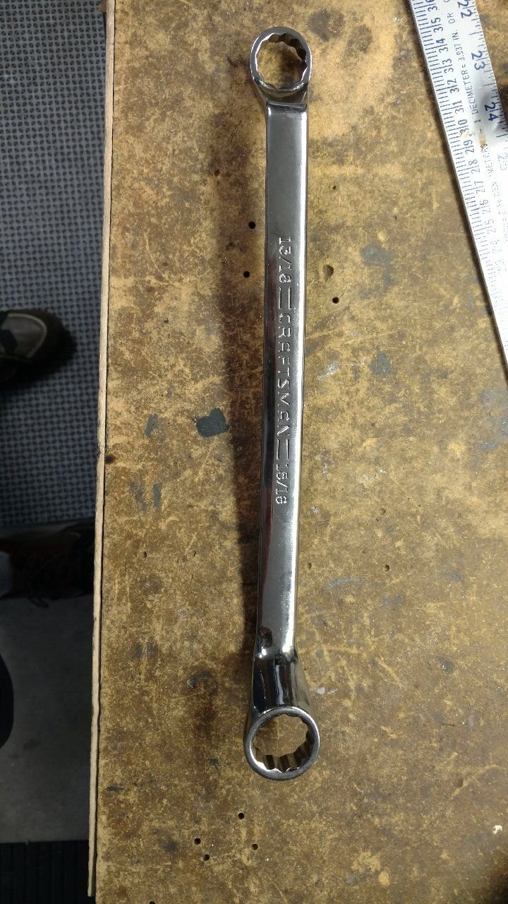

This works too. Make sure car is in neutral and you have a block behind the wheels. Its a 13/16 15/16 offset wrench. Very long handle just put a rag or a hose on the end for cushion.

An offset wrench will do the trick. If you're just going to torque them down at least spin the engine 360 degrees and torque them again to ensure everything is seated.
