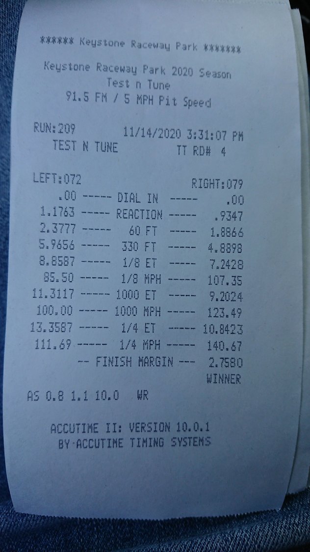

What is your 60'? I would say those are low traps. I'm an A&A and went to the track saturday for the first time in 10 years and in this car ever.
https://photos.app.goo.gl/u6TwqsCuAiUtqALF8

1.7 60 foots.
yours is a really high trap. Must be running a lot of boost , nice. Similar setups to mine with more boost and proper tune are in the 134-137 mph range and mid 10s. I’d be happy with that.

3.6" pulley, i think it's around 14psi? That makes sense, then.. .nice! I plan on grabbing some seats and a harness bar... 15x10's and 26's or 28's.
