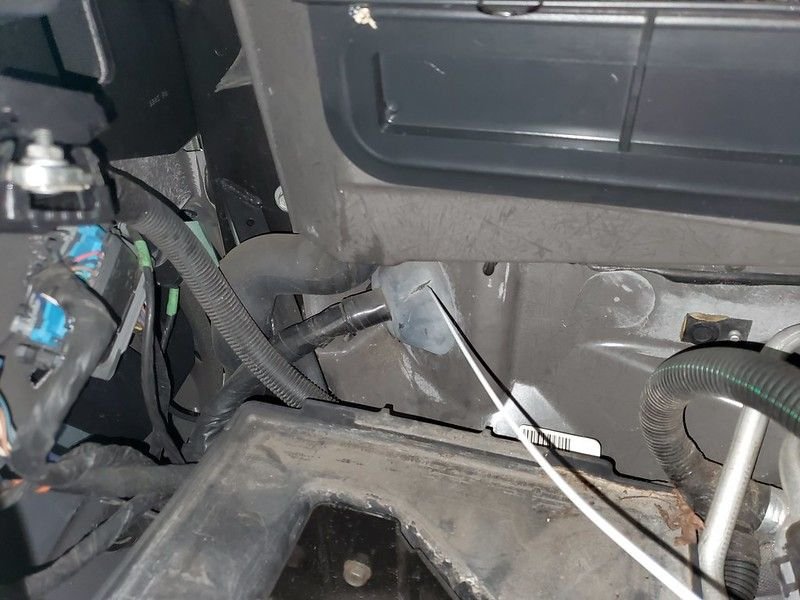

where's this hole? I have an '05 base model and I'm not seeing anything
I have a ZR1 so I am guessing they are different since my battery is in the back. Ill get a picture tomorrow when I am home
That hole is actually a large wire grommet that the main wires from the engine fuse box runs through to the passenger footwell electrical boxes. That grommet is found behind your battery in the engine compartment. You will have to remove your main battery to get access. If you use this, be careful not to damage any of the exirting wiring going through there.
This is the one I was talking about.
gotcha, I was looking at that but not sure how the fit goes together, I'll look at it closer once I start tearing into the interior.
Thanks for all the pics and suggestions
Take a coat hanger other piece of stiff wire and poke it slowly through and you will see where it enters the interior. Then you can attach the camera wire to the end still in the engine bay and pull it into the interior.
