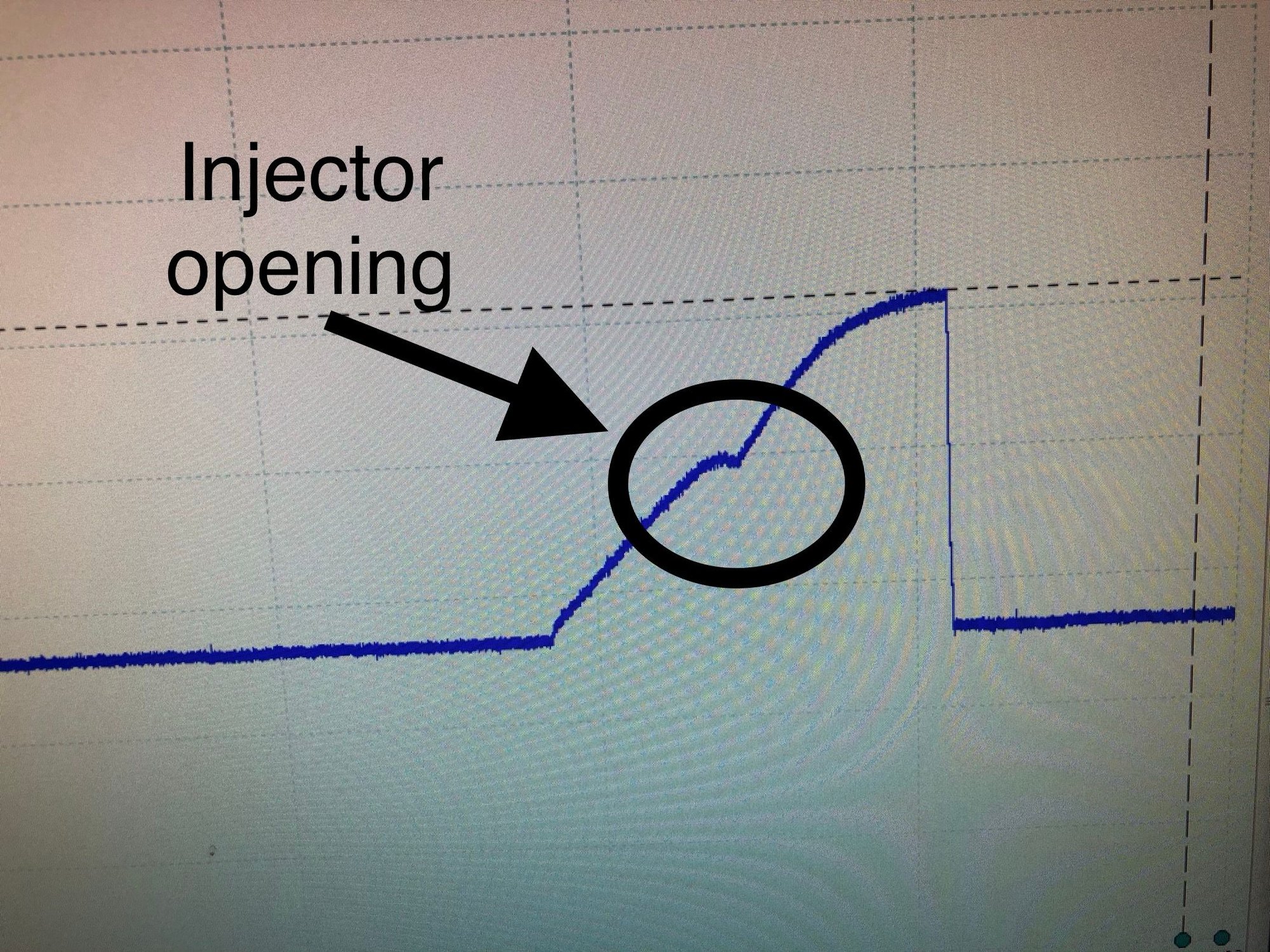

You will just have to assume the injector wiring is good when you swap the injectors !!...I like to current ramp suspect injectors just to make sure I’m not losing power or ground or that the injector itself is not shorted...each injector draws about 1 AMP of current...this is what I like to see with a scope.

If I swap the injector with the cylinder 2 injector and the problem move to this cylinder so the injector is the problem.
am I right ?

Yes, if you swap bad suspect # 7 with #2 and the misfire moves to #2 suspect a bad injector !!
