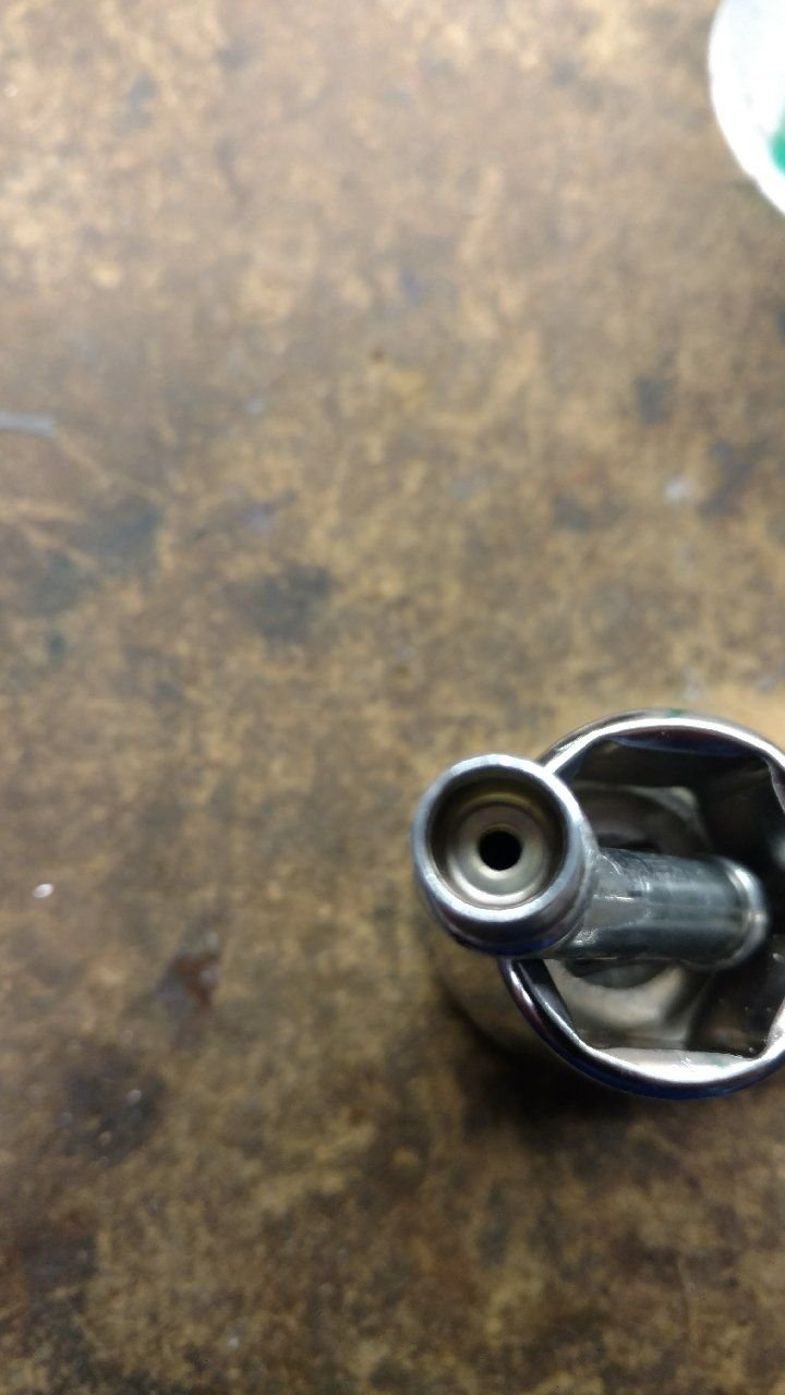

Here is a photo of inside the valley pan crankcase tube. You will see it is not really a 3/8 tube but a 1/10 of an inch restrictor. Based on a .100 hole orifice chart and say a few psi you are lucky to get a few CFM and same goes if you have 18 inches of vacuum just few CFM. A majority (like 80%-90%) of the blow by at WOT is handled by the valve covers which can go to the air and or the intake bridge. Also big cam guys don't have a lot of vacuum and the .100 hole is not enough for the PCV that is why on the 454 LSX motor you buy from GM they have 2 dirty side ports one from the valley cover and one from the back of the passenger side valve cover. Another reason for the valve cover port is that it cleans out the air from the back side of the engine. With the big cam you are lucky to pull 60% of the air in as a stock motor with 16 inches of vacuum along with the higher power level (more blow by) you need another dirty port. A typically PCV system will flow 3-4 cfm at idle. With the old pintle valve system it was done/adjusted automatically. Basically the LSX valve passenger side valve cover has a .100 orifice in it also. So the 2 of them make up the dirty side of pcv system. The instructions you get from GM on the motor are 3-4 pages with a 1/2 page covering the PCV system. Big cam cars - Pull your clean side hose and put a .100 restrictor in it and you wills see how little it flows.
