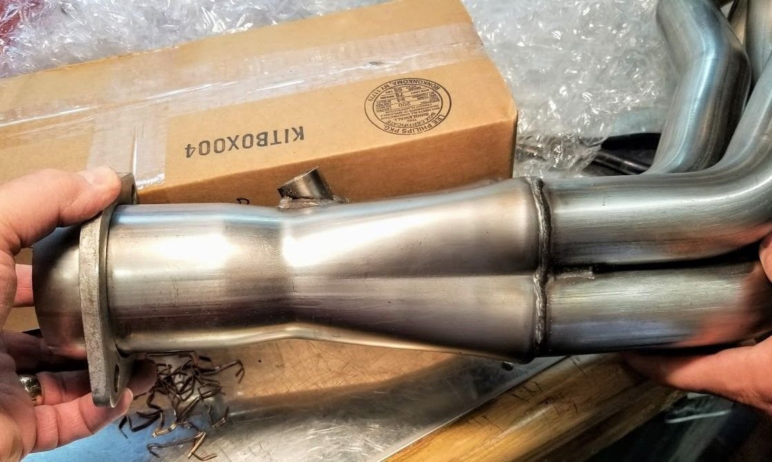

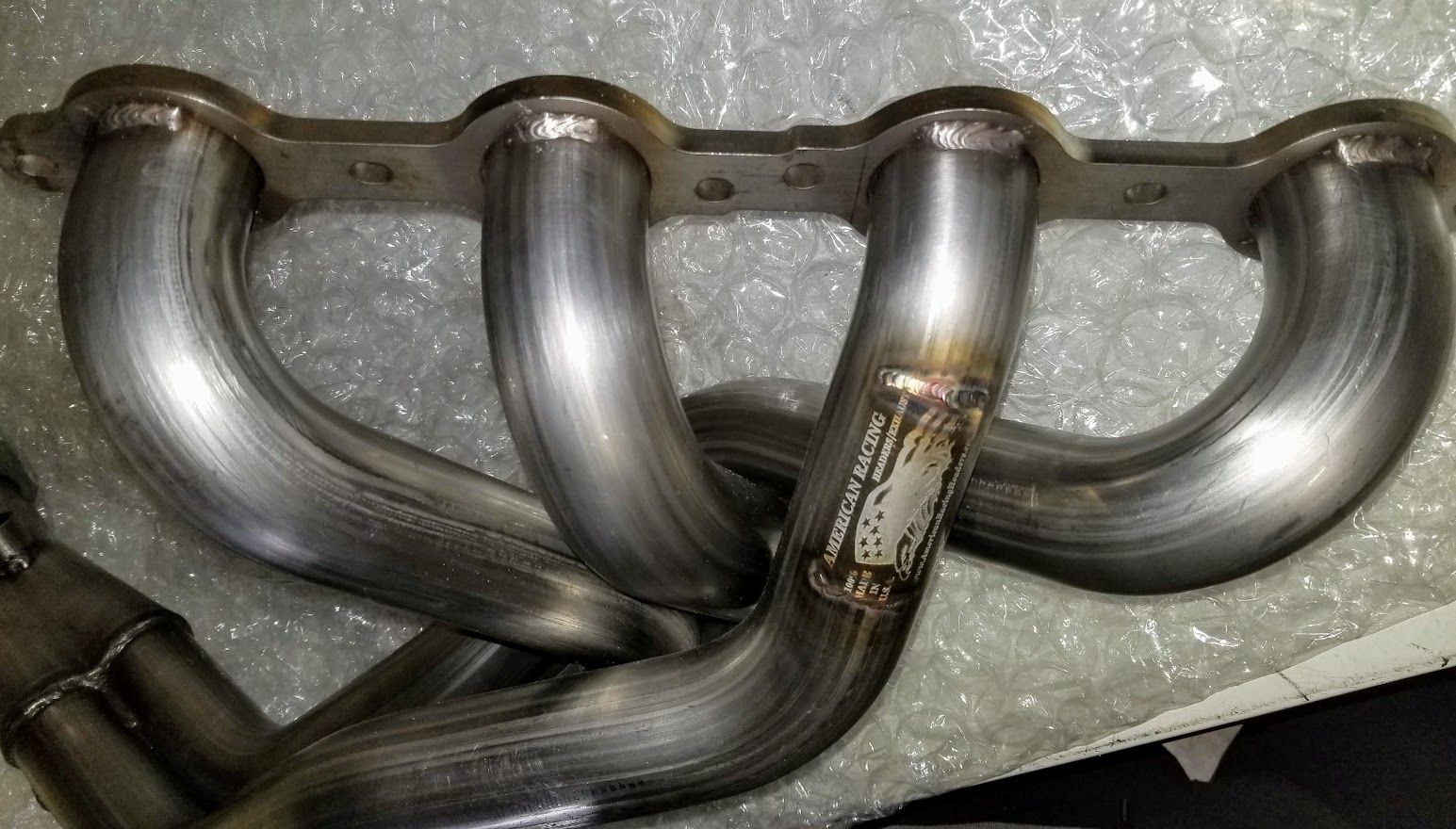

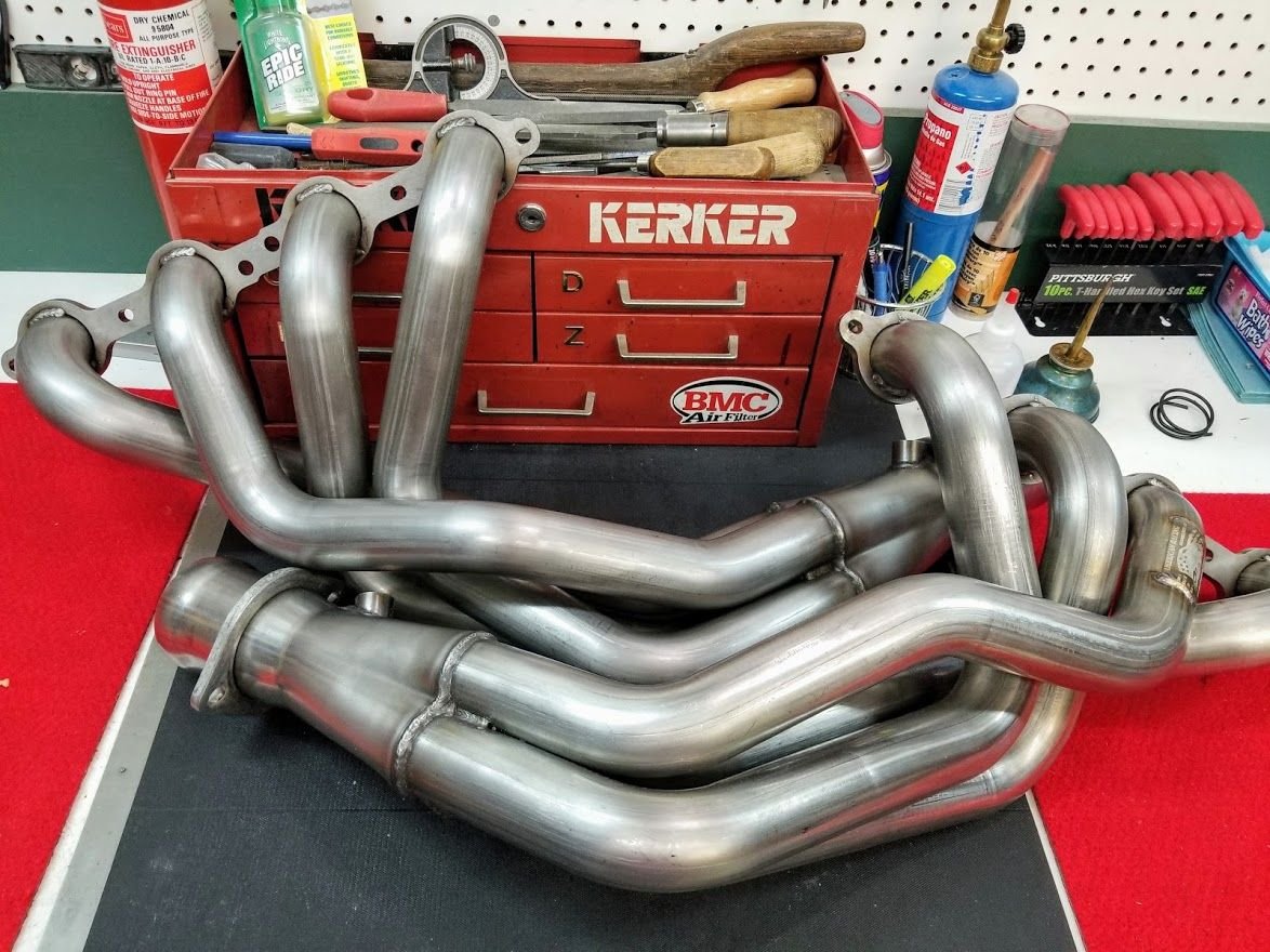

I’m posting this just to show the pictures and share my experience. I took pictures of things I’ve not found on the web before, so perhaps these will be illuminating for some. I’m not bashing any other header maker out there, I’m not about that. I’ll be doing the install myself probably next summer, and will take pictures, and do a post about that as well. My many thanks to Sal and those involved back at ARHs for the prompt support and great customer service.

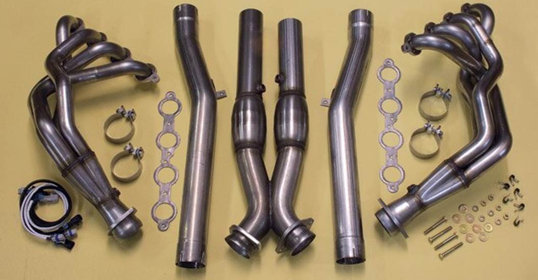

This is a web-shot for a Z06, but it shows basically what I got.
Da-Headers!
Nice welds at the flange, top & bottom.
Nice merge collector profile!

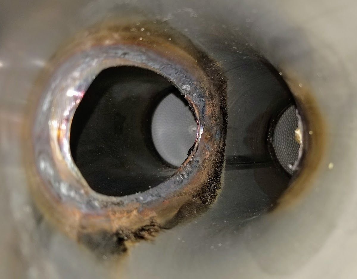

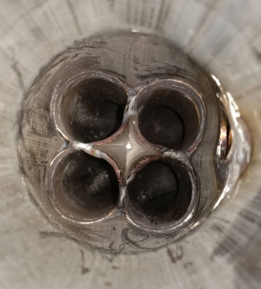

Inside the collector, there's the merge spike.

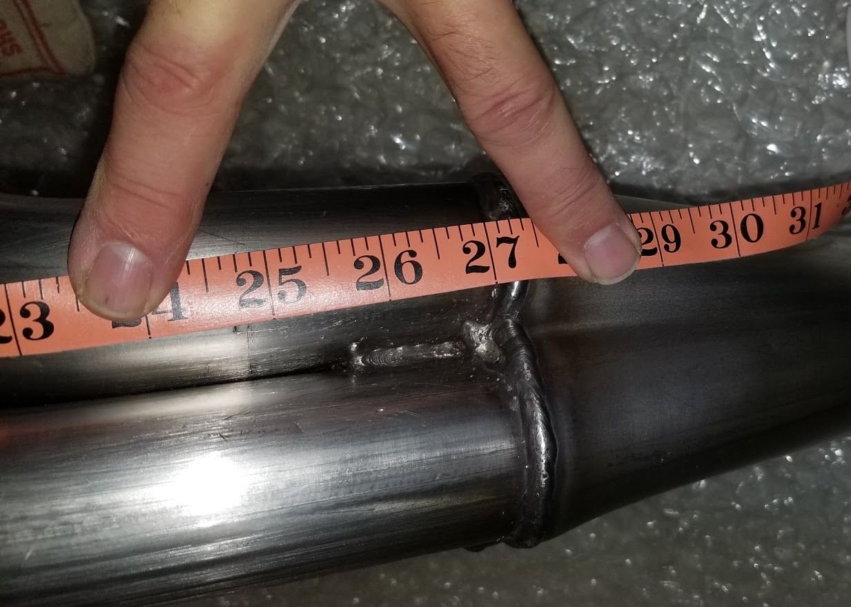

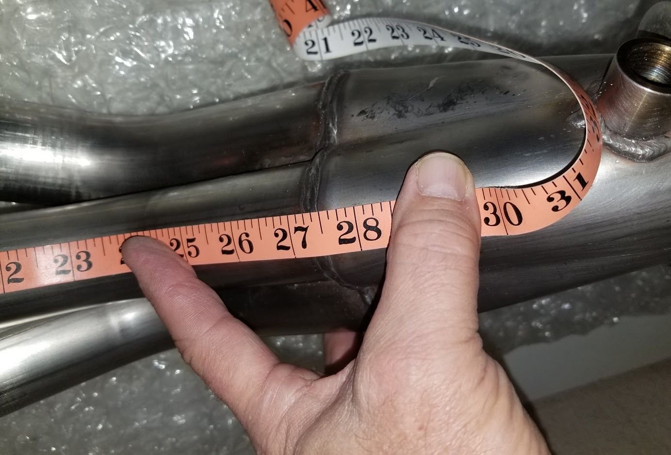

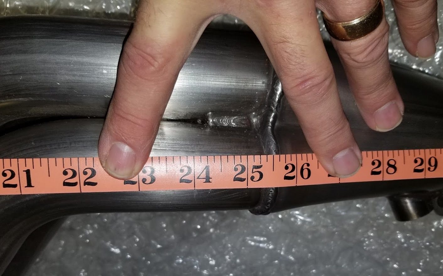

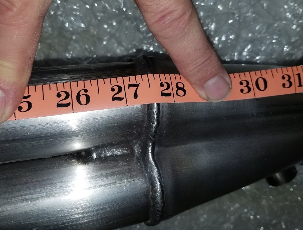

Just measuring the primary lengths, working my way around the header, all; 4 pipes. See the next 3 pics for the others.

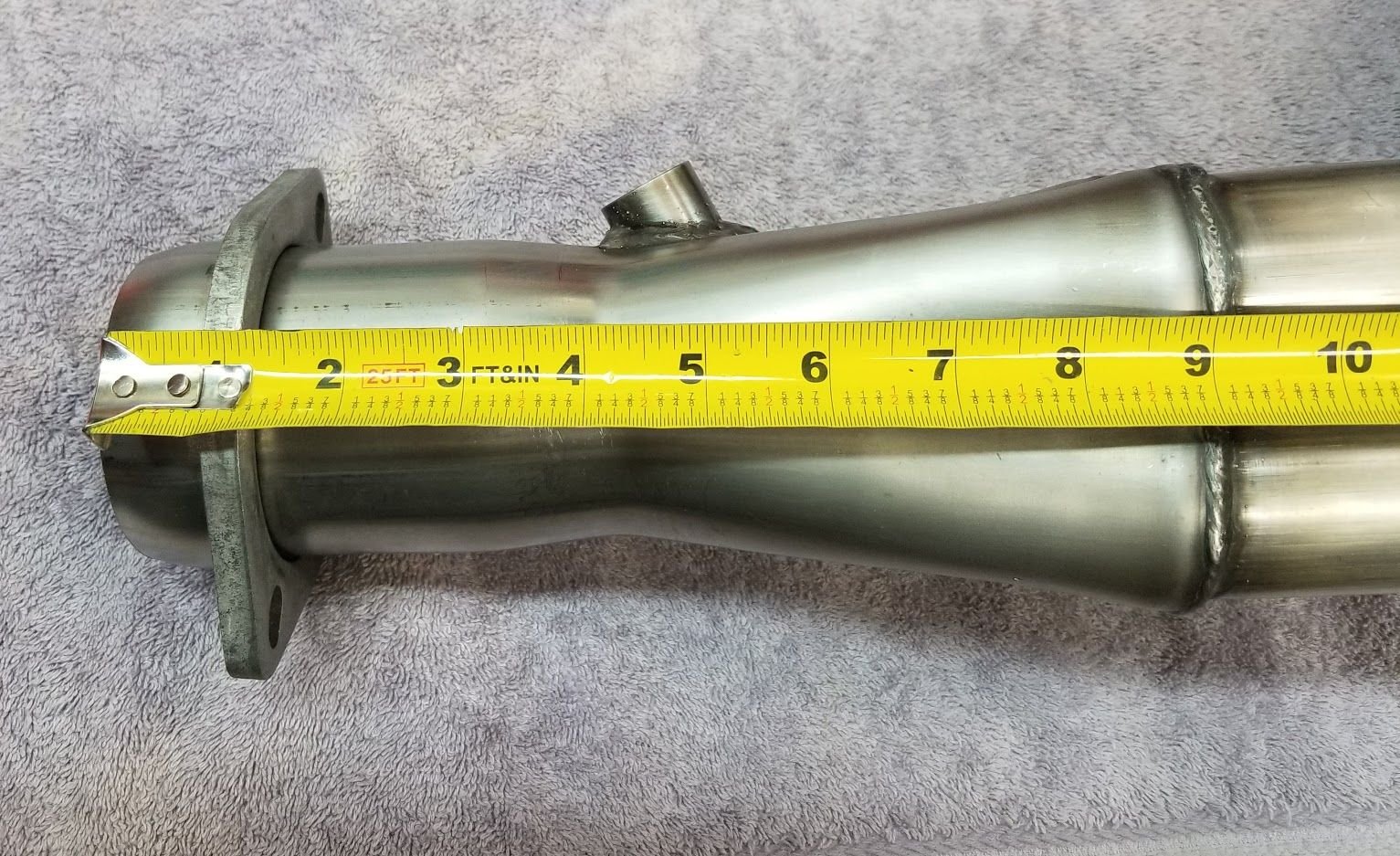

Then the 9" collector. There's a lot of metal with any header system, but the catted x-pipe was heavier than the header, ha...

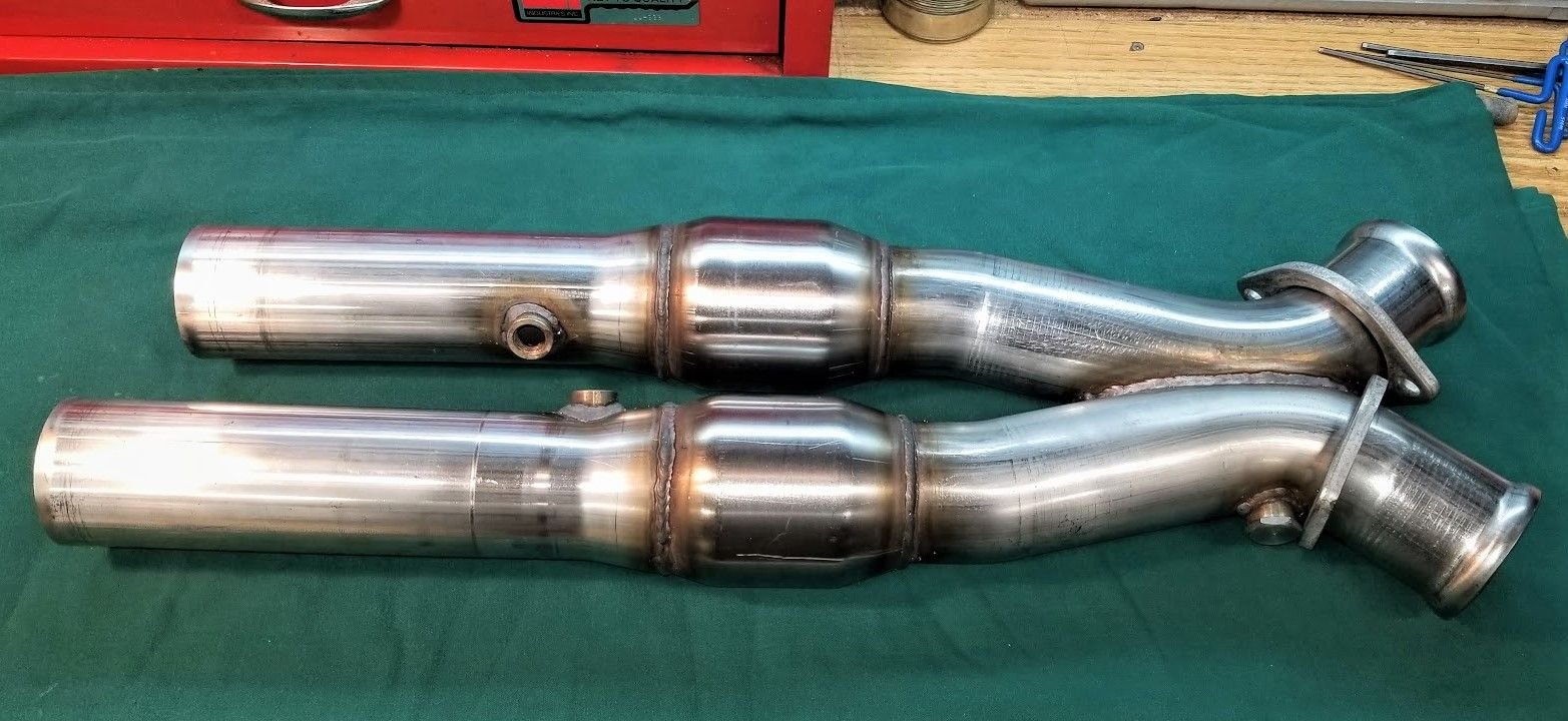

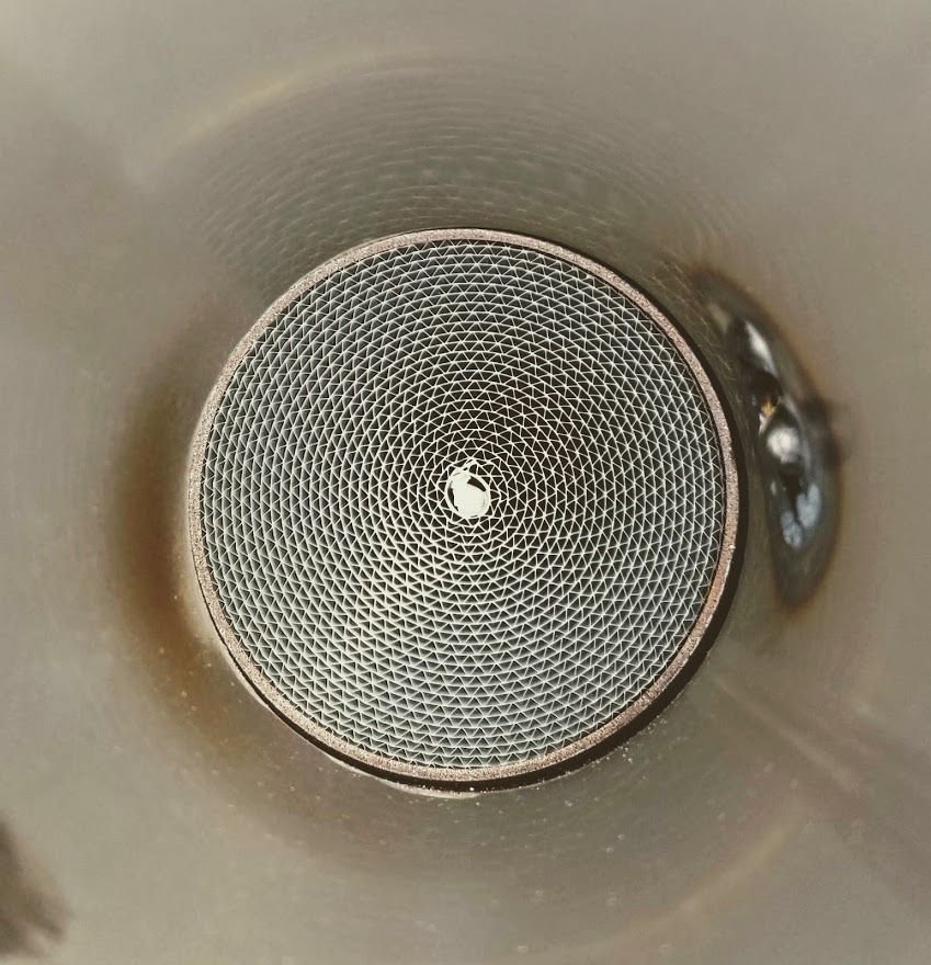

Catted x-pipe before I installed the O2 sensor plugs. Short Cats... they must work.

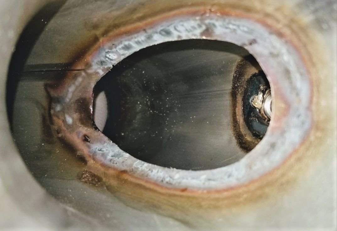

Left x-pipe; merge hole. The Catts in the back-ground.
Right side with merge hole.
There's an ARH Cat. The weld blob is for the O2 bung. The Cats are shorty-short! Makes one wonder how they can do much, but as long as they eliminate that gassy exhaust smell, that's all I care about. Plus, my Stainless Exh Tips stay clean, and not black like a chimney.

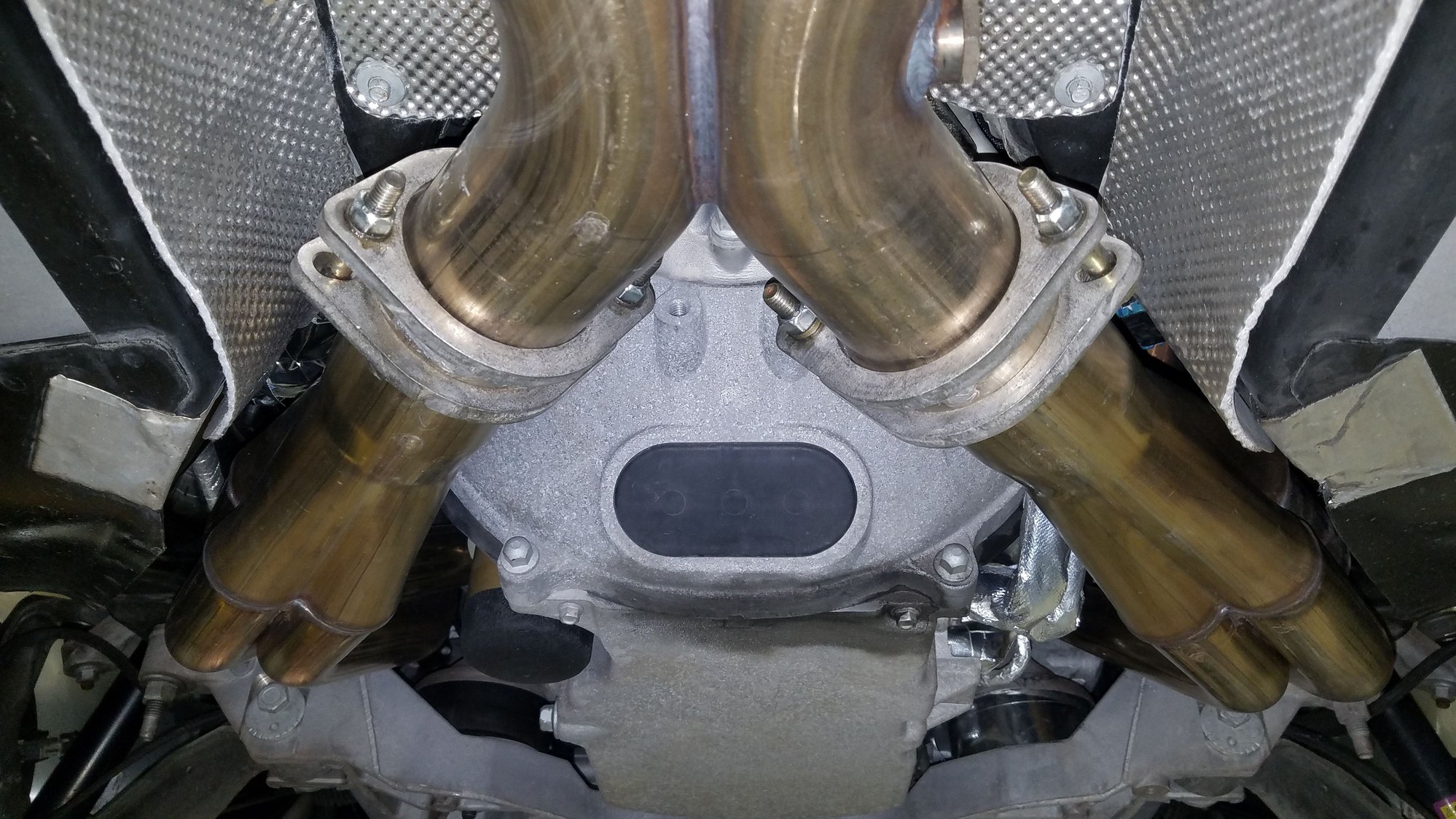

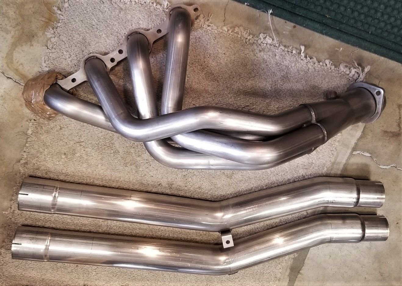

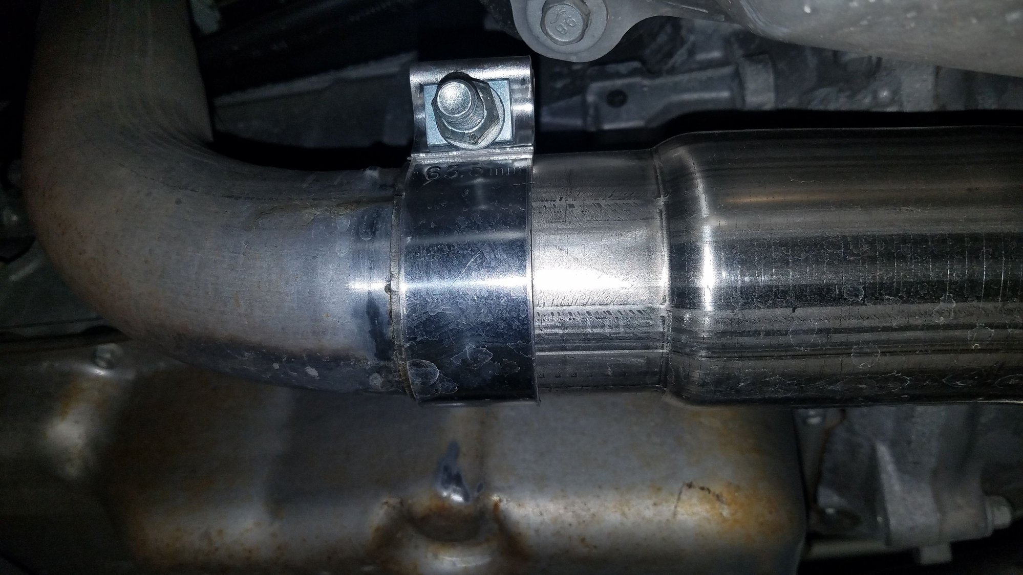

ARH 1 7/8"
I wound up plugging the REAR O2 Sensor Bungs
3" X Pipe necking DOWN to Fit 2 1/2" over the axle Grand Sport Tailpipe's

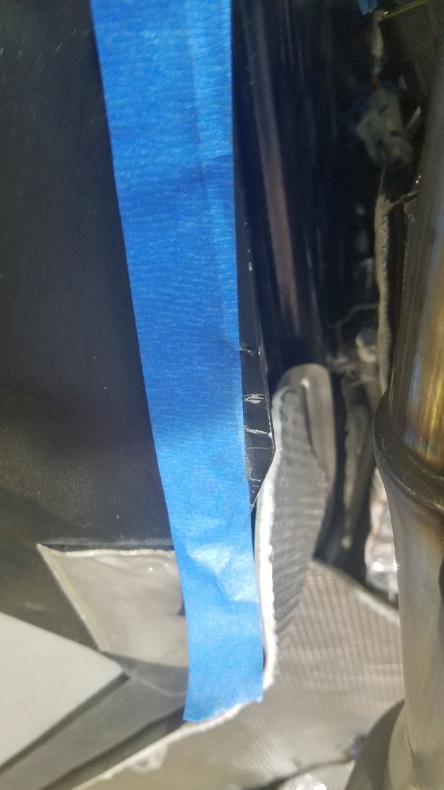

Blue Tape MArking where I trimmed/cut the frame to clear outer most right side tube.....
