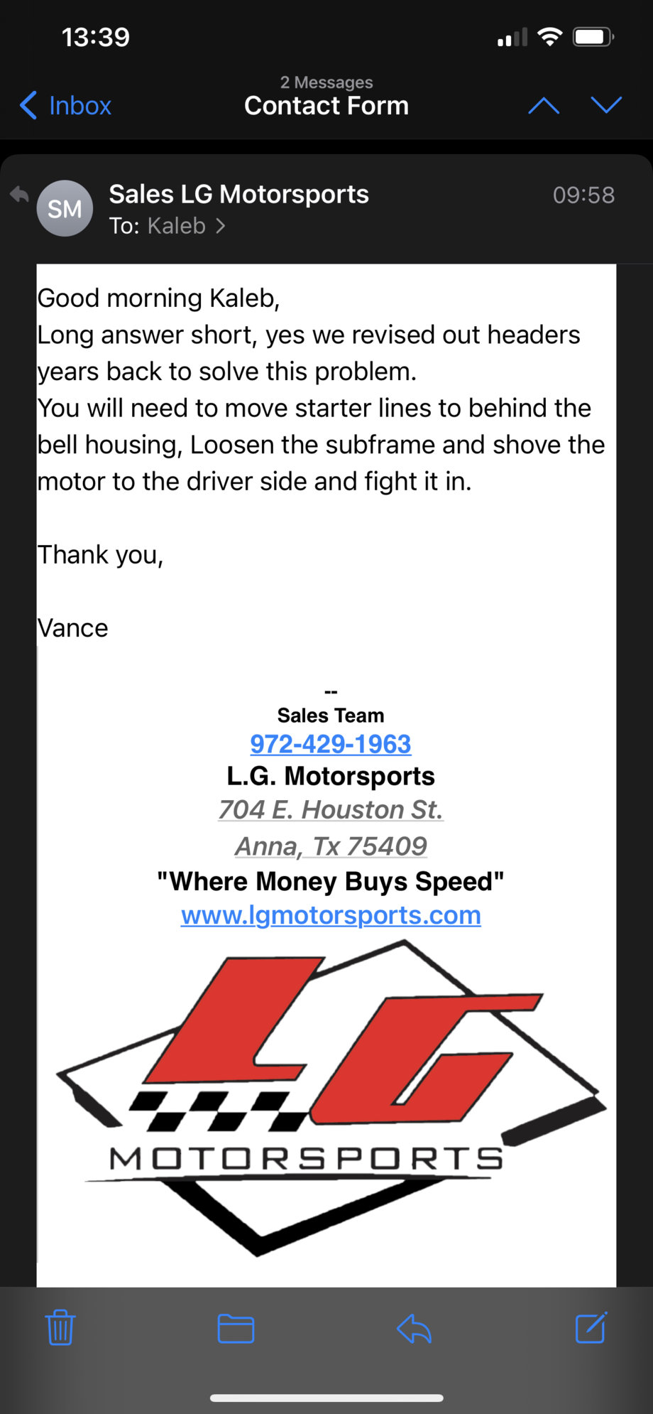

I had LG heads and Cam and still
had a dropped valve and the headers won’t fit and this is their response lmao
