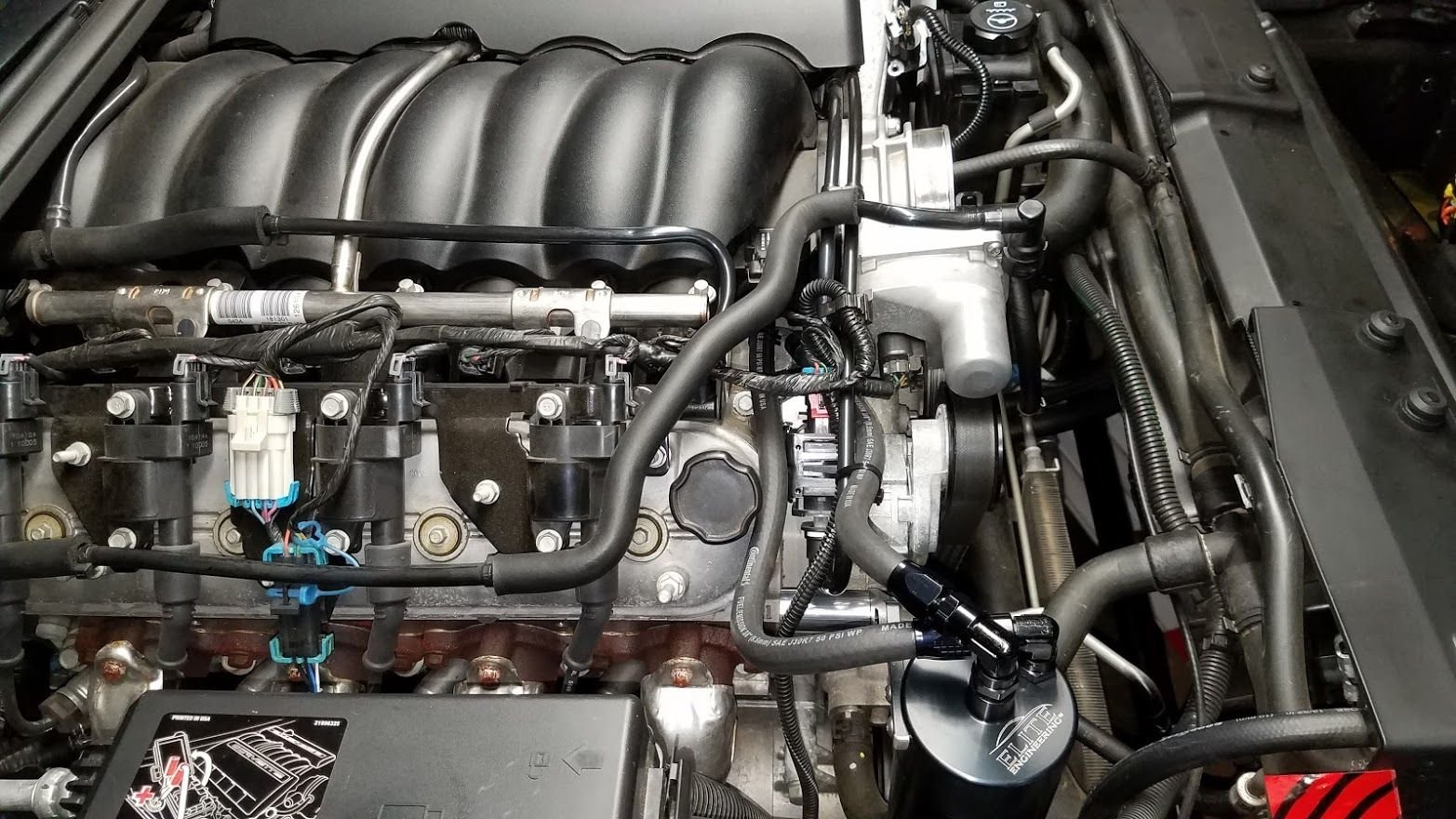

I've a 2010 GS M6 with the Dry Sump - awesome car. I installed a Catch Can soon after purchasing the car. The car only had 13,000 miles on it, BUT I'd read so much about the oil blowing thru the PCV system and coating the inside of the intake with oil, well I just had to take a look for myself. So within days of getting the car I pulled the TB, shined a light in there, HOLY CRAP every surface was wet and shiny AND I had a small puddle in the middle. That was THAT! I got a lint-free rag in there and sopped it all up, and got myself a nice Catch Can (Elite Engineering).
I simply installed it the same way as a wet sump, as the Tech I spoke with said dry sump or wet, makes no difference. Like you, I could not find any definitive warning or caution that Catch Cans on the Dry Sump must be mounted &/or hoses routed differently. See the pics after the install. I have seen plenty of pics of them mounted back by the Sump, but most of those were on race cars, and had every breather vent hose stuck in there. Mega overkill for the average non-supercharged Vette. I do not know, but I don't believe the ZR1 has a different PCV system than our NA LS3... but I could be wrong.
To date I have put about 2,000 miles on the Vette, and emptied it twice.... well empty isn't the correct word. After 1,000 miles I found I had perhaps a Tablespoon of oil, same at 2,000 as well. At 2,000 I took the TB off and shined the light in there; the inside had no shine, but I did get just a slight film on my finger smearing around in there (a lot).
Hope this helped. Now go enjoy your awesome Vette brother!

Correct. I thought I'd go the extra mile and bought the ZR1 setup (dual can) from Elite Engineering for my '10 GS 6M (dry-sump), and the can that runs into the intake always collects oil (same can as the wet-sump / single can install), and one stays dry.
Elite Engineering is my preference, but I also hear great things about Mighty Mouse.
Hope this helps.

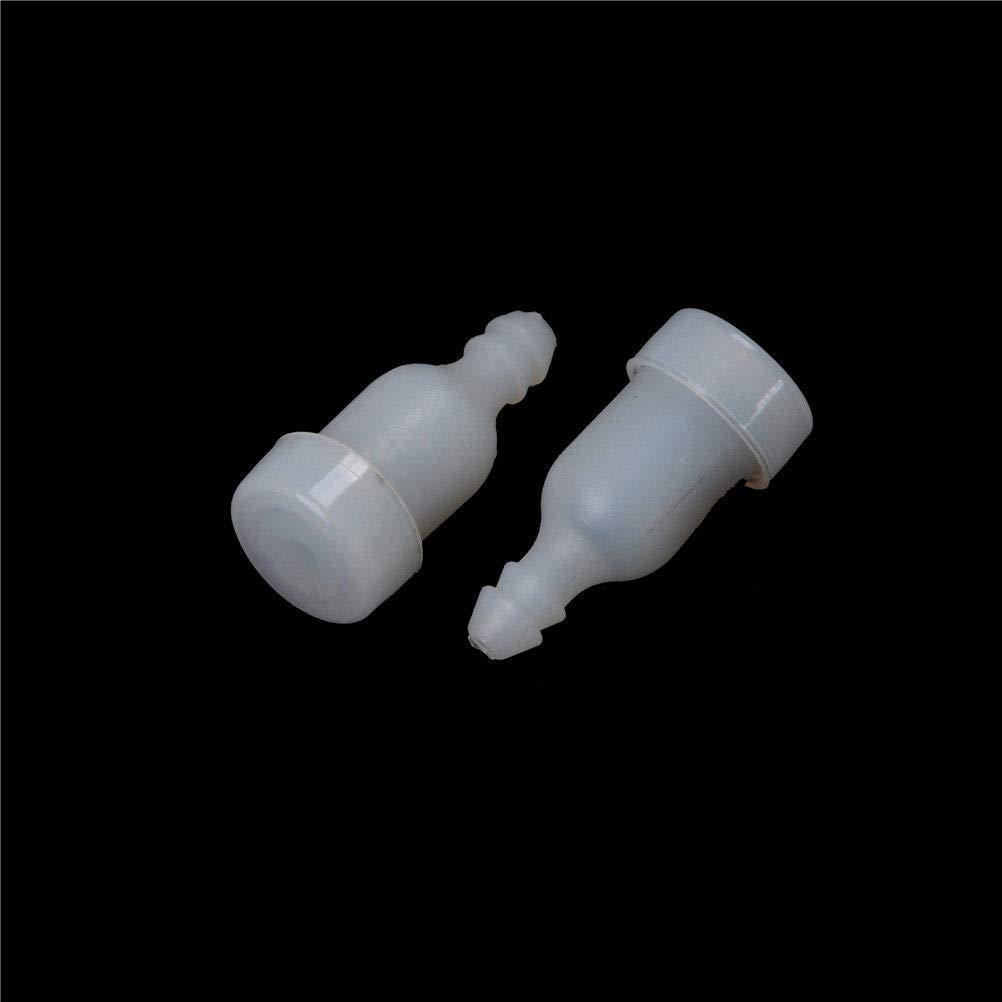

The fuel tank vent breather with check valve does not need to be fancy, and even something like the below would be fine.
Simply check valve in it keeps the line from back drawing any air into the tank,and the filter in it is enough to catch any oils so they are not blow up and out of it.
So out of OEM tank vent with hose, loop behind the tank and mount the gas filter with check valve with it outlet side upwards behind the back of the tank (out of site, out of mind, and a slight slop from the tank breather with check vavle downwards back to the tank).
Hence if the tank does need a secondary line to vent under boost, it will be pushed up and out of the breather (check valve has enough back pressure that the separator cap will be doing most of the venting, and just there if if the boost blow by get strong enough that it needs a secondary line to vent, and what oil that is trapped by the filter, will back flow back down to the vent in the tank when not venting isntead.
