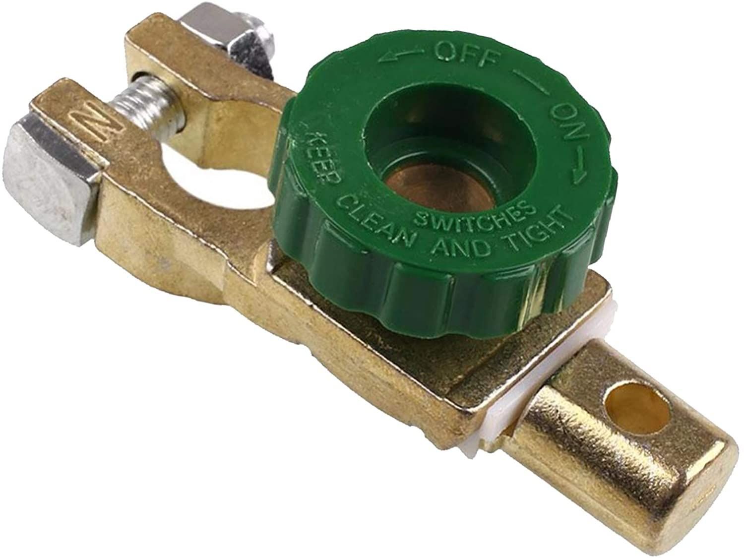

If you decide to disconnect the battery use this part, find it any parts store carry them.
Amazon Amazon
