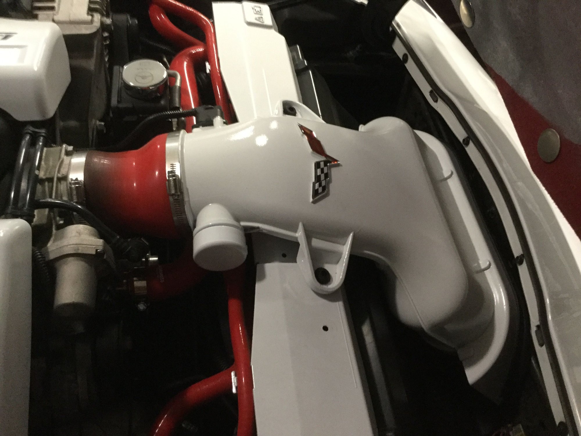

I bought a stock Z06 air intake and replaced my LS3 air intake. Noticed no difference. I did it just to get that ugly suitcase out of my engine compartment

Yours appears to be stock LS3.........Is there a visible difference between the LS3 & LS7 intake. (Are they the same?). How much was the part? I'd like to do the same but I guess it will screw up the tune that Redline did .

Won’t mess up your tune. I bought mine on the classifieds here. $75

I could just cut off & seal the resonator tube.
Lots of C6 owners have already done this. $5 in supplies from the plastic plumbing section of your local hardware store and you've good to go.
I also considered trying to just make a patch out of JB Weld, but ended up finding a used CAI for cheap I stead.
