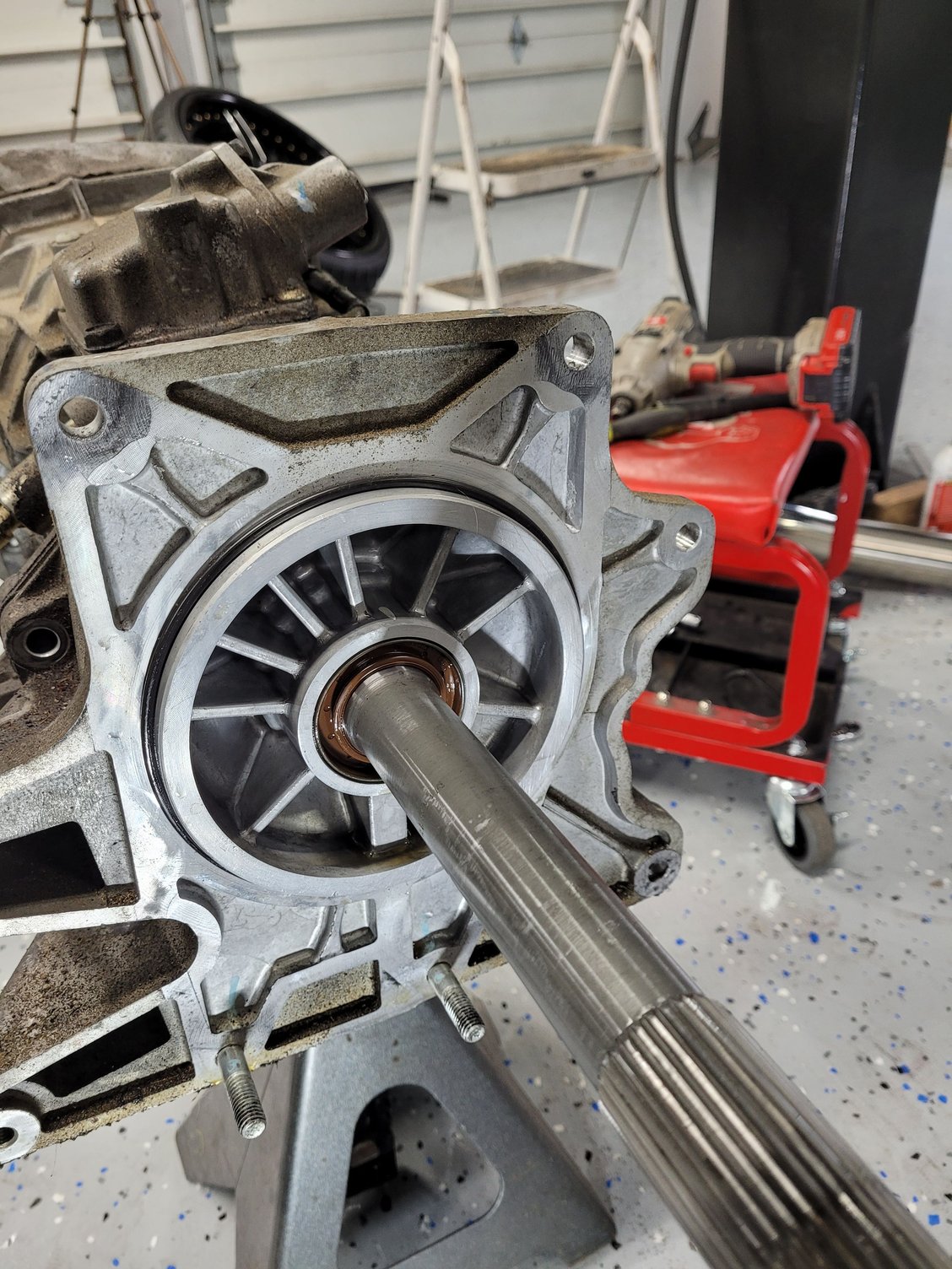

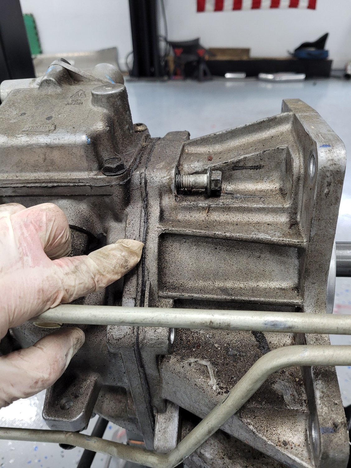

About to install my Fore fuel system and while I was under the car I noticed a drip of tranny fluid. The grime tells me its probably been leaking for a while. I decided niow would be a good time to fix since having the rear cradle out of the way would make dropping the fuel tanks 10x easier, so I removed the entire rear assembly.
Pretty sure it was just leaking at the RTV seal here, so I plan to clean and re-seal with black RTV unless anyone has a better suggestion.
Should I also replace the output shaft seal? (Brown one shown below) and the o-ring between diff and transmission? It doesnt appear either were leaking, but while im here..... Does the output shaft seal just press in/out, or will i need special tools? Anhy other tips while i'm here? Thanks!

Also does anyone have torque specs for this job? Tailshaft housing to trans, and trans to diff?

I think 37 foot pounds trans to differential I would say the same for the trans housing
