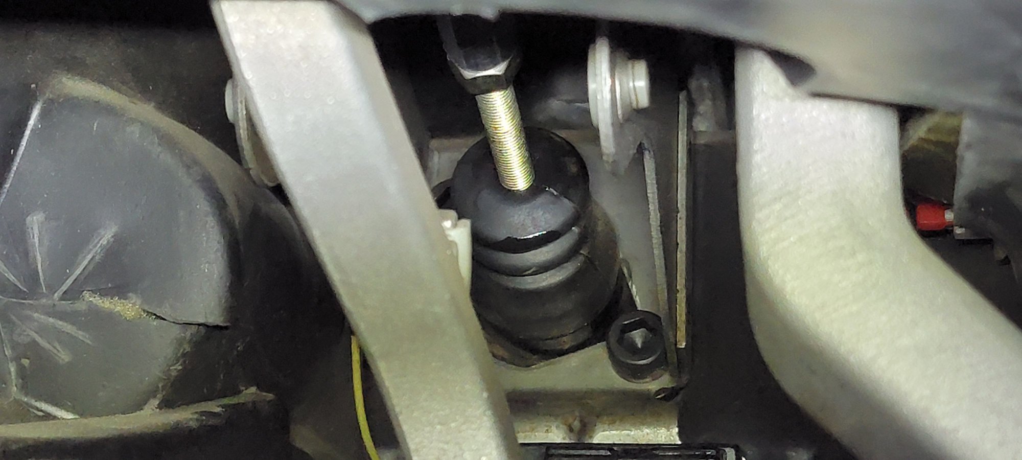

Was looking it over and turns out there's a small leak from where the shaft enters the master inside the car.

The master cylinder is just a Tilton that Tick adds the extra parts onto so it will work in the C6.
Rebuild kit for it is like $10 from Tilton, or you can just see if tick will replace it instead.
But yes, would resolve the problem if the master is leaking.

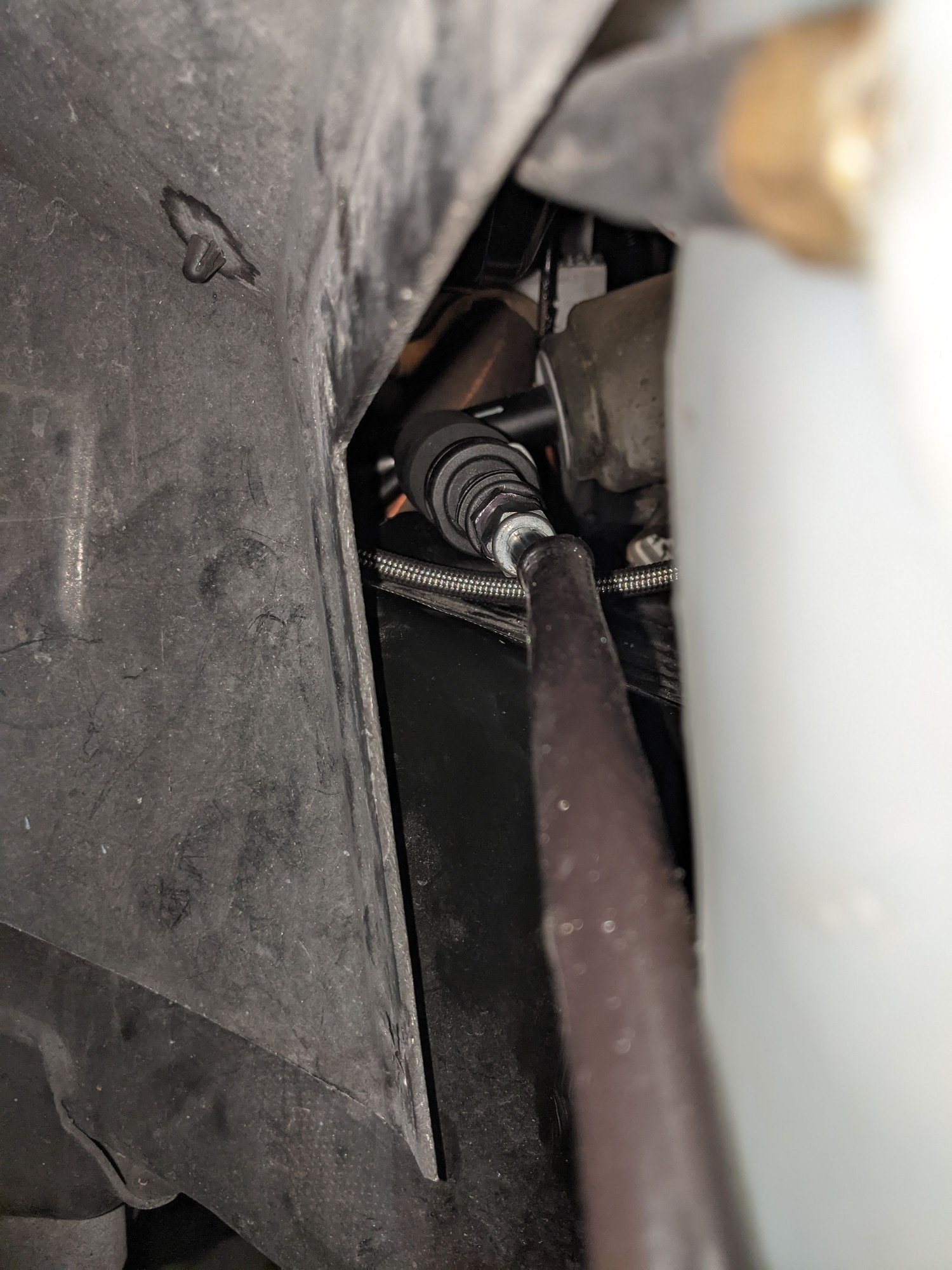

that was a bioootch... But got it out. So they want me to release that clip to disconnect the end of the line where it snaps onto the slave connection. That way air only really gets in the new master and you can just bleed the master separate from the slave, then reconnect. But that last pic is as far as I can get the line towards the wheel well. My fear is that I will get that clip off but never be able to see or get the angle to get the connector and clip back on.
If I just disconnect where the blue connector is, swap the blue fitting onto the new master, then reconnect there, I'll have to bleed air through the entire system. I do have the tick remote bleeder with the check valve. Will that help bleed the air out faster I wonder? Or will it still take forever... I may not have a choice honestly...
What do you think?
What do you think?
Nice work
I did the blue fitting and 2 person bled for about 45 min

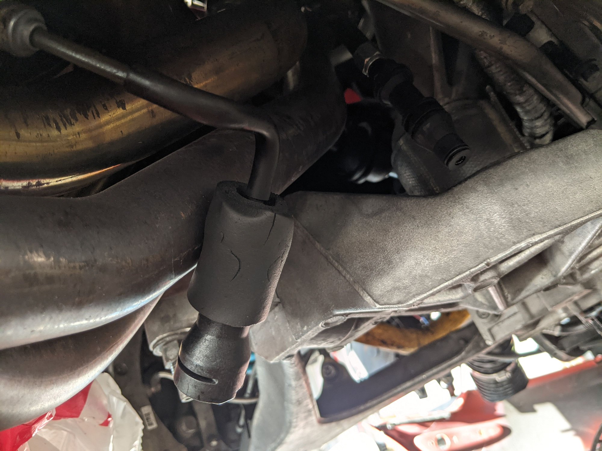

This tick master has such a long line going to the slave... I was able to feed it back to the center of the engine bay. The car's high enough on jack stands right now that I was able to get under the car and have plenty of room to disconnect it easily. This will make bleeding the system much easier.
