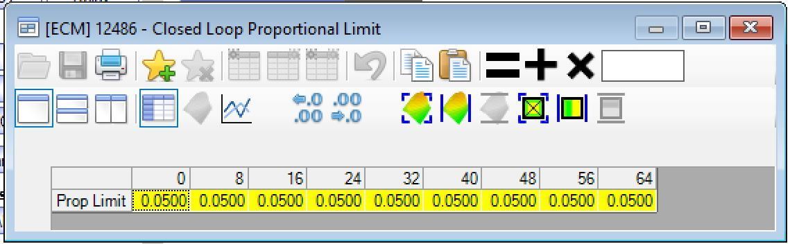

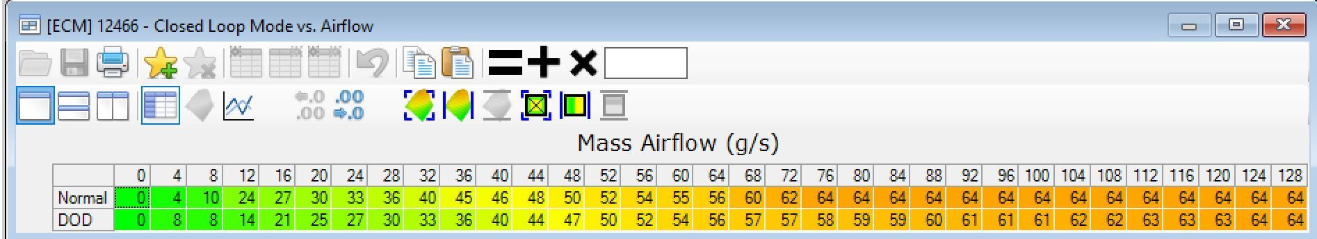

These are the relevant tables, found in my tune under Engine/Fuel/Oxygen Sensors.
If you look at the shared tunes on HP Tuners, there are a *lot* of tunes with these changes in them. I think this is a common fix for surging caused by the location of O2 sensors further downstream from the engine when long tubes are installed. Every tune I've seen has the *same* numbers in the 'proportional vs. mode' table and the 'limits' table. I think you will be very very close just dropping those numbers right into your tune. This seems to be the magic recipe for a lot of people.

Ok, good to know. I just took a look at my tune. The first 2 tables you posted are the same as mine was stock, which was unchanged. The 3rd table was all 2.00 stock, it's currently 1.75. But I don't know what that means, and it seems to be running fine, so maybe it's best I just leave it alone

I started with the tune that GM put in my GMPP controller, which was intended for the LS376/480 that I bought. The first two tables were a lot different than what I showed above. The third table was all 2.00.
However, the third table has the least effect. My understanding is that it limits how much the PCM is allowed to move the air fuel ratio around in the various modes... and modes essentially convert to airflow due to the first table. But my experience is that if the first two tables are right, the third doesn't matter as much, I've tried values from .05 to 2.00 with no noticeable difference in behavior.
