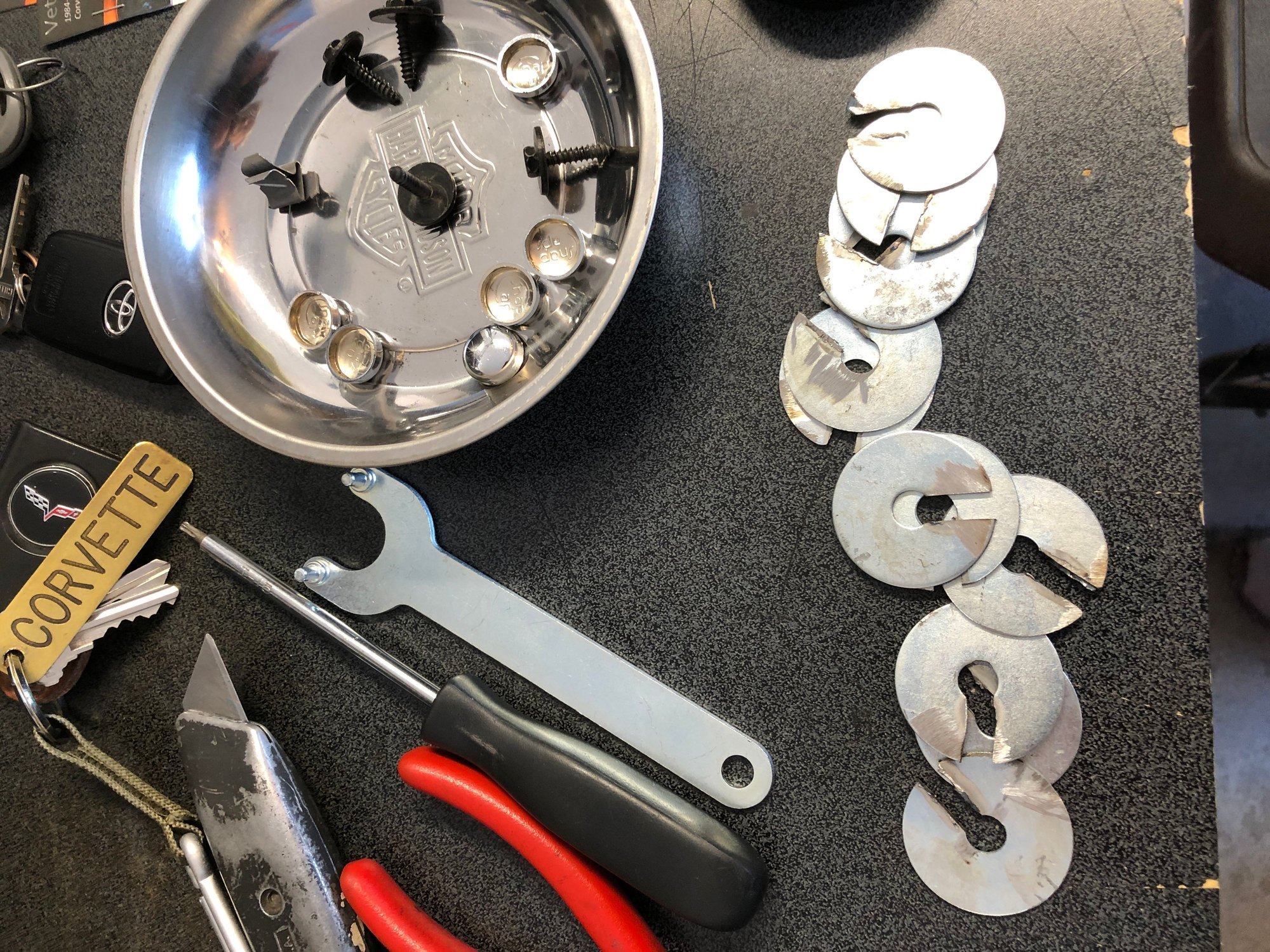

This can easily be done without bumper and fender removal. Taking my time I did this job in about two hours, this included using fender washers as shims to adjust headlights into position so no gaps were present.
I helped a forum member install his that needed no shims and that job went much quicker.
So I guess it just depends on wether you need shims or not. I used a cutting wheel to put a slot in fender washers so I could easily slide them under headlight studs to adjust into position.
If you have any other questions just ask, there are plenty on the forum who have done this themselves. 600 bucks sound twice the going rate I've seen others get it done for.

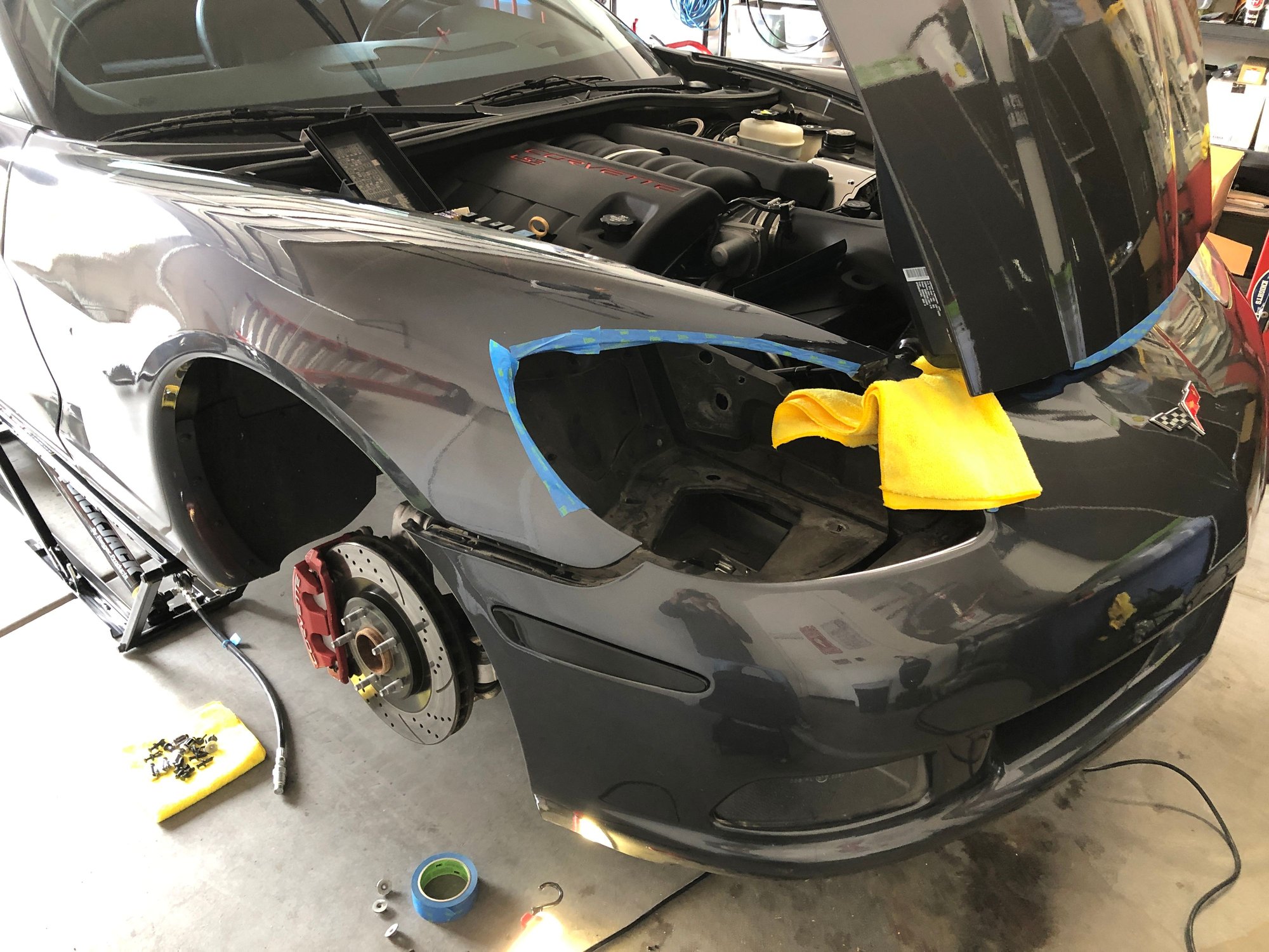

Will admit it took 4 hands to do this in my account. Found that removing the rubber cover for bulb replacement. Gave better purchase to place and hold the light till tightened up.
Did raise hood and marked fender location with painters tape. easy to put back to proper location.
Done on Jack stands with no body panels removed. Understand to remove the clip (fender to bumper)
Its the bumper you are unclipping from the fender (( there is one fender screw under this area ))

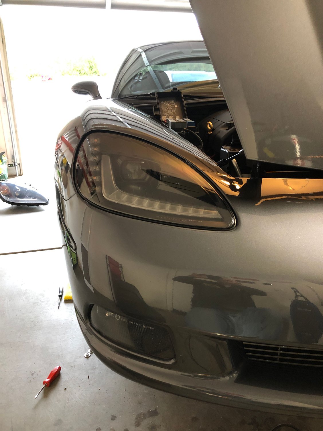

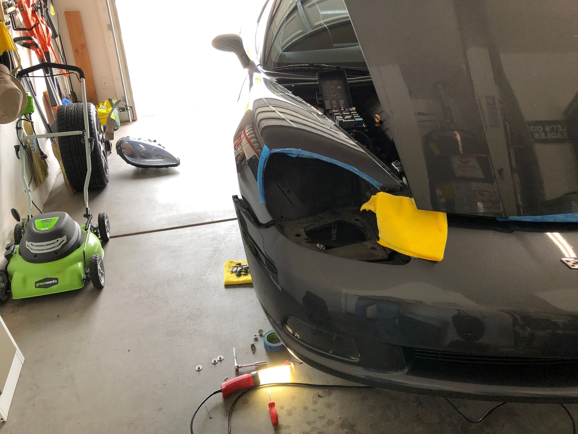

Not sure if these photos help, it’s all I got that I can find.

I can’t recall if I had to install fender washers on all three studs or just a few of them. Each car is different as in when I did a friends install in his vette, they bolted right in with no shims needed.? Here is a photo of my home made shims. Worked great to fill in the voids around headlights.
