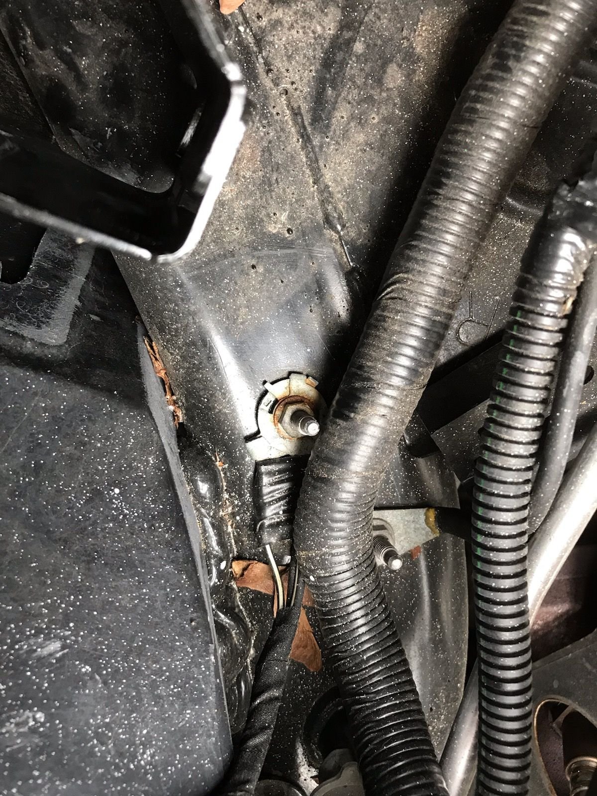

So - an update on my problem. I spent a couple of hours this afternoon doing some work on the Vette. I started by pulling the battery out. I could NOT see where the Battery ground went, I tried to remove the underhood fusebox, and that did not go well either. I did remove and clean three frame grounds on the Pass side part of the frame. All were nice and tight - one was a touch sketchy (see image below) but the other two seemed fine. I also pulled the two major multi-pin connectors by the battery apart (one came apart pretty easily - the other one really didn't want to separate - but finally succumbed). Everything looked nice in there - so I just put them back together. The battery terminals looked fine, but since everything was apart - I cleaned them again, and reinstalled the battery.
I got in the car - put my foot on the brake pedal and hit the start button. Nothing - than about 4- 5 sec later - she cranked and started. The dashboard light show was just like it was before - but about second or two after it lit up - something "reset", and, all the lights and DIC warning messages went out !!!
I don't know if it's fixed or not - I let it run for 15 minutes and did an quick oil change. (I couldn't drive it as there was another "problematic" car right behind it). Tomorrow is supposed to be a washout - so I probably won't get a chance to do much till sometime next week - but I'm hopeful.
I'll keep updating - but progress is being made....
Only negative is that after disconnecting the battery - I tried to reindex the windows, and when I get out of the car the window does it's normal "drop" thing - but doesn't go back up when I close the door. I tried several times (3 consecutive down / up cycles), and it just doesn't want to go back up after the door is closed.

Just a quick update. We have both Good & Bad news ...
The Good news is that holding the window switch in the up position for 15 sec DID convince the "system" to re-index the window, and it fully closed after the door was shut.
The bad news is that today - when I went to start the car - it took multiple pushes of the start button to finally convince it to crank, and when it did crank it - I had the check engine light back on. A short drive showed that the trans was again "locked" in a gear (probably 4th) and completely ignored the paddle shifters. I took it around the block and pulled the codes afterwards - and got the U0100 (Communication Error) & P0700 (Trans Control Module).
Looks like a new TCM is probably in my future...
