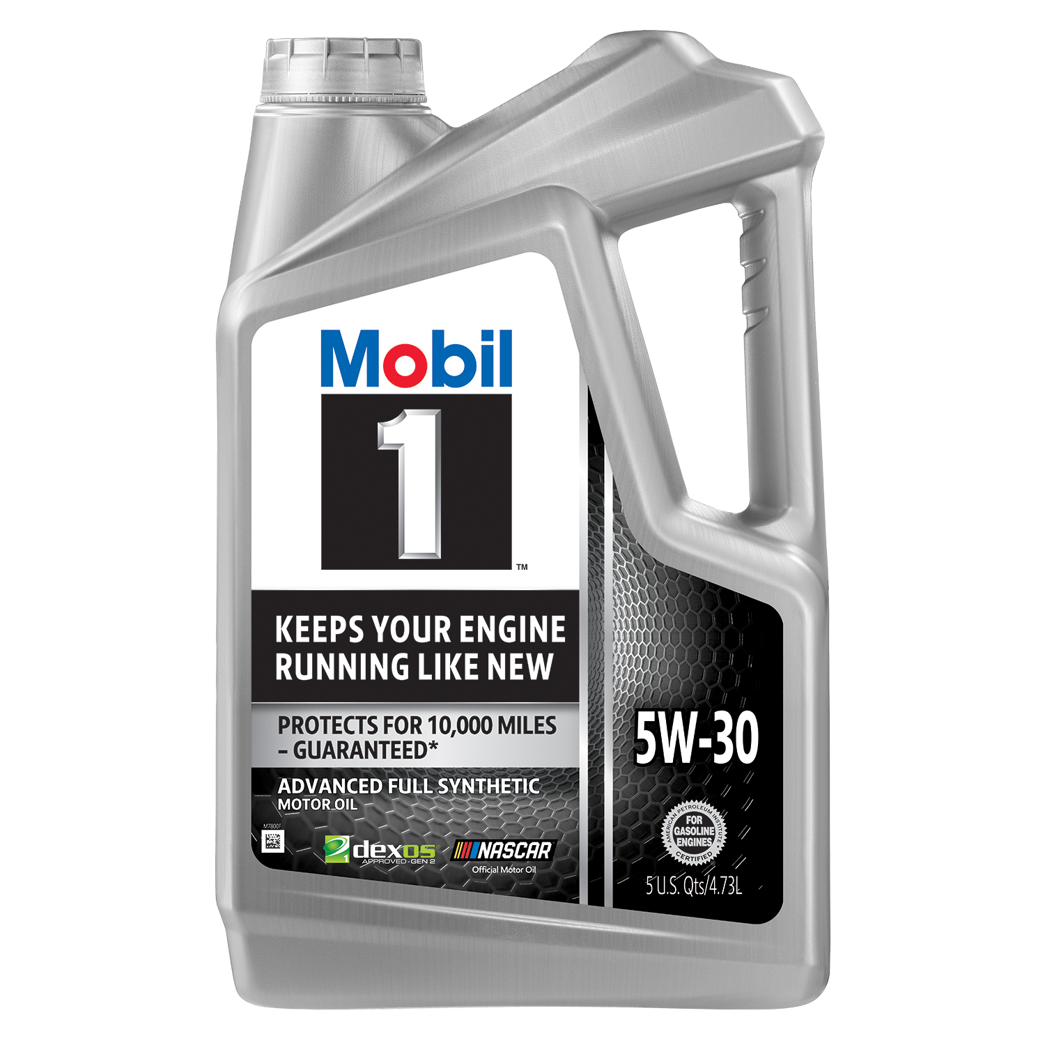

The additives in the oil will have broken down at the 10K mark (what Mobile warranties the oil for), and the amount of fouling in the oil will be even worse. So your talking more engine wear due to the over fouled oil, and even to the point that you start to sludge/oil bake fouling build up in the engine too.

Simply, Just keep your eye on Walmart sales, and when they do specials on the 5 qt jugs of Mobil 1 for around $15, stock up to cover your for a few changes.
