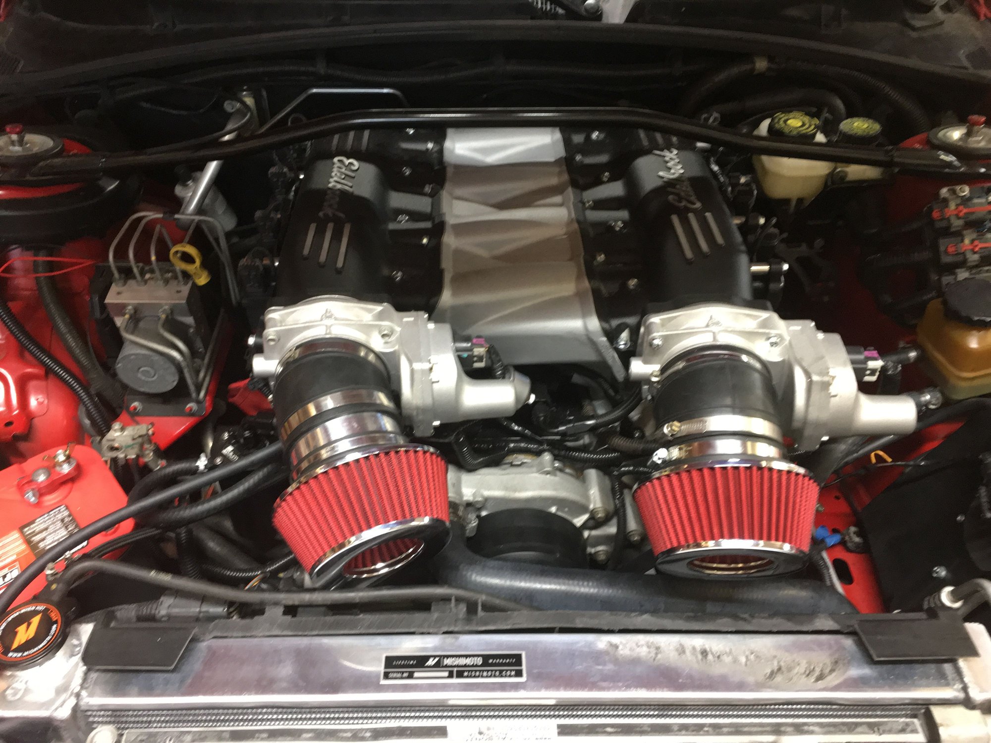

Originally Posted by Turbo6TA
You know you will need an LS3 intake manifold ... The LS2 manifold won't fit LS3 heads (different intake ports)
here is a ls3 manifold for you.
