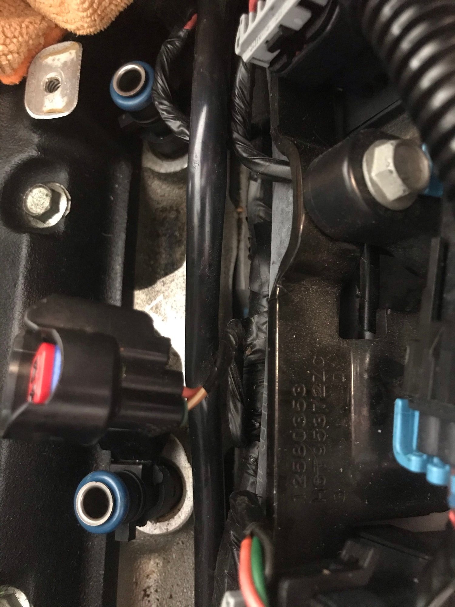

I have a 2011 GS.
I am trying to pull the injectors to get them cleaned.
I have removed everything and the only thing left to do is pull them out. However they do not like that idea. How do I safely pull them?
please see picture below.
thanks in advance for any help!

Since you have the fuel rail off ... just grab the injector and pull straight out. You won't hurt anything.
Make sure when you re-install, you put a little grease on the O-rings so they don't bind.

I can’t just pull them out. They are in their!

did you twist them back and forth? you may need to wiggle a little bit while tugging gently..... they come out the same way they went in... slip fit...
