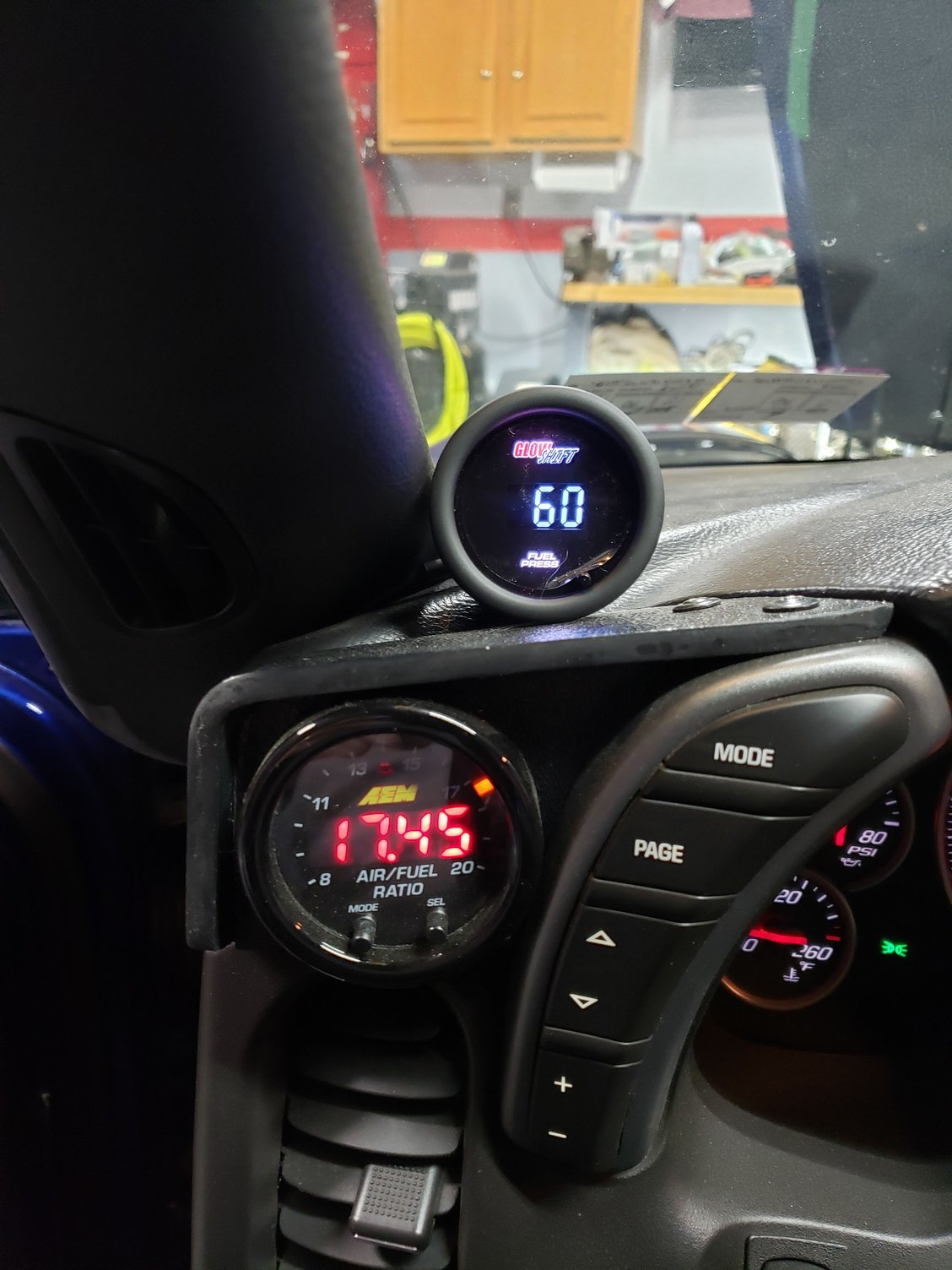

So i was on my way to work today. My AFR went from 14.8 (ish) on average when cruising/idle to 17.5-18.0 .... No changes made other than I just got on it a little bit and did a mild pull from 60 to 100... not even real aggressive. I've put about 30 miles on it since winter hibernation. seems to run the smae without issues..... just concerned with the sudden jump after a year
it's a 2006 base, A&A supercharger, long tubes no cats, AEM wideband , BAP on hobbs
I'm going to do a scan and log when I get home, but looking for some input from the forum to help look in the right direction.
could it be wideband sensor starting to fail?
maybe something to do with a vacuum line?

Old Apr 15, 2021 | 09:27 PM
hmmmm16417's Avatar
hmmmm16417
Joined: Apr 2013
Posts: 1,501
Likes: 185
From: Erie PA
Today i had some time to tinker. I cleaned the MAF sensor, used the maf cleaner on O2 sensors ( ot sure if that did anything) , performed a free air calibration of the wideband. (AEM) , and installedfuel pressuregauge - conformed fuel psi @ 60
still idle at 17 ish for afr
guess I need to start checking vacuum and exhaust leaks and do some data logging?
hesitate slightly when stepping on gas, but still runs good under load

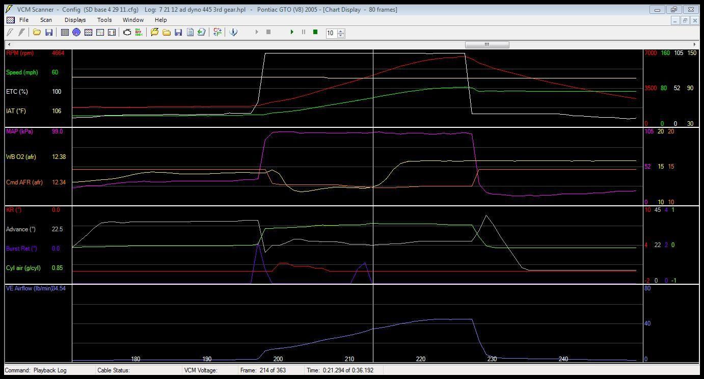

Here's my suggestion:
Either let the car idle in the driveway or take the car out for a spin, perhaps using cruise control, no need to boost it or get in to PE. I would log the narrowband O2 voltages, duty cycles and log the wideband until after I have recorded the lean condition. Then I would examine the log to determine if there were any significant value changes as the log transitions to the lean condition. If there are not significant changes in the narrowband voltages or duty cycle values, then I would suspect a faulty wideband system, my guess would be the sensor.
Old Apr 17, 2021 | 09:13 AM
vague's Avatar
vague
Joined: Jan 2008
Posts: 85
Here's a pic of a log with the sensor going bad. Note near the cursor, the Cmd (afr) and the WB O2 (afr) start to diverge. As I recall the sensor false readings were intermittent at first.
To AFR too lean
What model is your AEM?
Time to look or start pricing a new wideband O2 sensor.
Thanks, Matt
Old Apr 17, 2021 | 11:00 AM
vague's Avatar
vague
Joined: Jan 2008
Posts: 85
Not an AEM... a NGK Powerdex AFX. It may be discontinued, I purchased it over a decade ago.
